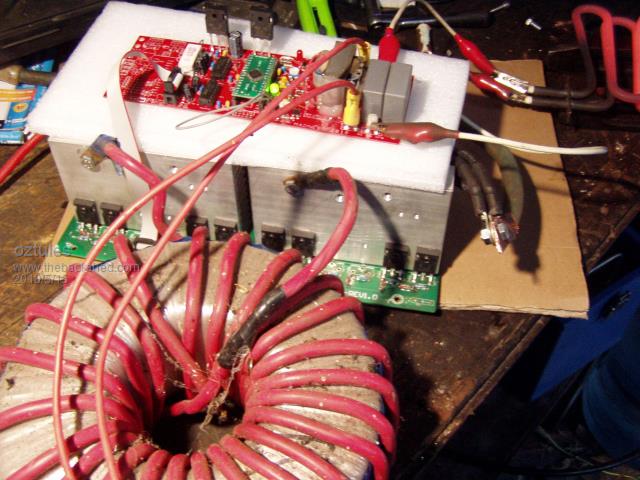

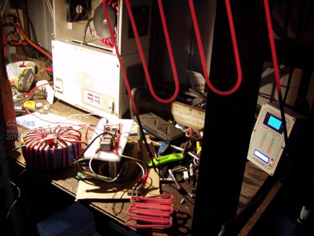

Ok, got home at 4.30, and decided to run the boards from last night.
Dusted off the old single tranny, and we got this:
Unit sounded happy too.
close up just because I like it....

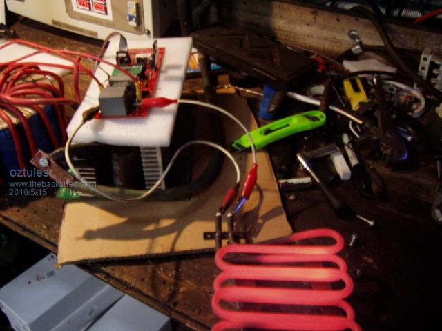

Now we put some more load on.... stop and start under load... no problems either..
This is just a pic to show the setup.

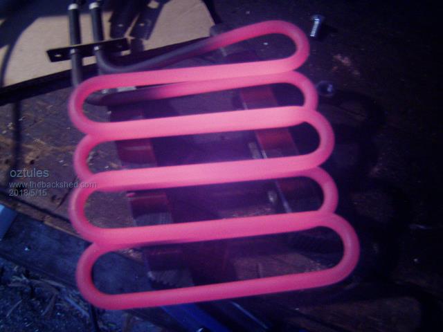

Here we are with 4-5kw.... still no problems, in fact inverter near silent now.
Both elements running
So it is a nice unit, and have no drama's. It stops and starts under 5kw of load, just seems very stable.
all good.
..........oztules

Yes, this was driving a clockman power board, with NO inductor.
So there were no totems to save the day, and it still worked flawlessly. The tranny was under done, the inductor was not present, it still worked perfectly well, with no noises, and very small heating. Even 5kw did not cause the heat sinks any bother after 10 mins or so.
So, If folks are having troubles, don't blame the inductor, or the totems or lack thereof... youve screwed something up.... maybe the 8010 soldering etc... folded pins on the drivers, or something else that is silly.... but kills the fun.
The bigger drivers are fine, but they seem to make no major difference. I haven't tried the 22kw test tonight, but will in the morning... too damn cold now.

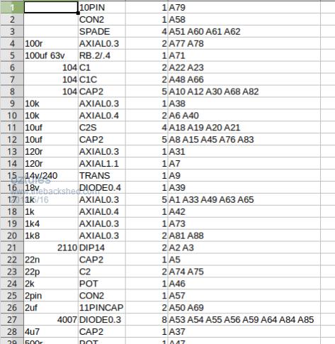

Madness, I have not started ordering any parts, but i have been working on a clean parts list that i started when i got Clockmans boards, it still needs a lot of work on standardising the part numbers with both the Ozinverter and the Madinverter.
Feel free to comment and recommend changes additions etc.
I have just wipped through this thread and added your parts lists in.
Yellow areas have formulas in them!
Let me know what you think!
2018-05-15_213118_OGI_Parts_v2.zip
Also the boards arrived!!! THANKYOU!!Edited by Mulver 2018-05-16

That is an impressive Spreadsheet Mulver, will make it much easier for people to do their parts ordering with all the links there.
I have not looked really thoroughly at it but a couple things, on the control board
2 X 5V6 Zeners
13V Zener is now 18V.
2 X 40 Pin socket instead of 1
1 X bottle Electronic smoke with an insertion tool.
All the Resistors on the Control Board are 0.25W buying a mixed bag of them will get most of them in one go and may work out cheaper.
Thank you for your contribution, must have taken a lot of hours to put that together.

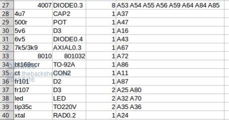

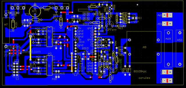

Posted: 10:28pm 15 May 2018
Ok mulver, as you know I'm not big on documentation... but I have cleaned up the pcb, so that it has output a BOM and made the screen shot show only the designation numbers.
This should give a succinct overview of both mads and my boards, except for the nano addition.
Clockmans board is basically the same, so it is fairly generic.
So here it is with designates only
Here is the generated bill of materials.. top half
and bottom half. There are only 40 components on the control card.... very low count for such a powerful device.
Ok we I have built 2 of them in a few hours, both work perfectly, so I can only say...
Build it carefully, watch your soldering, make sure the 8010 is properly soldered onto it's board. Check all the 32 pins from their post, back to the pin itself..... look for any dry joint there as well.
Beware of the driver pins folding up... it happens, and looks just the same...
Make sure your transformer ( VFB ) is sound. I had a dud the other night, but thats what you get with $1 tranny's. It is fine on the test power board with no caps, but deadly on the real thing.
STEP 2.
Do use 10-50amp circuit breakers when testing, then you will suffer no board damage, and very little other damage when you mess up.
Once you see a soft start on the scope, and a good sine wave, chances are your good to go full power.
You can see the results last night, where I just whipped the boards up, quick test, then 5kw.... so it is all true, they are plug and play, paint by numbers, but you still must take care on your first one to avoid disappointment.
Don't try and do it all in an hour... I have had a lot of practice, so I can.... but take it steady.
You can see from the rats nest on the bench, that layout and wires everywhere are not as important as they pretend it to be...... 5kw is nothing to be sneezed at, and the tranny was almost silent.... meaning there were no spurious wave forms in there... you can hear them clear as day if your messing up.
So if your having difficulty, it will probably be a simple glaring mistake, involving the 8010 or the drivers.
Try to keep the temp on the 8010 chip very temporary in nature.
The on/off switch is pretty robust, as I gave it a good testing last night.... it goes unstable when the signals are not there, but does not seem to blow itself up either.... but makes strange noises in the transformer like it is going to blow... but doesn't.
........oztules
