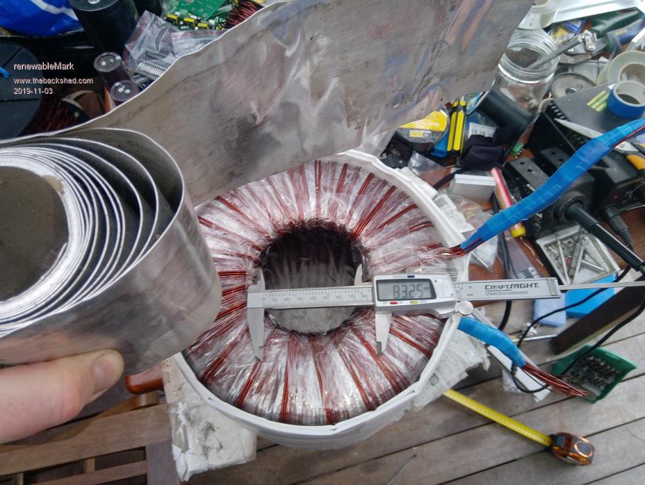

OK got the 14 windings of 25 turns all done for the primary.
Is it any use to put some aluminium between the layers of coreflute?
Also still stick with 2 sheets of coreflute?
Cheers Caveman Mark
Off grid eastern Melb
Posted: 09:38pm 02 Nov 2019
I really have no idea how important an electrostatic screen is for this. I asked for screens when my Warpverter transformeers were wound, but then it is dead easy to do with a E&I transformer.
Klaus fitted screens, not sure if Andrew did or not ?
If you are going to fit a screen, fit the screen right close over the primary with just some mylar tape for adequate insulation. No need for spacing that away from the primary.
The screen needs to be interrupted by having a break or slot right around the outside circumference, so that it cannot act as a shorted turn. Then bond a wire onto that.
Then fit two nice thick layers of coreflute over the screen, top, bottom, and around the outside (but not inside the hole).
An 80mm hole has an area of about 5,027 mm square.
Your four secondaries will be 4 x 128 turns x 2mm sq copper = 1,024 mm square of copper.
Usual rule of thumb, a "perfect" coil wound onto a rectangular bobbin with tight even layers and no insulation between layers can in practice reach about 60% fill factor of copper versus total available winding area.
You are not going to be able to reach anything like that on a toriod.
But the 20% fill factor you require to reach, should certainly be possible.

I don't have any copper foil and you can't solder aluminium.
What I was thinking was to do a big washer top and bottom and one around the outside. If they overlap a bit just the pressure from the windings that will go over the top should create some kind of a connection.
The centre is running out of workable room already, probably only kitchen foil is all that would fit in there sensibly.
Now that I just wrote all that down it sounds pretty dodgy and a bit like a waste of time.

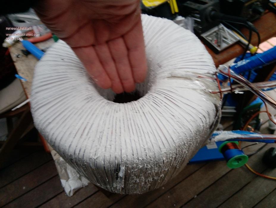

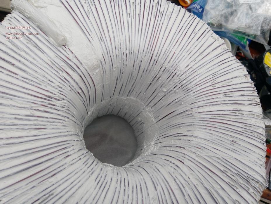

Posted: 07:56am 07 Nov 2019
Got the padding on top,bottom and sides of 2 layers of the coreflute 3mm.
It got the first winding of the 4 secondaries on.
It took up almost all the circumference in the core, so the next three will need to be sealed and mylared before finishing the layer as they will have to overlap.
I'm not going to fit all 128 turns in one layer with the next 3 secondaries.
So in short, this torroid is going to be the biggest pain in the ass torroid I have done so far.
The bobbins have had to be reduced to, so more solder joins on each wind.
With any luck it will make a big improvement, good thing is I have the Std version already done so a good comparison can be made between the two.
BTW the white stuff is polyurethane that sets like rubber, I use this rather than epoxy.

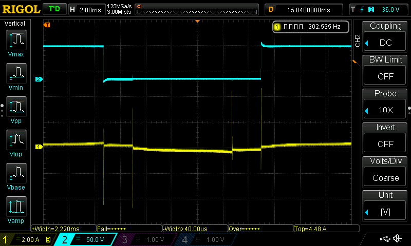

Posted: 11:38pm 07 Nov 2019
O/K I disconnected my Warpverter from its 100v battery and wheeled it over to my workbench, and connected it up to my rather small 60v dc bench power supply.
I then connected a 100 amp current transformer in series with the primary of the largest inverter.
Top blue trace is the voltage on one end of the primary.
Yellow trace is current, the spikes are definitely there but only around 4.5 amps.
There is no load on the inverter output, my power supply is too small.  The double spikes are the other side of the bridge switching, the blue voltage is only one side.
With 100v on the inverter these spikes would be about 7.5 amps, still pretty small.

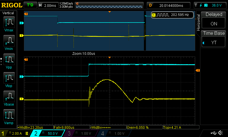

Here is one spike stretched out, it says 4.2 amps peak.

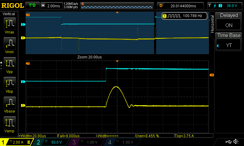

The same thing again, this time with an LA55P 75 amp rated Hall sensor. This has a different scale factor of 50mV per amp, but basically shows exactly the same thing.
So no problem here.  Andrew was measuring some 60 amp monster spikes.
Posted: 12:28am 08 Nov 2019
Just had a look at the number two transformer spike. Under the same conditions its about an amp and a half.

Posted: 03:36am 08 Nov 2019
In the first image, on the volts (blue) trace you can see the start of a capacitive spike with that little upturn on the leading edge.  By magnitude it is nothing like I got.
The bottom image, yellow trace shows beautifully the charging of the capacitance.

Posted: 05:45am 08 Nov 2019
I could turn the dc voltage up and down on my bench power supply, to only 60 volts max unfortunately, and the spike amplitude followed the voltage up and down in exact proportion as you would expect.  Proportionally at 100v, the spikes would have probably reached about 7.5 amps. That is not a lot.
It will draw that with only 750 watts of ac load on the inverter anyway.
A lower source impedance from the battery would have made no difference because the current for those spikes would all have all come from the three 12,000uF low esr electrolytics anyway.

Posted: 04:35am 09 Nov 2019
Started the second secondary.
I got to 114 turns and it was clear 128 wasn't going to fit in one layer without overlapping, so pulled up stumps.
Sealed it up, wait to dry, do the bottom, then mylar and finish the last windings to get to 128 turns.
Cheers Caveman Mark
