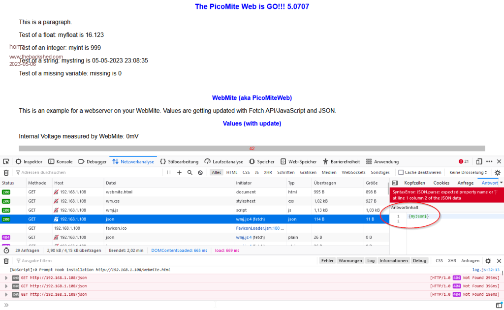

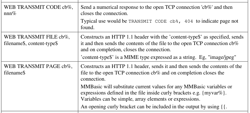

  matherp said  Can you not define a file with a single string parameter in curly brackets. Then you just need to set that variable to the string you want to send. Just one file needed and very little overhead.
Brilliant idea. So the variable is set in every type of file, not just the html files? I will try it tomorrow. Today I did not have the time ...
Hi Peter,
Unfortunately, your idea doesn't work. The variables in the file are only set with the WEB TRANSMIT PAGE command. However, the content-type$ cannot be specified there. With the WEB TRANSMIT FILE command, it's the other way round. No variables in the file, but the required content-type$ = "application/json" can be set for it!
The screenshot shows very clearly how the different content types can be loaded. CSS, JavaScript, but unfortunately the variable in the file "json.data" remains unfilled and the name "myJson$" appears in the response content (Antwortinhalt).
The simplest solution should be to be able to specify the desired content-type$ in the WEB TRANSMIT PAGE command and not to use the default for a website.
I would appreciate your help here!
Thanks again for the release of the WebMite version!
Matthias

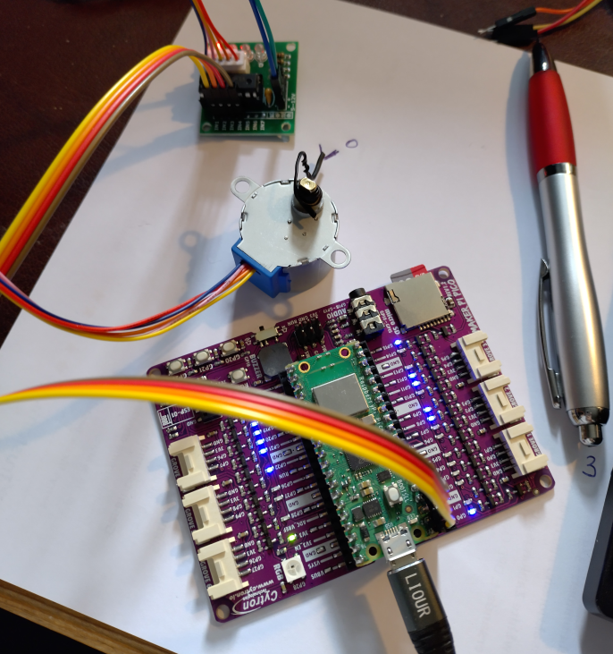

I wanted to play a self sampled flac file
Play flac "werda.flac"
Pause 3000
on a maker pi pico w.
The problem is: it sounds like mikey mouse - it is too fast. When I do the same using a wav file, everything works good. The rp2040 runs with 133 MHz.
> option list
WebMite MMBasic Version 5.07.07
OPTION COLOURCODE ON
OPTION DISPLAY 50, 100
OPTION WIFI <censored>, *********************
OPTION SDCARD GP15
OPTION AUDIO GP18,GP19, ON PWM CHANNEL 1
The audio connector on the pcb is connected to a active speaker and uses gp18,gp19.
-andreas

  Quote  The problem is: it sounds like mikey mouse - it is too fast.
You need to post the file and let me know what you think the sample rate is so I can read the header and see if it is correct

Posts: 11996
Posted: 03:57pm 13 May 2023
Before I set up to test - is it mono? If so this is the issue as flac playback doesn't support mono so will play at double speed

  matherp said  Before I set up to test - is it mono? If so this is the issue as flac playback doesn't support mono so will play at double speed
Yes - I used a Logitech microphone and when I remember correctly I switched to mono.
Thanks's for answer. Now I'm using wav and that works fine.
-andreas
