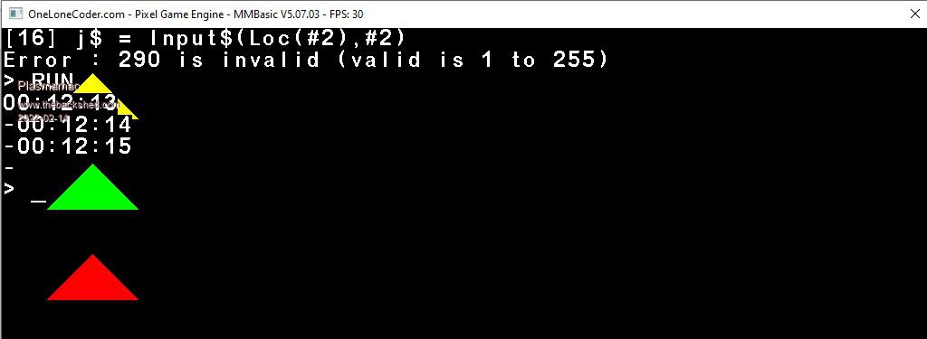

serial test :
open "COM4:115200" as #2
do
k$ = inkey$
if k$ <>"" then print #2,k$;
if loc(#2) > 0 then
j$ = input$(loc(#2),#2)
print j$;
print "-";
endif
loop
first Start gives an Error
second Start will work
Plasma
