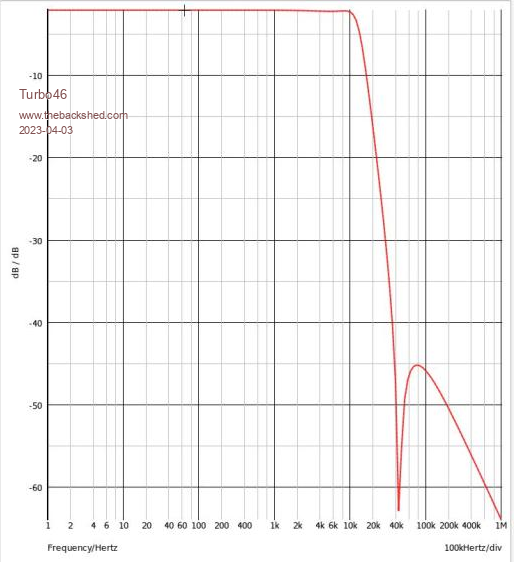

  Quote  b33/b3 also changes the frequency used for PWM and SPI output for audio as follows
CPU frequency 48-251MHz - 44100Hz
CPU frequency 252-377MHz - 88200Hz
CPU frequency 378MHz -132300Hz
I wonder how that will suit Volhout's filter using the inductor? It is tuned fairly closely to 44.1kHz and, looking at the response curve:
It may not have the same effectiveness at the higher frequencies?
But I believe that that particular curve was simulated without any effective series resistance (ESR) in the inductor. In the real world, they do have ESR which will lessen the depth and widen the breadth of the notch so...

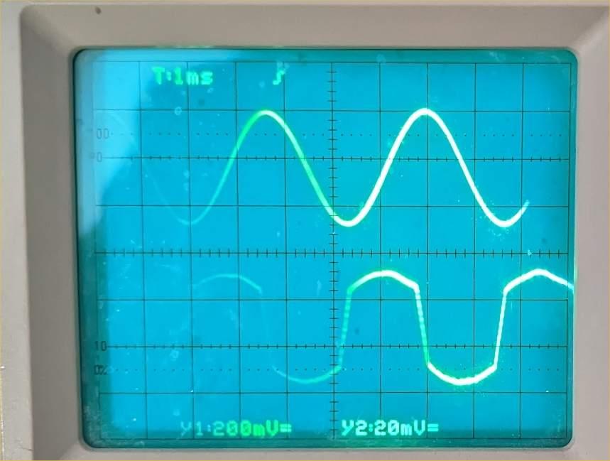

V5.07.07b34 / WEB V5.07.07b4
This will be the last beta - release candidate(s) next
Support for user loadable sound profiles
Use PLAY LOAD SOUND array%() to load a sound
array%() must be a 1024 element array loaded with 4096 16-bit sound levels between 0 and 4095
Use PLAY SOUND chan, L/R/B, U, freq to output the loaded sound
Array%() is easily created from a normakl 4096 element array using
MEMORY PACK inarray%(),array%(), 4096, 16
e.g.
Dim a%(4095)
Dim b%(1023)
For i=0 To 1023
 c%=calc%(i)
 a%(i)=2000+c%
 a%(2047-i)=2000+c%
 a%(2048+i)=2000-c%
 a%(4095-i)=2000-c%
Next
plot
Memory pack a%(),b%(),4096,16
Play load sound b%()
Play sound 1,l,U,400
Play sound 1,r,s,400
Sub plot
 For i=1 To MM.HRes-1
   Line i-1,MM.VRes-a%((i-1)*4096/MM.HRes)/(3900/MM.VRes), i,MM.VRes-a%(i*4096/MM.HRes)/(3900/MM.VRes)
 Next
End Sub
Function calc%(i)
 x%=128
 If i<x% Then
   calc%=i*1900/(1024*Sin(Rad(x%/1024*90)))
   If i=x%-1 Then o%=calc%
 Else
   calc%=Sin(Rad(i/1024*90))*(1900-o%)+o%
 EndIf
End Function
Sorry about the bad picture
Edited 2023-04-03 17:49 by matherp
