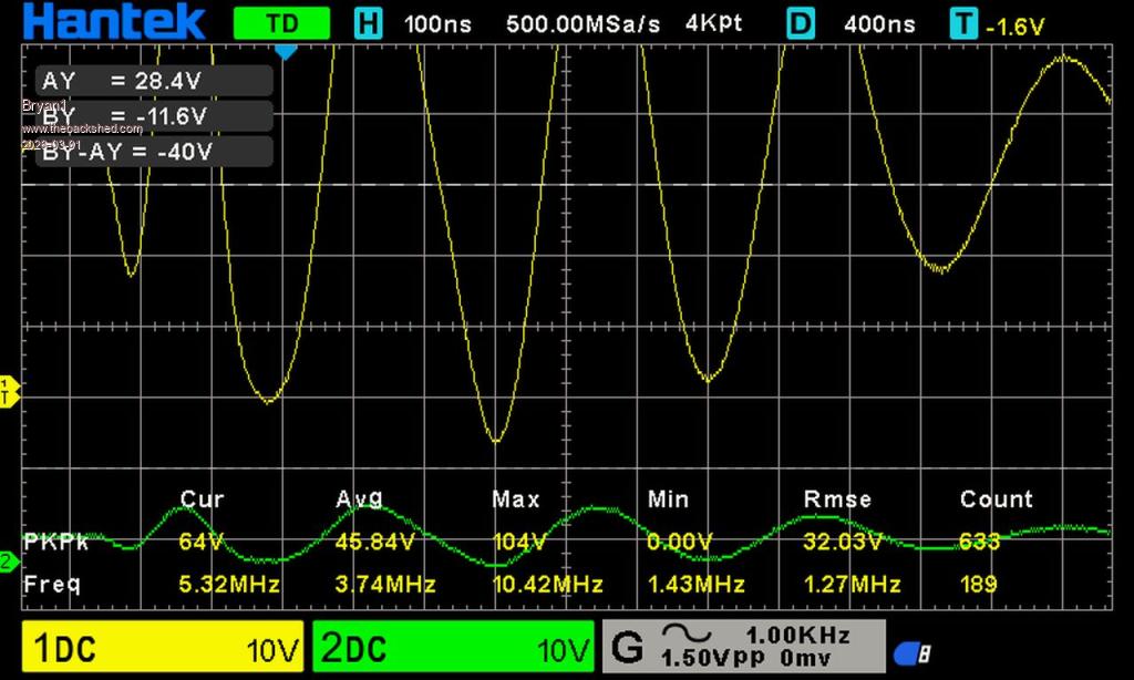

  Bryan1 said  Ok with this wet weather got the noise of my genset going to charge the shed battery.
Anyway powered up the controller board and measured 17.8 volts on the 18V zener, now when the ohm meter is used the Vbat + and VBat - are shorted out. Doing an ohm check on a few fets shows the gate is isolated and the source and drain pins are a dead short, so would this mean the fets are gone?
Anyway setup the scope and got a pic of the L01 and L02 first test
Regards Bryan
Your scope H setting should be in the milliseconds and not nanoseconds so that you can display at least 3 cycles of 50Hz.

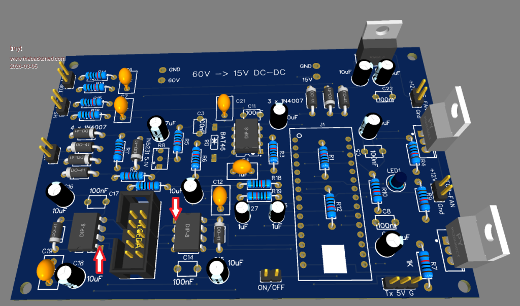

Here is graphic picture of the board, courtesy of poida,  with notes for reference.

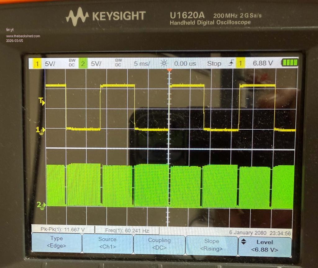

Also, here are some scope screen captures of the test points for reference. Note the settings pointed to by the 3 red arrows.
This is for L01(Yellow) and H01(Green)
This is for L01(Yellow) and L02(Green)
This is for L01(Yellow) and H02(Green)

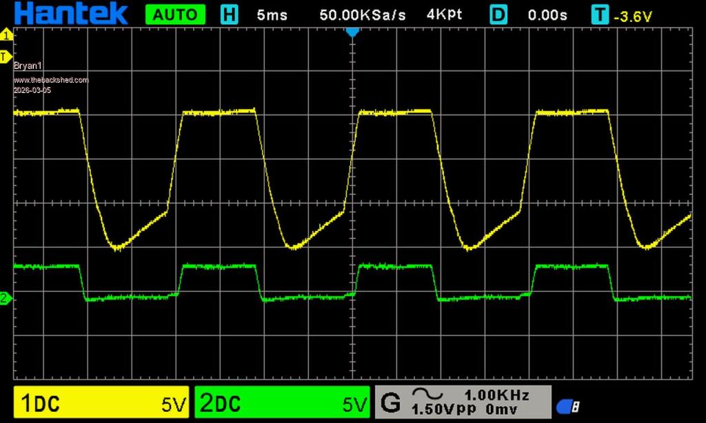

Ok made up a ribbon cable and labelled each wire for identification and setup ch1 to LO1 and the ground for the probe to VS1
H02 and I left the ground off VS2
The next test was
L01 and L02 and left VS1 and VS2 connected to the probe ground
Now when I introduce the Gnd wire to the scope Gnd the wave form goes flat so me thinks something isn't right there.
Now for this test I took the control board off and setup the programmable power supply for 15 volts where the current draw was 29mA
Edited 2026-03-05 11:13 by Bryan1

Still on the controller board powered and on switch to on:
Use only the ch1 probe and touch its tip to pin 1 of U1 '2184, capture the scope screen and post.
Then touch ch1 probe tip to pin1 of U2 '2184, capture the scope screen and post.
See below where the red arrows are pointing for reference.
Edit: Careful, do not touch probe tip to multiple pins on the '2184.

  Bryan1 said  Ok made up a ribbon cable and labelled each wire for identification and setup ch1 to LO1 and the ground for the probe to VS1
The next test was
Can you show pictures of your ribbon cable, where your ch1 tip and ground are connected and where your ch2 tip and ground are connected?
Edit: Show also how the ribbon cable connector is plugged to the controller board socket.
