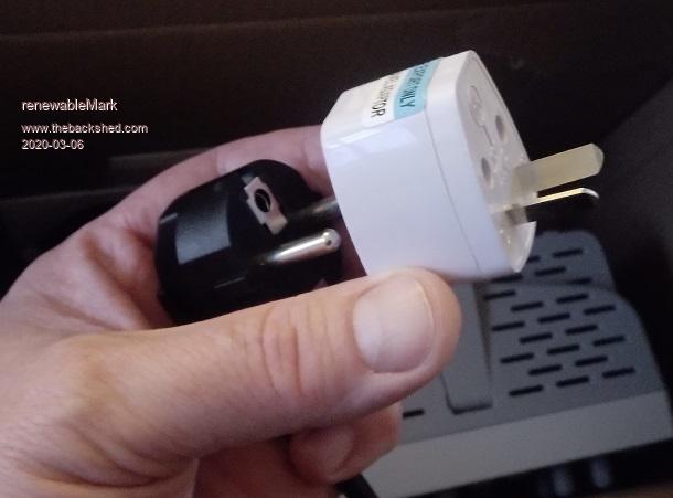

Dunno if they did it deliberately or out of cheapness, but it came with an international plug and adaptor.
So no earth to worry about, just need to be aware of this.
Cheers Caveman Mark
Off grid eastern Melb
Murphy's friend

If I were you Mark I'd cut that black plug off and fit a proper Australian type. You can then also see if the unit has a 2 or 3 core mains cable.

Some scopes, mostly the older ones have the probe grounds connected to the the earth ground of the power plug. If you are going to use it on a non-isolated mains connected equipment, you can blow the equipment, the scope or both at first application of power. I am speaking from experience. So, for a mains powered scope I always make sure that the earth ground pin of the power plug is cut.
Edited 2020-03-07 02:41 by tinyt
Posted: 08:46pm 06 Mar 2020
I agree.
For most things a proper ground connection is a vital safety feature to prevent exposed metal parts from becoming alive if the internal mains insulation breaks down.
Since the new age of fully plastic products, its now common to not have any exposed metal parts on many mains powered products, so there is nothing that needs to be grounded.
There is nothing at all wrong with a two pin mains plug without ground pin.
Now your spiffy new plastic oscilloscope has very few exposed metal parts you can come in full contact with, so its not going to be terribly dangerous even if it does become alive electrically.
On the other hand, grounding it, also earths the probe grounds, which can cause no end of problems and potential destruction.
Grounding exposed metal is definitely the safest thing, but electrical test equipment is a rather special case. Poking around inside high voltage equipment with test probes and ground clips is potentially dangerous anyway, but at least you are, or should be aware of the dangers involved.
That is a very different thing to one of your children or your wife being electrocuted by a faulty household appliance that MUST be safely grounded.

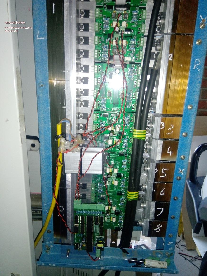

Had a busy weekend with the family, so still haven't used the scope.
I got the control board and a 12v supply mounted to a sheet of perspex.
Just need a fuse for that, then mount the resistors to feed the bus bars with a restricted supply and I can start testing the torroids.
So with the big No1 I have 2 identical sets of double stacked 3 Kw cores.
One was wound the conventional way with the secondary on first and large primary wire over the top.
Second one has multiple thin primary wires wound first all joined together to match the same mm2, then a 6mm spacer on top of that, then the secondary windings went on last.
It will be interesting to see the differences between the two winding methods.

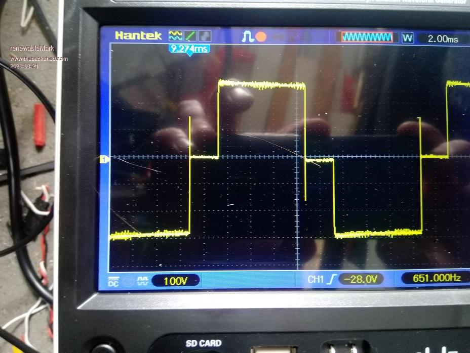

Posted: 04:53am 21 Mar 2020

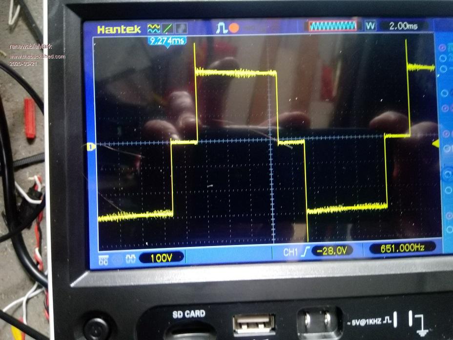

Finally started testing.
This was initially done with restricted power to see if anything was out of the ordinary.
Then full power was applied but still no caps fitted.
The wave seems to have spikes at the edges which grow from one set of steps, then swap to the next set of steps and grow there.
This was done with the large torroid and it's matching driver.
Cheers Caveman Mark

Posted: 09:03am 21 Mar 2020
Hi Mark, my internet connection took a complete dump Friday night, and has only now started working again.
That all looks fine.
You will very likely see those same spikes on the main dc supply, they will go away when the big electrolytics are connected back up. Keep going and bring the smaller two inverters to life.
The combined waveforms on the secondaries may look a bit odd too, at this very early stage.
There will be a lot of power circulating around between the various inverters, and without a stiff dc power source to work from, everything gets a bit chaotic, but it will all come together perfectly once everything is finally all working together.

Posted: 10:26am 21 Mar 2020
I don't think you can really tell anything yet, except its working as it should, from a soft dc supply, without any dramas.
Those voltage spikes occur when a diagonal pair of mosfets turn off, its a back EMF effect in the primary that has very little actual energy. Either placing some load across the secondary, or an electrolytic across the dc supply should get rid of them. Nothing to worry about, when everything is finally hooked up, they will be gone.
The current spikes in the primary are a different thing entirely. They occur when a diagonal pair of mosfets turn on. The sudden instantaneous voltage step has to charge up all the capacitance across the transformer secondary.
Your new "low capacitance" large toroid should go a very long way to minimising that problem.  We shall see.

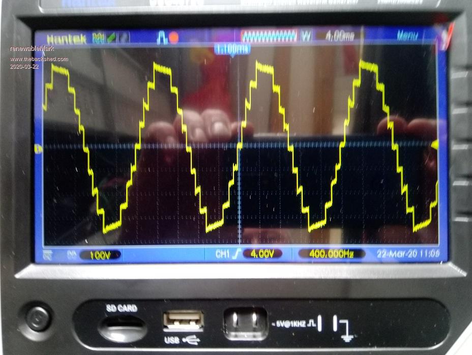

Here it is with 1&2 in series.
I'll wire up No 3 next.
Cheers Caveman Mark
Posted: 03:30am 22 Mar 2020
Excellent Mark !
Three in series will still look a bit rough and lumpy, but the sine wave shape begins to emerge. Each additional inverter makes a tremendous difference.
When you connect up the smallest fourth inverter magic happens.

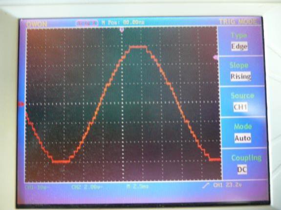

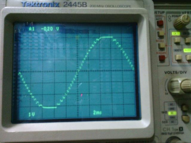

This is mine with three inverters.
This is Andrew's with three inverters.
If yours looks like those you are in for a very pleasant surprise when the fourth inverter is connected.

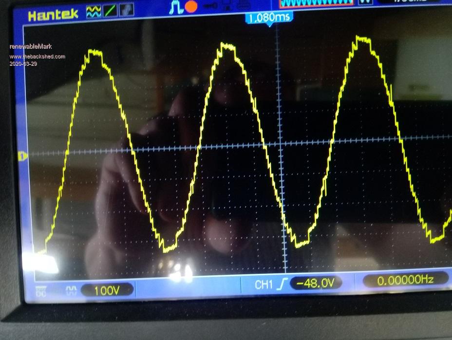

Posted: 01:33am 29 Mar 2020

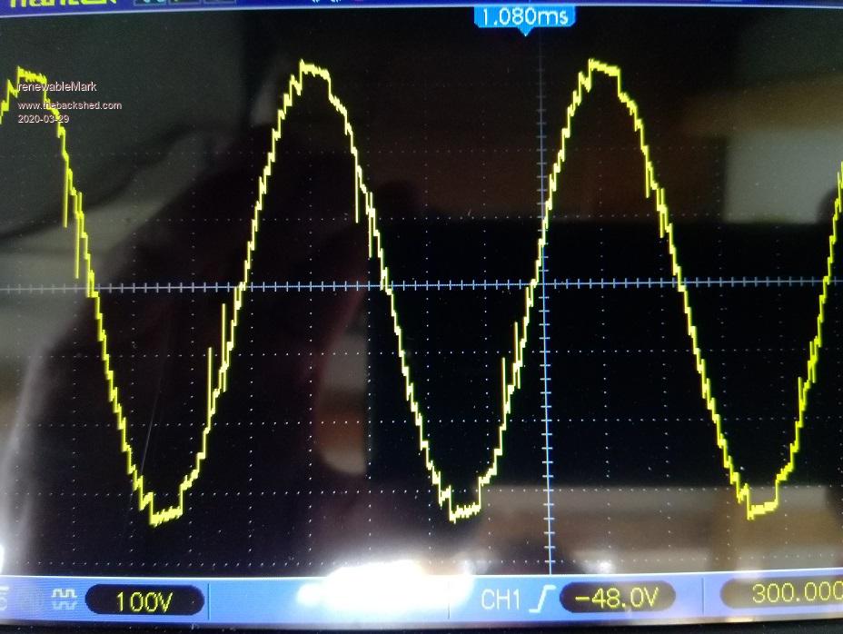

This is it with 3 largest in series.
A few spikes appear at random times.
Cheers Caveman Mark
Posted: 02:22am 29 Mar 2020
Don't know where those spikes are coming from, some of them appear to be in the middle of a step.
But otherwise, it looks o/k, it now shows the beginnings of a sine wave.
Those spikes may have to do with grounding or lack of grounding on your oscilloscope, right now the whole mess is just floating, and there is rather a lot going on around your four transformers and all the associated wiring.
The real test will be with number four going.
That should clean it right up, especially after you tie one side of the 230v inverter output down to neutral/ground.
