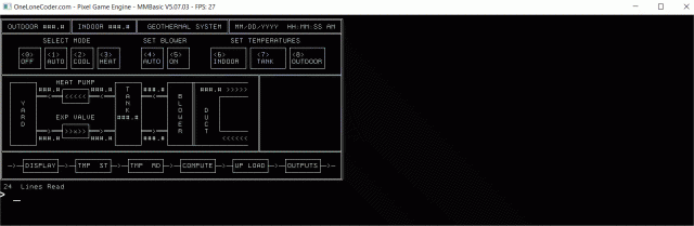

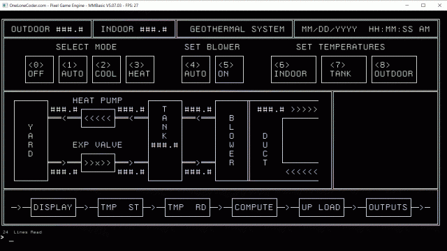

Puzzled by need to set first line printed with TEXT at other than 1 in order not to have top lines scrolled off.
For Paul_L's display using PC graphics drawing characters, when using scale to make the display as large as he wants, I have to set the first line at 7 when scale is 2, or at 13 when scale is 1. The program sets mode 16 and font 4.
Display with scale=2, first line is 7 (this is the way Paul wants it to look):
Display with scale=1, first line is 13:

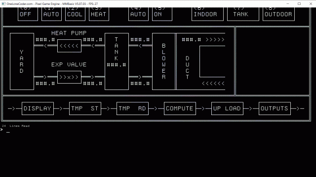

Here's what it looks like with scale=2, first line = 1 (it's similarly off the screen with scale=1 and first line = 1):
Here's the code:

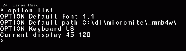

Here's the result of OPTION LIST:
If it's significant, my display resolution is 1600x900.

Posts: 12041
Posted: 02:51pm 04 Jul 2022
This is a known issue and happens when the mode size is >= to the actual physical display size.
Try setting the mode to a minus value to use full screen mode or chose a mode smaller than your physical screen

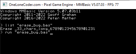

Thank you Peter, you've fixed that, but a recent addition to the MMB4L firmware test-suite has revealed another issue:
Running this will immediately crash-out MMB4W, note that it is crashing out whilst loading the program into the program memory not whilst it is interpreting it.
I believe it should instead be generating the error "Name too long" during interpretation.
