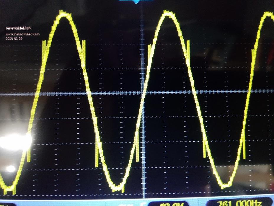

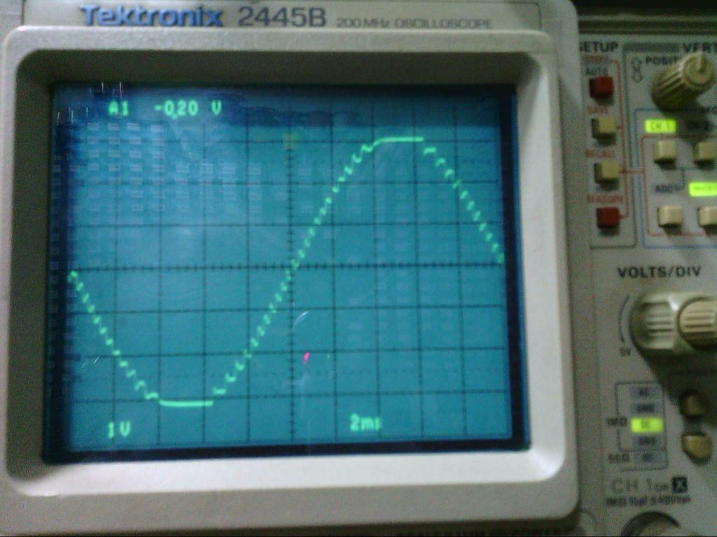

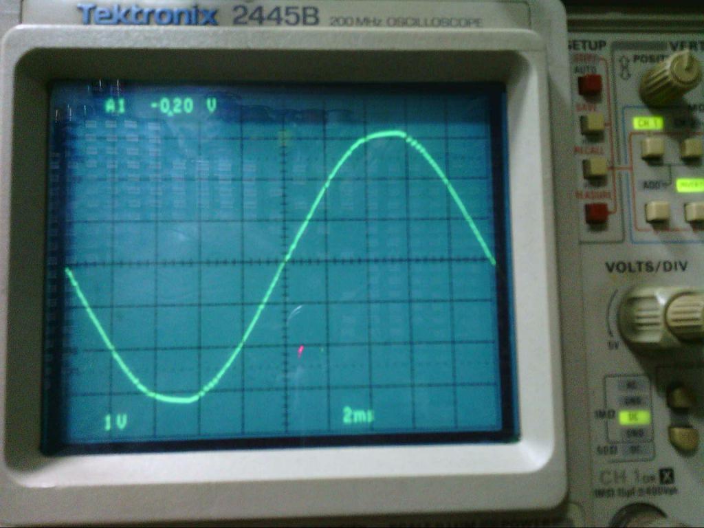

These two pictures were taken at the same time with everything exactly the same, except the second picture has drive to the number four inverter plugged in.

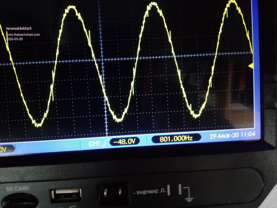

OK here it is with all 4 hooked up.
It's still being fed by the restricted power supply.
I'll try it without the resistor on the supply next, then add capacitors.

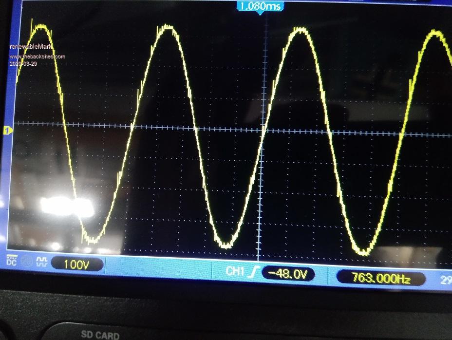

Here it is without the resistor on the power supply. It's just being fed by a wire I got from an extension chord, so it's not capable of a really solid supply.
Next test will be to give it full power from the big battery, then add caps.

Posted: 04:06am 29 Mar 2020
Excellent progress Mark, very nice indeed !
All that furry stuff should go away, and quite probably those spikes as well, when you remove the resistor from the dc supply, and put the electrolytics back.
You can see a very nice clean sine wave hiding beneath all the fluff.
All your small steps appear to line up perfectly which means your transformer voltages (and turns counts) are spot on perfect.

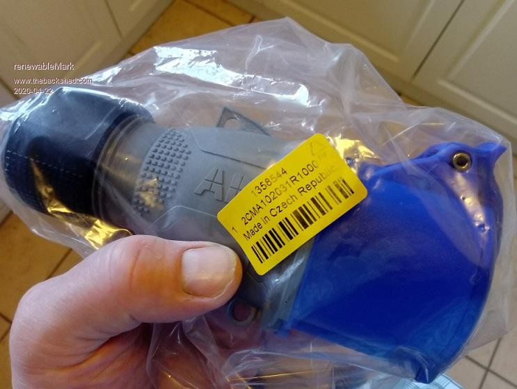

Plug finally came from Czeck land.
Now I can hook it up and test it properly.

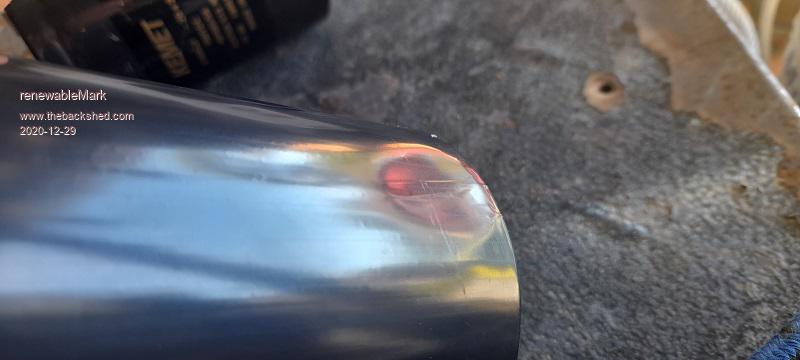

I went to wire it up a couple of months ago, and found I didn't have heavy enough 240v cable, so ordered that. It came in and I forgot about it again.
I did order two more caps for it though, but they came in just today bloody dented from digikey, Haven't heard back from them yet.
Might not be anything to worry about, but a bit pissed off after forking out $130
Stupid thing was they were packed really well, so it wasn't in transport, they packed up and sent me dented caps from the warehouse.
Both were dented in the same spot.
Must have been a good knock as you cant squeeze the sides of the can as hard as you try with your bare hands.

Digikey are replacing the caps, they are letting me keep the old ones, but they copped such a knock I wouldn't dare use them.
That photo doesn't do it justice, if you see it in real life you'd think the same.
