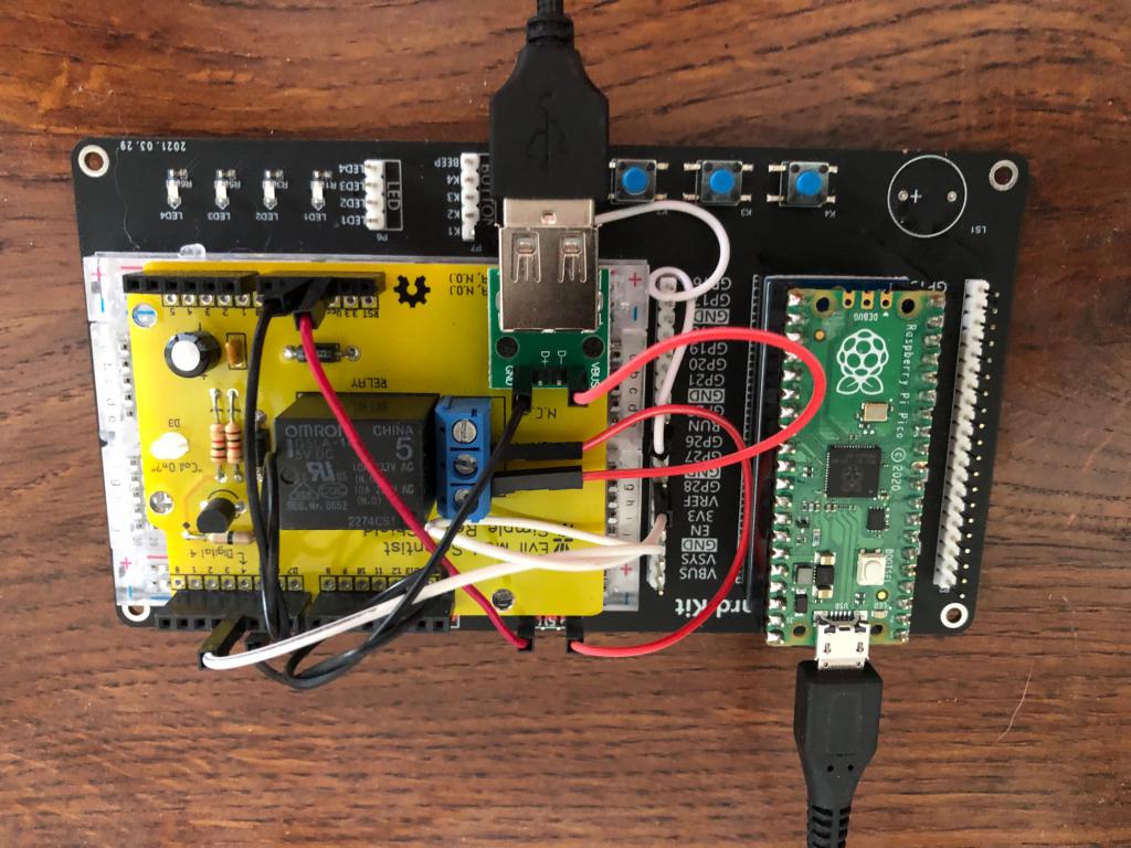

Posted: 06:07pm 17 Jun 2021
Here's a picture of a Pico version of my MMBASIC automatic nightlight. A Waveshare DS3231 RTC board is under the Pico. The relay board is from Evil Mad Scientist.

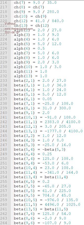

Attached in a zipped file of a crunched version of NPOE. It runs on my Pico without any problems. After crunching, the source file is about half size. There is a bit of time before new screen displays appear.
npoe_crunch.zip

  cdeagle said  Attached in a zipped file of a crunched version of NPOE.
How is this crunch being performed?
cdeagle
Joined: 22/06/2014
Posts: 269
Posted: 10:55am 18 Jun 2021
@lizby
The NPOE MMBASIC source code is opened in an editor (Geany for example). The entire file is selected and copied within the editor. At the Teraterm command line, autosave c [Enter] is typed. The copied file is then pasted into the Teraterm command window.
The NPOE program can then be run and saved to disk or sdcard in crunched format.

Posts: 6209
Posted: 11:35am 18 Jun 2021
hi cdeagle,
About NPOE and crunching....
If I look at this, another 1k can be shaved off in crunch mode.
MMBasic does not need all this space (read: these spaces).
