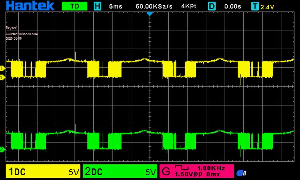

Ok taking Mab's suggestion undid the VS1 and VS 2 connections and set Ch1 to VS1 and Ch2 to VS2
Now with the psu set at 24 volts and the DMM connected to the resistor bank does go to VBat so when the switch is turned on the current goes upto 240mA from 70mA then drops off as the voltage drops to 11 volts.

CH1 is connected to the outside leg on TIP42
CH2 is connected to the outside leg on the TIP41
DC voltage 10 volts on the DMM connected to the resistor bank
Yes Phill VS1 and VS2 are out of circuit so the toroid is offline
Any scope connection tips are welcome

Ok I took the resistor out of circuit and limited the psu to 300mA, with the board off the pre charge was well under 300mA
Now when I turned it on with a 28 volt DC input the DC voltage dropped to 16 volts and with the probes connected to the tip chips the wave form didn't move with the dropping voltage. Also the LCD is affected with screen going faint like it was lacking power.
OK just used the scope to check all the fets on the front where all of them showed the same wave form, now the ones at the back are too hard to get to.
Also I noticed when I raised the current to 500mA the board did take it so turned it off.

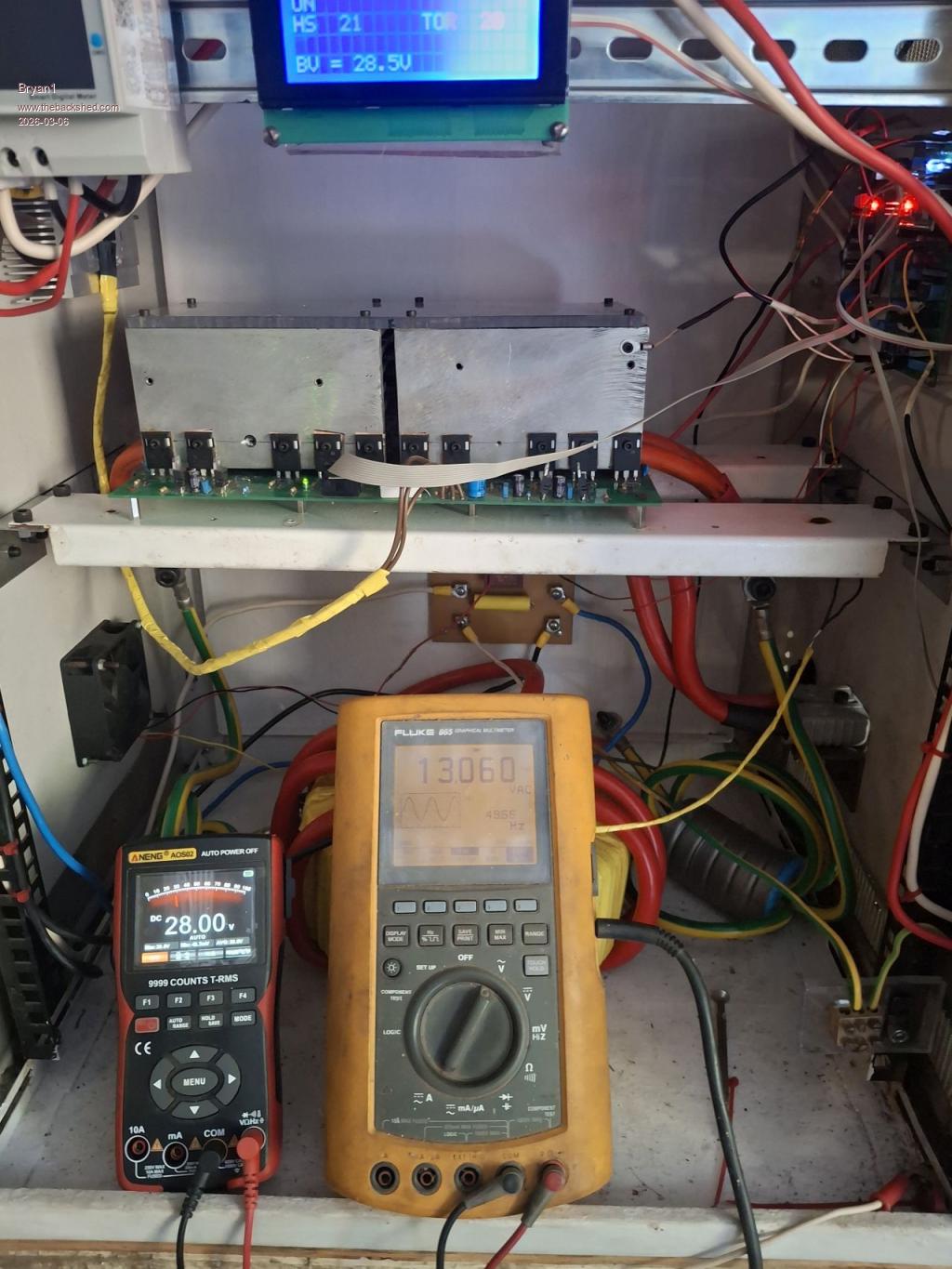

Well as all my tests this afternoon was with VS1 and VS2 off connected them up and yes Phil this time the DMM went to 28 volts pretty quick so turned on the nano
Now the DMM on the left is the DC voltage and my old fluke meter is showing the AC side so a nice clean sinewave but 13 volts   but eh it's better than the 3 volts before
I do have to state the resistor bank was left out of circuit for this test and the current draw was well under 100mA while getting upto voltage.
Now I did set the current to over an amp on the psu and the current draw was 520mA so not far away now

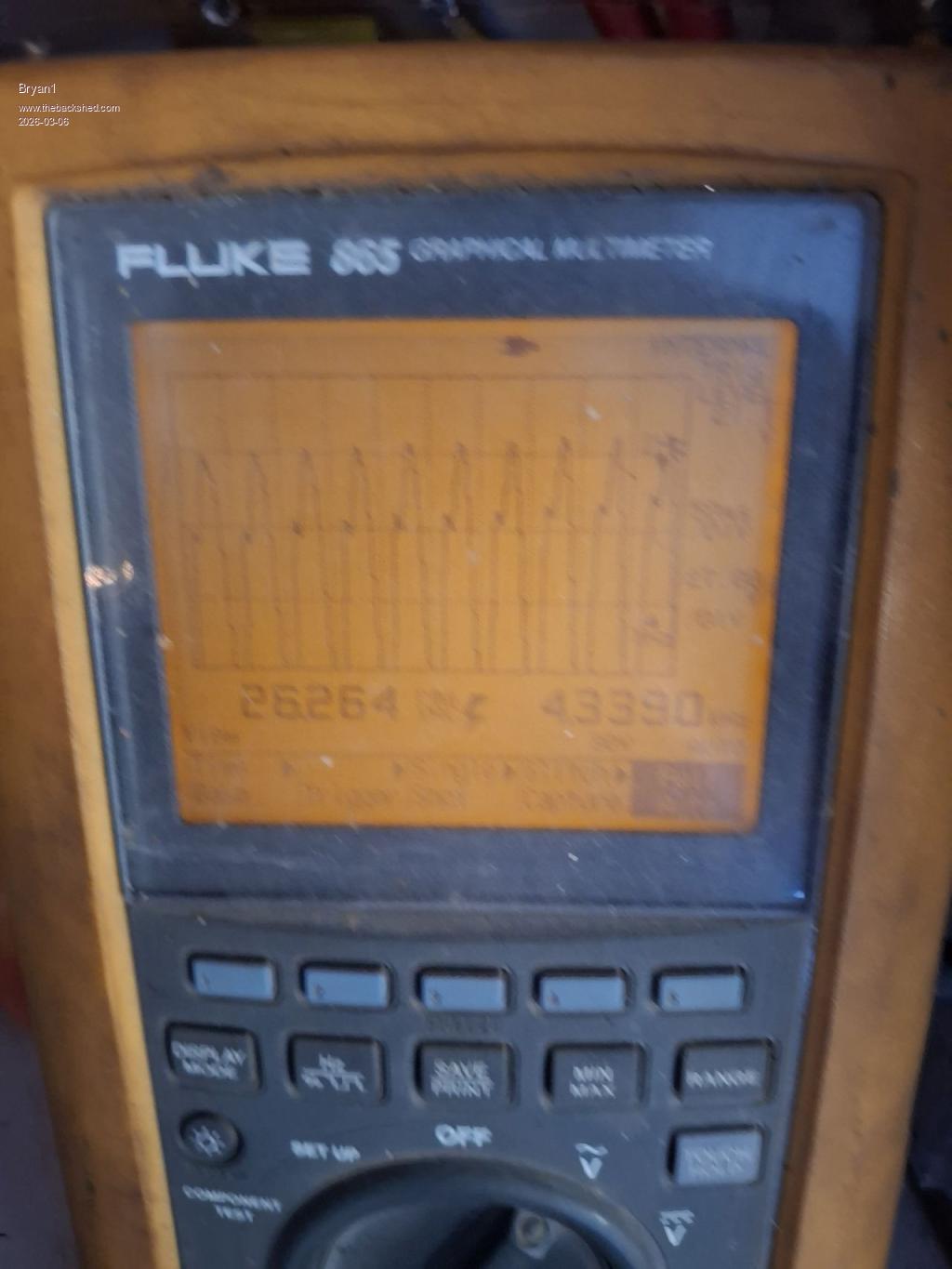

Now for the next test I took the output from the toroid to clamp probes and put them on my fluke in scope mode so as we can see the good sign wave has gone.
Having a couple of cool ones is getting my courage up
The PSU is on 28 volts and the current draw is the same around 500mA now I have set the max current to 1.1 amp and it hasn't gone close to that.
Now with my next test I will hook up the scope.

Don't think so, it sounds more like the AC output voltage is set low on the nano AC feedback line, or something is causing the cal input to the Nano ADC to be wrong.
Without any load, the AC should be a smooth sinewave.
I normally use a small isolation transformer when driving the DSO, usually I am measuring a few channels and DSO earth is best kept floating from the AC output,
IE even a simple 240v to 6v to 15v small transformer will do, the DSO connects to low voltage side and is now fully isolated.
NOTE to forum: That is a very "simplified response", way to do it and reason for doing so!!
EDIT: Bryan, your SMALL scope sine wave could be distorted by coupling from the switching side of the Inverter board and wiring. It should only show a bit of 25khz fuzz.

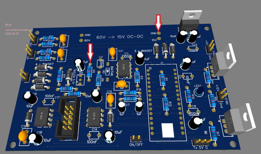

On the pico board:
Check DC voltage between the two red arrows in the picture below.
It should be much lower than 5vdc. If not, check D8(BAT46). It could be shorted or orientation is reversed.
