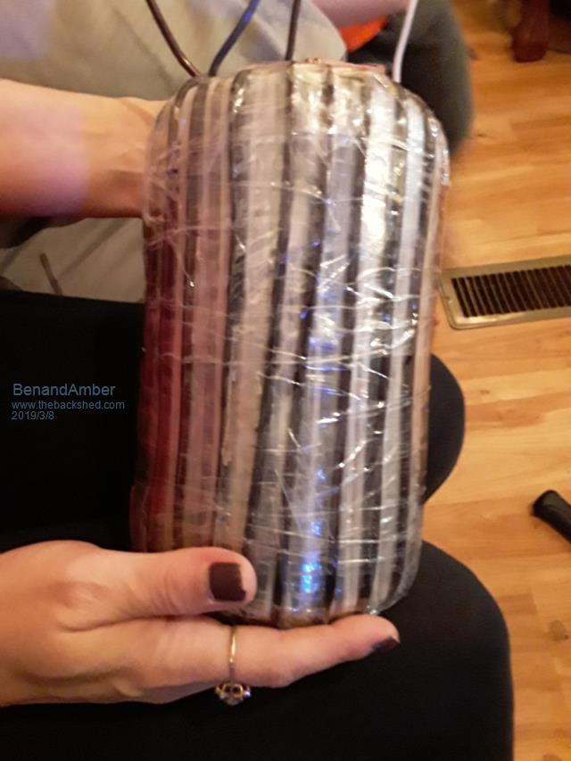

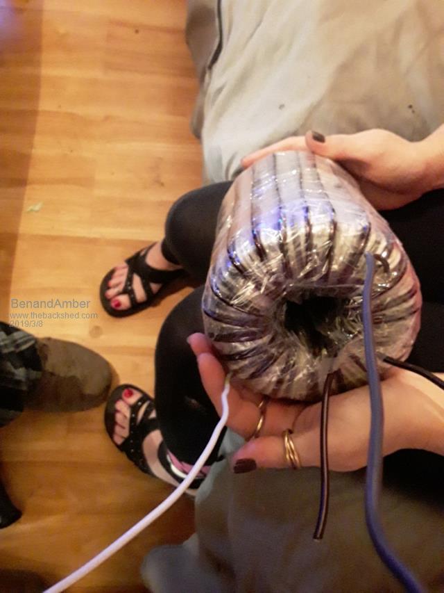

We got Amber's Transformer primary wound up and ready to go 10 gauge on the secondary and 3 gauge on the primary it's just what I had laying around being a electrician not too shabby for a quick job next is the wind the choke probably do that tomorrow maybe tonightEdited by BenandAmber 2019-03-09

Making your transformers is a satisfying thing. I did not do this, I used an already made one from a locally available grid tie solar inverter (Aerosharp 3kVA unit).
It is all I need for my 1500W home system.
I like how you built up a big one from a few smaller toroids. It will probably be useful but not capable of the 5kVA the mobile home of yours needs.

the Transformer Amber made I am hoping it will be good for 2000 watts
it has 4 250 watt cores but they were medical grade and under rated I think
love happiness good health and peace to you poidaEdited by BenandAmber 2019-03-11

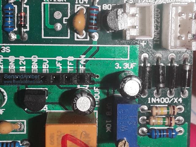

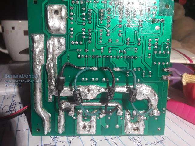

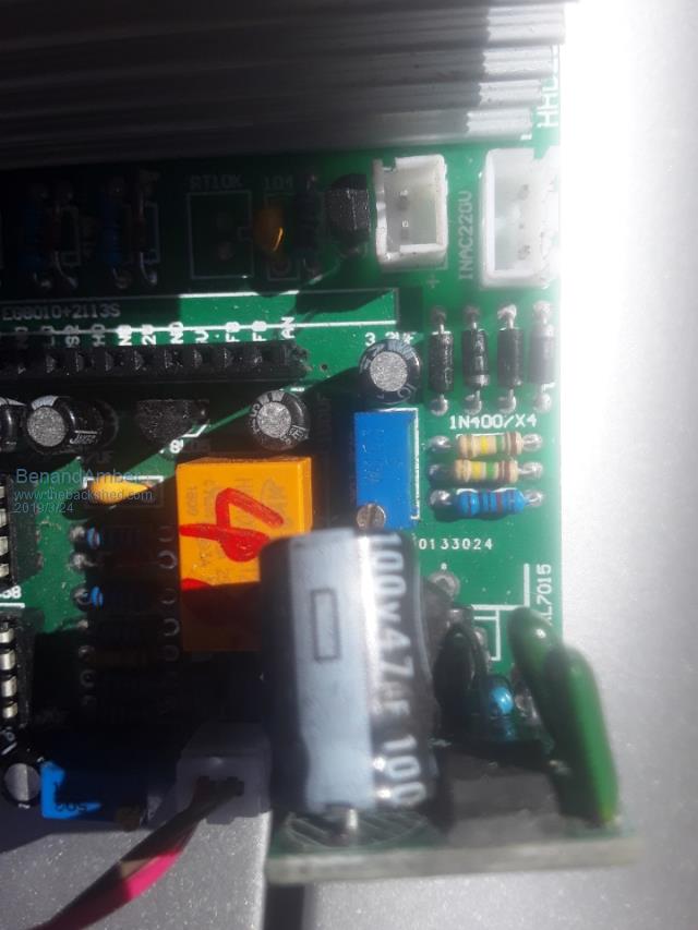

Top view
Top view
Top view
Bottom View

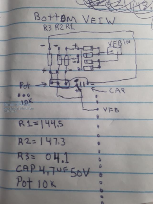

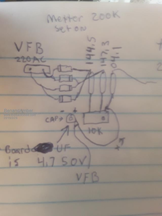

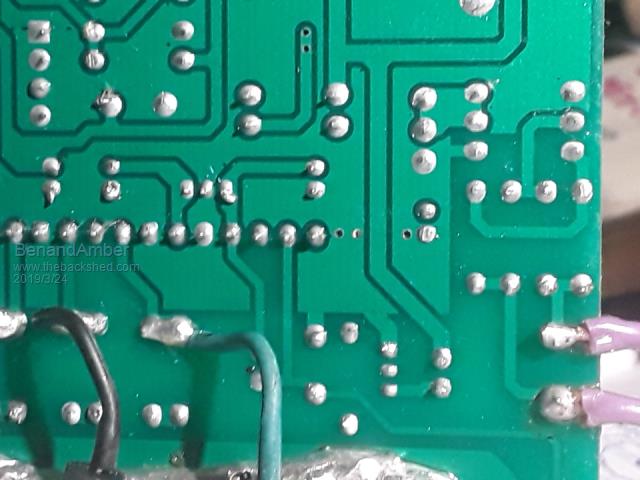

This is how I think the circuit works it's like it's got two paths for the voltage to go
Bottom View
Bottom View
The two purple wires feedback from Transformer
We are needing to change this board from 220 volt to 120 volt
We are having a hard time trying to figure out if it's just as simple as changing the two resistors to half the value
or if there's something more complicated going on I'm not showing any continuity between the two alike resistors so I don't think they are making a voltage divider unless I'm missing something here
Thanks everyoneEdited by BenandAmber 2019-03-25

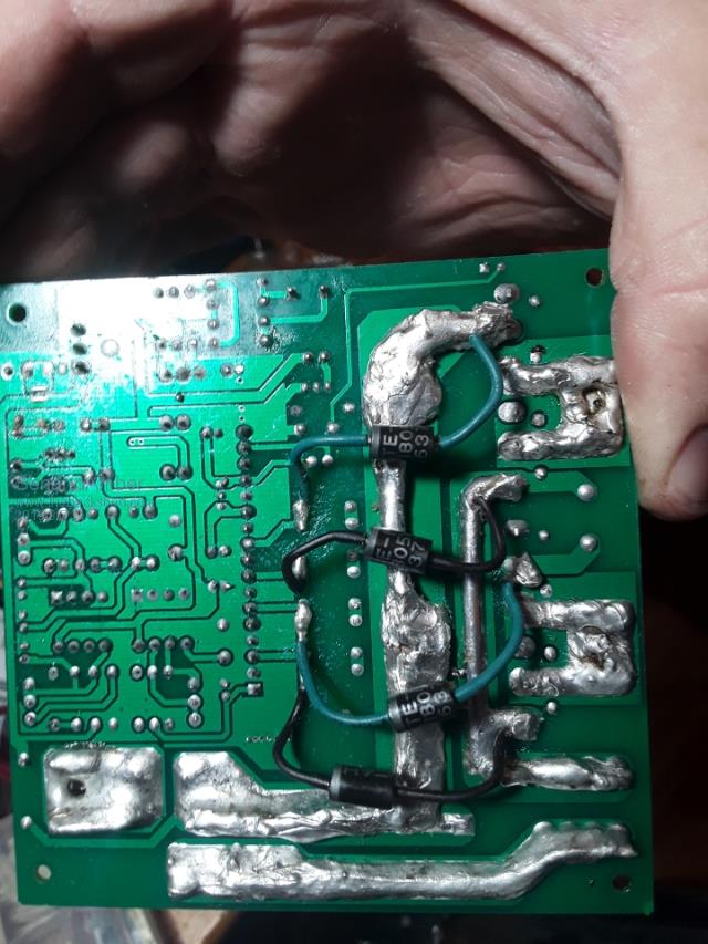

Bottom View
This is absolutely killing me I don't need to just have a fix for the problem I have to know how it works
Thank you guys I appreciate it any input would be greatly appreciated

What transformer winding are the purple wires coming from - is it a winding from the main toroid or is it a separate transformer across the 220V output? Can you run the unit as a 220V inverter and measure the voltage across the purple wire connections what is it ? There are a few ways to achieve what you want but more information is needed. I gave up using the dedicated EG8010 chip in favor of the nano inverter controller but I can still try to help you.
If you havent powered up the unit that might be a good thing - see below.
What are the four diodes under the PCB - are they transorbs ? If they are they dont look wired correctly to my old eyes. I am assuming they are to protect the gates of the output mosfets? The green anodes should not be connecting to the + supply but to the Drain to Source connection (big almost square sections with U shaped solder that join the LHS & RHS 2 mosfets together) ? Effectively join them to each FET between the gate and source (outside pins cathode (band) towards Gate) preferably with short wires.
For clarity, in the picture below the chinese eGS002 board (top of page) the rhs green connections need to both move down one connection from the drain to the source - can someone else please chime in if they agree I dont want to blow up Benn & Ambers board.?Edited by wiseguy 2019-03-26
Cheers Mike
Thanks everyone
I just now replied to your PMs regarding this question.

I'll sign off & leave you in Poidas good hands - I just did some calculations and realise that the two purple wires are obviously across the mains output directly.

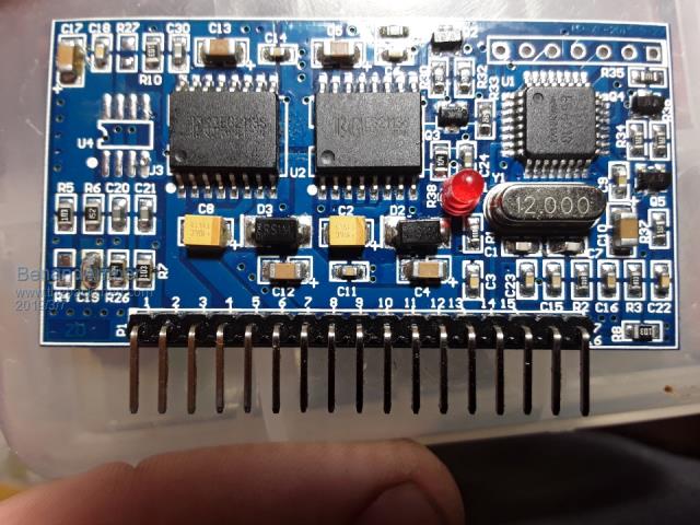

Thanks everyone
BenAmber
You'll be doing the following if not already done
a) Make the following changes in the jumpers on the small EGS002 daughter board.
1. Change jumper for 120Volts
2. Change jumper for 60Hz from 50Hz
b) Add a small transformer 110/6 volts and adjust the pot to bring the voltage at 3 VDC at pin-15 of the connector where the egs002 board plugs in.
Here is the link
https://www.egmicro.com/download/EGS002_manual_en.pdf, Excerpt copied below
azhaque
3.3 Jumper settings
Designator Name Mark Setting Description
1 FS0
JP1 When JP1 is short, it selects AC output frequency at 60Hz
JP5 When JP5 is short, it selects AC output frequency at 50Hz
2 SST
JP2 When JP2 is short, it enables 3 seconds soft start mode
JP6 When JP6 is short, it disables soft start mode
3 DT0
JP3 When JP7 and JP8 are short, dead time is 300ns.
When JP3 and JP8 are short, dead time is 500ns.
When JP4 and JP7 are short, dead time is 1.0us.
When JP3 and JP4 are short, dead time is 1.5us.
JP7
4 DT1
JP4
JP8
*5 LED+ JP9 When JP9 is short, LCD backlight is on
When JP9 is open, LCD backlight is off
The driver board’s jumperJP5, JP2, JP7 and JP8 are shorted as default setting, corresponding to
50Hz output, soft start mode on, 300nS dead time. Users can change these based on their needs.
Warning: Jumper of the same function CANNOT be short circuited at the same time. (For
example: JP1 And JP5 cannot be short at the same time.)
Edited by azhaque 2019-03-26

  azhaque said
BenAmber
I know I wasnt going to comment further but its hard enough making these things work ok without misleading or incomplete details:
What is the jumper on the EGS002 for 120V ??
What about the 2 x 150K resistors, they will need changing too. For a 6V transformer I calculate a value of 2K2 each as a reasonable starting point.
Cheers Mike
