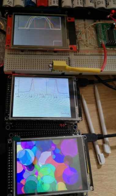

Second one up even quicker... The "twins" on test with one of my MM2 28 pin jobbies at the top.
rough side-by-side tests, I reckon the F4 is 3 to 4 times faster than the MM2 at 48MHz just by judging the redraw of the screens you see here
Edited by CaptainBoing 2019-05-17

EDIT: Bloody hell, this is one fast LCD port!
Excellent stuff. 1196 circles per second with GUI TEST LCDPANEL.
The ONLY thing I don't like about this setup, is that the LCD and the main-board do not line-up, but that is only a grumble more then any kind of complaint. I like neat stacks of boards. There is no way to secure the LCD module to the main-board, as the holes are miles out from each other.
