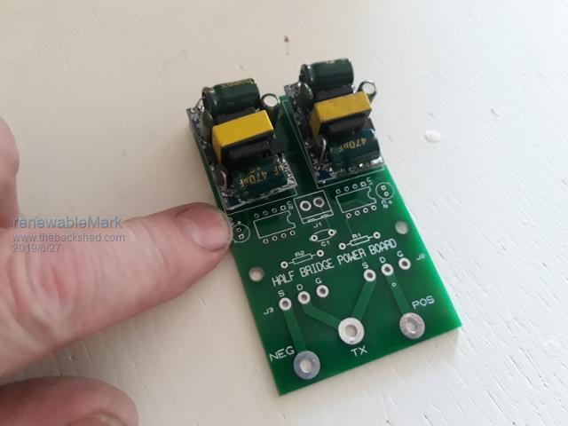

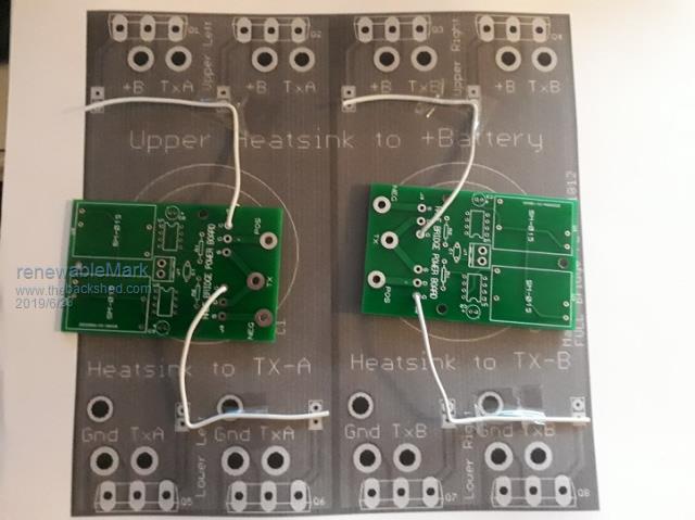

I'm going to use the small driver boards to directly run 2 fets from each for testing the system.
After that I was wondering if those same driver boards could run the Mack power boards.
Would this work?
Cheers Caveman Mark

Mark, one gate resistor for 2 Fets is not ideal. But It will work. You also need to wire the gnd from the driver boards to the round pad.
You could stick a resistor in each square pad on the Fet board and run a wire to each of those. Or mount a second resistor on the driver board and wire from each.
I do have a spare driver PCB that you could mount your driver boards to. That would give you plug in header function, or if you want more than one, use vero board and make a compatible plug in board or my gerbers and cad files are on my github.
Andrew

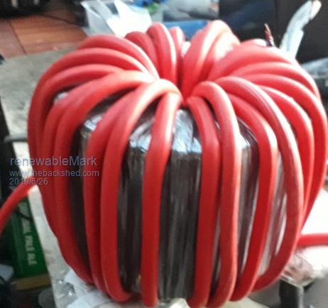

Got the 6kw torroid primary on, so all the torroids are all done now.
Forgot to say, I got 15M and was left with 1M tails on each end... nice guess, actually I did calculate that
BS many will say but yeah for once I did.
The No 2 torroid used 21M of primary, it comes std in a 30M roll, so will have some left for various crap.
Just thought I'd put those numbers down in case anyone else does the same build.
Cheers and more beers.Edited by renewableMark 2019-06-27

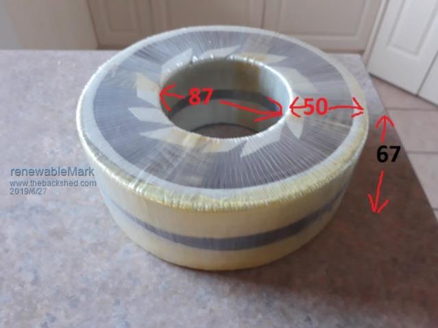

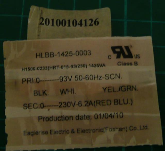

Mark, guys,
Would you happen to know the wire/w diameter on the inner winding of the AeroSharp 1500 transformer?
Do you happen to have the core size?
The outer winding, 230V, is 2 x 1.8mm dia
AndrewEdited by mackoffgrid 2019-06-28

Posted: 04:20am 27 Jun 2019
The one I stripped had all the wire tossed, so can't tell for sure, but it looked all the same size to me.
I thought they used 1.6mm diameter.
Tony, with the driver boards the DC output goes toward the centre of the board yeah?
Cheers Caveman Mark

renewableMark
Joined: 09/12/2017
Posts: 1679
Posted: 05:20am 27 Jun 2019
1500w core
id 94mm
id to od thickness 46mm
height 47mm
Cheers Caveman Mark

Posted: 06:06am 27 Jun 2019
Yes that is right, dc output to the middle.
Input line/neutral to the edge of the board.

Posted: 06:31am 27 Jun 2019
Thanks mate, I'll fit all the little bits first on the next ones, just wanted to get a feel for how I'll mount them.
The two inner connections I bent some header pins, the outer ones are a bit far apart from the pcb layout so they got insulated wires, all easy 2 min job.
Cheers Caveman Mark

Posted: 07:11am 27 Jun 2019
2kw Aerosharp.
Cheers Caveman Mark
