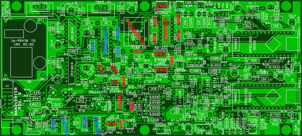

The TLP523 comes in 1 and 2 inputs/outputs.
The TLP523-1 only has 4 pins and this can be placed in the 8 pin socket
intended for the TLP523-2, using the top 1,2 and 7,8 pins.
But you don't want mains sync anyway...
here is the top board with a few things marked that I think you don't need.
It scrubs out the RS-232 (red) and the mains sync (blue).
It retains the SCR current limit shutdown function. For this to work you will need a current transformer of some specification (about 15V - 20V at the AC current trip limit)
Edited by poida 2019-06-12

If I'm understanding what you're saying correctly
everything in red and blue I do not need
I have crap loads of small Transformers
I already have a small Step Down Transformer 120 to 12 volts
would you happen to have a picture of the current Transformer that you could share
Or a picture of the completed board
Thanks again and I'm sorry for being a pain in your ass
I know you're very busy

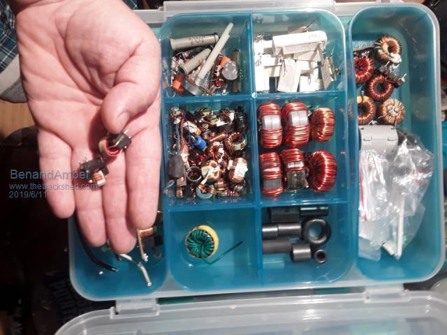

Step Down Transformer does not = Current Transformer.
Can I offer a suggestion, Google "Current Transformer" it is better to learn how to fish than to just ask for fish.

I know what a current Transformer is
I have several of them here but there is different kinds
I'm sure Poida is thinking the same thing you wrote
He said it needs to be between 15 and 20 volts
I've been Googling but I just keep getting more confused
Could you point me to one that I can buy so I can read about it and understand it a little better
I don't want to fish I just want to know what kind of fish were fishing for
I'm just confused I do believe if I had a little bit more information I could figure it out though
Thanks for answering my post Madness I appreciate it
I just need a little bit more information so I can figure this outEdited by BenandAmber 2019-06-12

If you read this you will have a good understanding Wikipedia
These are the type we have been using previously.
Current transformer Edited by Madness 2019-06-12

So this will be going around one leg of the output of the inverter
and feed the smaller 15 to 20 volts back into the Nano control board
And it will need to be able to handle a little over
the maximum amount of amperage that's the inverter will ever put out??

The Active wire of the Inverter output passes through the Current Transformer as shown here.
renewableMark
Joined: 09/12/2017
Posts: 1679
Posted: 07:23am 11 Jun 2019
There is a CT socket and a 12vac vfb socket.
The CT uses the one like Mad posted a link to this type
The 12vac VFB you'll need something like this
Cheers Caveman Mark

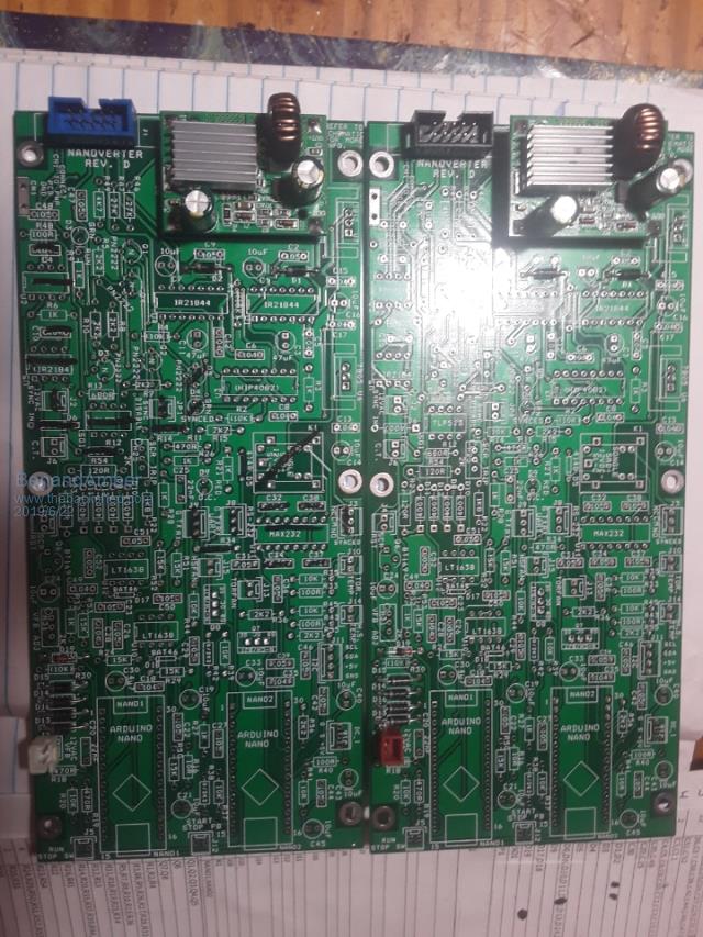

The little converter boards are very fiddly, and honestly I would reccommend to use plug in chips even if they cost a lot more.
Adding another complexity to the build just makes the overall job harder and open to potential issues.
But if you want to then these are the bits you'll need
DIP8 TO SOP 8
SOP14 TO DIP14
LONG HEADER PINS GET THE 19MM
LT1638 CHIPS
21844 SURFACE CHIPS
SIL HEADER SOCKETS
When you solder the pins to the adaptor boards make sure you have them up the correct way, they have the layout on each side for different size chips.
I had a few of those chips not work, possibly as I overheated them when soldering?? They are fiddly and it's probably not a huge amount more to get the plug in ones by the time you buy the long pins and adaptor boards.Edited by renewableMark 2019-06-13

I will definitely get the plug-in ones if you think that's the best thing to do
I highly value your opinion and others on here also
Sometimes I think I know something and then find out I don't know anything
So your opinion is very valuable to me
I will be buying them off AliExpress digikey doesn't have them
I've had very good luck buying stuff off of AliExpress
But I've always bought something that was recommended by someone else
Or had a lot of good reviews
Thanks mark

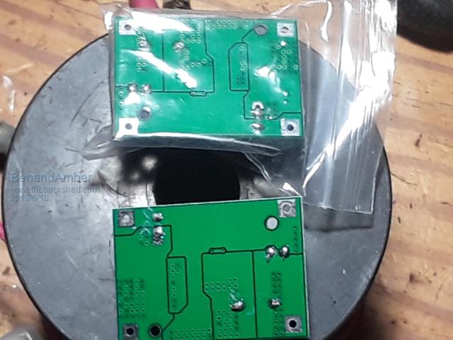

woohoo the dc-to-dc converters came in
Wasn't expecting them this soon
hopefully the rest of the parts come in early also

I ordered the 12v version because it was cheaper. Going to adjust it to 15v
BenandAmber
Joined: 16/02/2019
Posts: 961
Posted: 01:05am 22 Jun 2019
They didn't charge me anything to change it to 15 volt put it in the notes on the order
Checked it once it came in 15.46 volts
BenandAmber

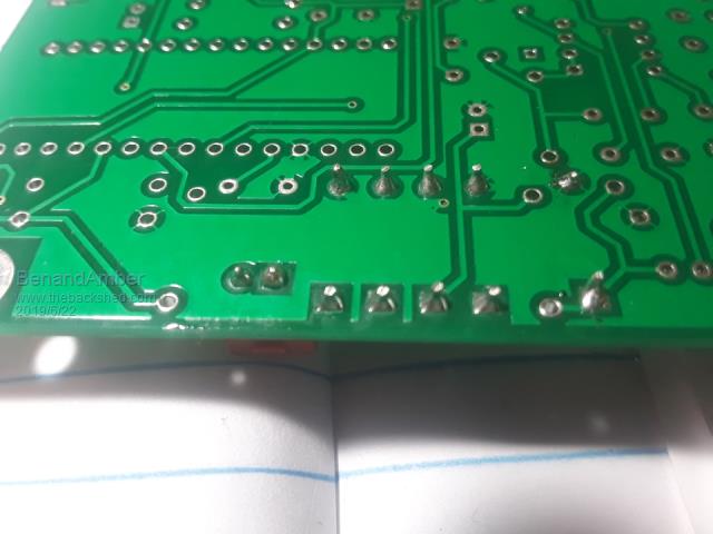

A few parts came in the mail just enough to be a tease
I used gold-plated pens from old computer parts to raise the dc-to-dc converter
the heatsinks i have for lm7812
would hit DC DC converter without using pens and tilting it a little toward 10 pin plug
If you look on the board in the pic you may noticed I didn't put the 4007 diodes in over by the mains sink part of the board
I was wondering if anybody knows if these are necessary since I won't be using the main sync function
By following poida the Greats Tips on how to solder this board
And my absolutely awesome homemade clear no headache great smelling high temperature cheap as peanuts liquid solder flux
I think I'm going to be okay
Notice I said Think!!!

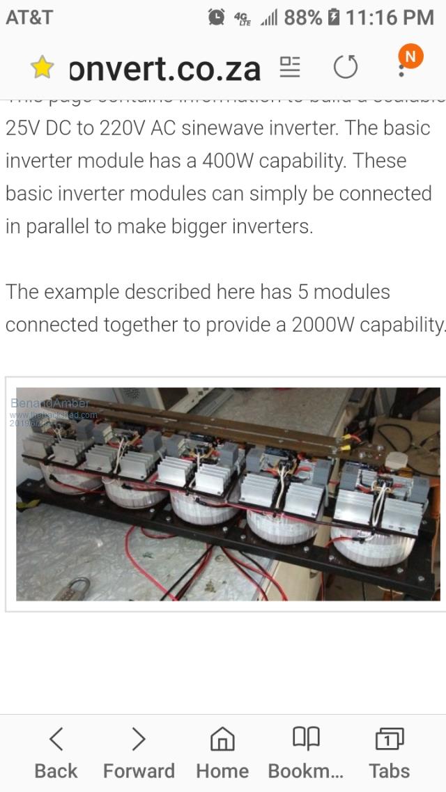

multi Transformer inverter http://evconvert.co.za/solar-panel-charging-station/inverter/
I ran across this very interesting inverter
thought I would share and see what you guys thought about itEdited by BenandAmber 2019-06-25
