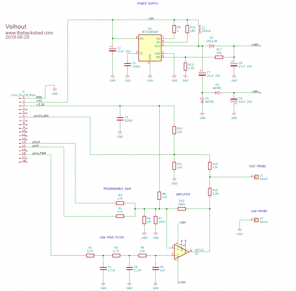

On the schematic R9 is shown as value 1E, what value should it be?
Trevor
Posts: 6146
Posted: 09:09am 23 Sep 2019
Hi TrevoH,
1E means 1 ohm

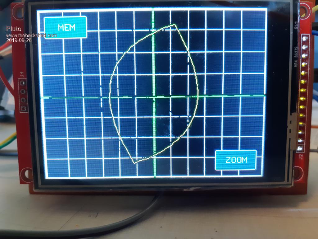

Thank you Volhout for the interesting project!
I had not heard about the Huntron Tracer before, but vhen I saw your project I got immediately interested and started to build the circuit on some stripboads. After some error corrections (my errors/not yours) I got it to function as expected. Some googling confirmed that the traces are as to be expected for various components.
I am using a 28pin MX170 with ILI9341 display. Did not have MC34063 so it was replaced by MC33063. likevise LM741 was replaced by UA741. All powerd from a CP2102 USB to TTL module.
I think it could be useful to have some kind of gridlines or grid dots and scales for x and y axis, e.g. for testing zener diodes. High accuracy for voltage and current would NOT be required. If part of the gridlines would be "erased" by the measurement traces, that would not be a problem (restart with refreshed gridlines is very fast). How difficult would it be to add gridlines and scales based on the information collected in the calibrations?
R16 is 3.9k (according to your correction earlier). R16 is the output resistance of the instrument. If a lower output resistance is required, is it simply to replace 3.9k by e.g. 1k? Suppose that R15 (47k) then also need to be changed?

  Volhout said  Hi TrevoH,
1E means 1 ohm
FWIW I thought it was the R operator for values less than 1k, as in 560R etc. 1.5 ohm would be 1R5.
After 1k we go to 5k6 for 5.6k, 560k 5m6 for 5.6 meg & so on.
Then again, I may be wrong...

Hi Pluto,
Your suggestion to lower the output impedance to 1k may work. I would change the 47k resistor to 51k to prevent overdriving the ADC (clipping).
There may be some effect for the power supply and opamp though.
The opamp output is +/- 14V roughly. With 1k output resistance that would be 14mA in case of a short circuit. I have not checked if the power supply can deliver this much power at +/- 16V. You may need bigger caps and diodes. And maybe need to change the 1 ohm to 0.5 ohm.
The MC33063 is fine. It has different temperature range, but for the rest is seems identical.

Horisontal grid approximately 2V per division and vertical about 1mA per div. in normal mode. About 1V/div in ZOOM mode (No decimals!)
This is in fact sufficient accuracy for me to get approximate zener voltages, LED voltages, etc.
Added just a few lines to Volhout's code in Sub draw_window :

Please note that the grids are gradually disappearing when curves are displayed over the grids. Fresh grids by restarting the program.
Thanks Volhout for an interesting instrument. Looking forward to see coming versions!

Your right about the standard notation of resistor values, thanks for sharing, however never seen such as 1E before,
wonder if this is a thing used in the Netherlands
Volhout???

Hi Pluto, TrevorH,
First of all, the 1E is something I don't know where I got this from.

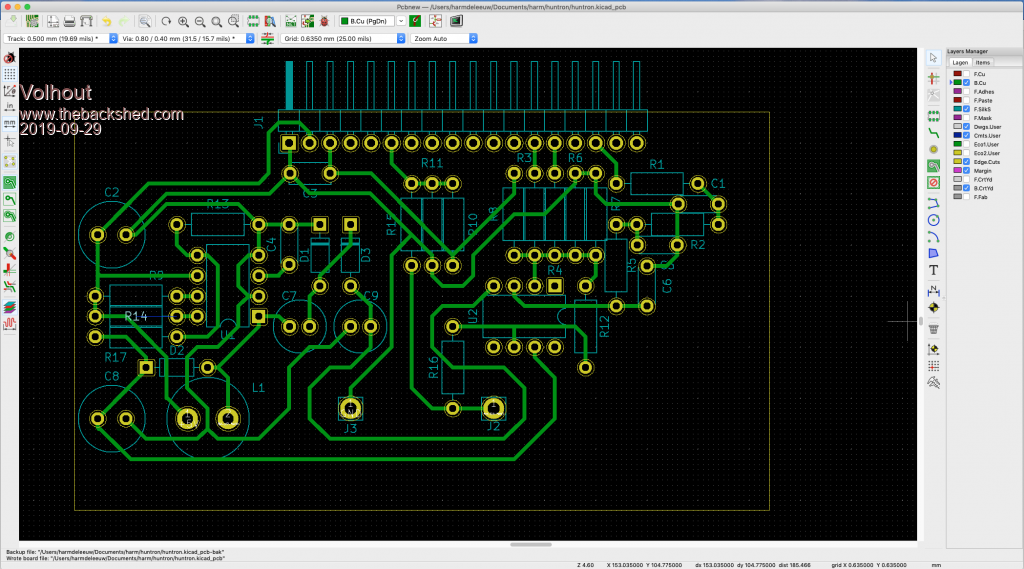

May have been a habit from one of my former jobs?

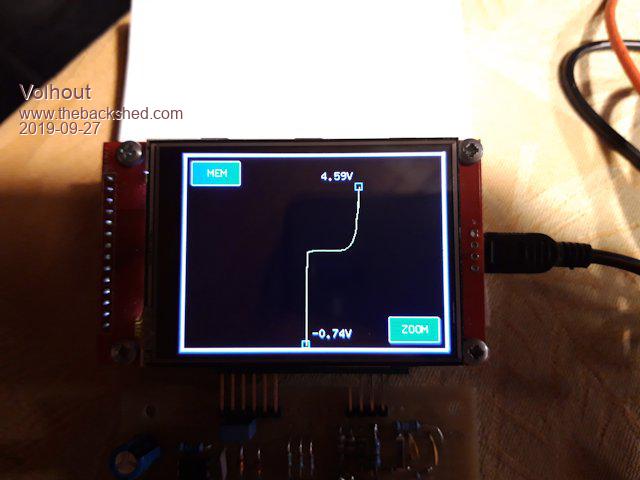

I planned this week to work on the board layout, but was triggered by the work done by Pluto to improve the software. So I spend some time behind the screen, and added dynamic measurements. Found that more accurate than a grid.
The measurement values are calculated from screen coordinates, and are therefore not as accurate as the ADC could do, but since we do relative measurements mainly, this seems accurate enough. Actually, it is so accurate that we may not need the zoom mode anymore....
Here a screen shot

Small project hardware update.
I noticed that the opamp LM741 runs close to saturation when driving -14V.
The LM741 was chosen because it has a max voltage rating of +/-22V. In our circuit t is powered from +16.2V/-15.3V which is safe. Can't use a +/-15V rated opamp though.
So I decided to increase the voltage from the power supply to +16.8V, and the negative voltage to -16.5V. This is done by following changes:
R17 changes to 15k
R13 changes to 1.2k
Diodes D1 and D3 change to small schottky diodes (BAT85 or 1N5819).
I will reflect these changes in an updated schematic later this week.
Another thing: I noticed that the LM741 and uA741 parts are basically obsolete. Prices at Farnell are up to 10 euro per piece. A good replacement would be the MC34071 or the TLE2141. These are available in DIL and have +/- 22V supply range (cost around a dollar). Haven't tested these part yet. If there is demand for this circuit beyond the 3 or 4 people involved now, I may redesign it to work with standard +/-15V opamps or use a discrete amplifier.
That's all folks....
Edited 2019-09-27 18:23 by Volhout

Pluto
Joined: 09/06/2017
Location: Finland
Posts: 412
Posted: 09:55am 27 Sep 2019
Hi Volhout,
I replaced the UA741 op-amp with TLE2141IP (+/-22V max supply).
Voltage output swing improved from 25.7V to 26.5V and the shape of the output wawe improved at the minimum output voltage; Became a sharper "V" with TLE2141.
TLE outputs are very equal for negative and positive outputs. Better than LM741.
I do not have MC34071 for testing.
The price of TLE2141 is $3.5/5pcs=$0.70/pcs from AliExpress. Same cost as MC34071.
Tested your new program version. I like it!
Thanks!
Posts: 6146
Posted: 11:16am 27 Sep 2019
Hi Pluto,
Thanks for testing the TLE2141. I was a bit worried about that one because it has much higher bandwidth.
I improved the program a bit more, it only draws the numeric values when they change.
It is easier on the eyes, the erasing and drawing of the text was visible and annoying to me.
The change is only in the time interrupt routine. I will only post that section here.

Posts: 6146
Posted: 08:43pm 27 Sep 2019
Hi zeitfest,
The original thread was the initial idea, where a voltage to voltage graph would be shown.
While studying the idea, i realized a voltage to current graph would be needed.
That threw overboard the initial plotting algorythm.
Numberwise, we are plotting 3 times 64 segments, 8 times per second in this version. That is 1500 segments per second.(lines).
The orinial thread did plot pixels, 640 of them 3 times per second, and erases as many, that is 3800 pixels per second.
Resolution in this version is lower, but it has a lot more functionality.
Actually, it is a working product in thi stage.

Posts: 6146
Posted: 04:24pm 28 Sep 2019
I updated the schematics, and show a layout proposal.
Happy prototyping
Edited 2019-09-29 02:25 by Volhout
