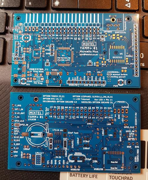

Well, I've put some boards on order so we'll see whether it works. :)
I had to order them. Somehow I had to get myself to stop modifying the thing to squeeze more onto it. lol Things I wish I'd included: a piezo speaker for key click and stereo audio output. Still, they'd have used I/O pins so could only have had optional connections.
The routing hasn't been too bad really. I think I read somewhere that 90% of the routing is in the laying out of the components, not finding the routes. I think that's probably true. The autorouter was fun at first, and gave me some valuable clues as to where to position components, but I wasn't happy with the routes it produced. They just weren't "pretty" enough in some way. As I'm retired and doing this strictly as a hobby - and to learn how to use a PCB design package - I've had no time restraints so manual routing was fine.
I'm considering a companion board for the other end of the ribbon cable now. Using a 24vDC supply, with monitored output relays, opto-isoated digital inputs, a couple of non-isolated 4-20mA/0-10vDC analogue inputs - all the fun of the fair if you like PLCs. :) Maybe a little PIC chip as an external watchdog too. We'll see....  :)

Nice board Mixtel90 - couple of comments if I may -
The horizontal connector you use could be positioned a bit closer to the edge of the board, even poking out beyond the edge (purists may not like this but space is space     ) - this would free up some board space for other stuff.
I like like your comment re "Topsy" - I used to know it as "The Engineers Curse - creeping elegance!"
Finally, I think it is generally regarded as polite, good practice to put a "Micromite & MMBasic Copyright Geoff Graham" somewhere on the board.

Well, the PCBs have turned up at last!
You know when you make a mistake it should always be a big one? This one is a beaut! I've only gone & put the microSD socket on wrong way round...
Oh well, the touch display SD socket should still be fine so these boards should be ok with that limitation. We'll see when I manage to get one built up.

Things are moving on. Slowly. Still collecting parts to build up the first of the YAMM+ 01 boards. I've not been wasting time though, having built a vacuum pick-up tool and done a little more SMD soldering practice.
I mentioned a second PCB at the beginning of the month. Well, I have a sort of design for one now. It's intended as a local IO board for small industrial control. Tentative name is YAMM+ 02, as it's basically part of the same system. A lot of this is still in the "ideas" stage when it comes to software, especially the watchdog function. That would be written in GCBasic as I'm proposing an 8-pin PIC to save on board space.
* Powered from 24VDC. Contains regulation down to 5VDC. Gets 3.3VDC from the ribbon.
* Connects to YAMM+ 01 via a 30-way ribbon (It appears that 16+16-way plugs are like unicorn poo to get hold of).
* 5off 240VAC rated output relays (powered at 24V), 4 SPNO, 1 SPCO. All can be monitored using a nc second contact (used internally - not wired out).
* 2off 24VDC opto-isolated, unfiltered PWM outputs. Can also be used as active high DC outputs.
* 8off 24VDC opto-isolated digital inputs with LED indication. Split into 2 banks of 4, each bank can be wired active high or active low. By changing input resistors they could be different voltages too - just to confuse people. :)
* PIC Watchdog, using a single pulsed-low bi-directional line in the ribbon. Mosfet to disconnect all relay supplies on watchdog fault.
* Watchdog chip also monitors 24VDC supply voltage.
* Opto-isolated 24VDC "High" output on healthy signal from watchdog. LED indication of "Healthy" status.
* SPI is available on 5-pin header with +5V and GND.
* RS-485 is available on 6-pin header. A link on the header enables 120R terminator.
* ICSP header for playing with the watchdog software.
* PCB size fits standard DIN rail modular mounts from OKW. I've also pushed the size almost to the limit for the free version of Eagle at 7920sq mm. :)
There may still be problems. I'm not sure what current the YAMM+ 01 will draw yet, so the heatsinks on the regulators may be too small. (Pre-reg down to 15V then reg down to 5V. Not enough space for a switcher. :( ). It will have to feed the 2.8" TFT display as I've used the other IO pins. lol
The SPNO contacts are because of electrical clearance problems with the NC contact. I could make all the relays SPCO at 30VDC max.
I'd like to have included some analogue inputs but I ran out of space and IO pins. That might be for YAMM+ 03, which would probably plug into the SPI and sit alongside this module. :)
The schematic and PCB design is more or less done now. I'll probably tweak a few things yet.

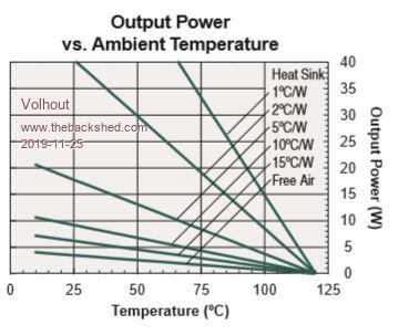

Hmmmmmm ... solid state switches have come a long way.
I need to power a total of 10 120 vac water pumps in my geothermal heat pump system ranging from 1/20 Hp to 1/6 Hp or roughly 40 W to 125 W. (TACO 006 through 013 or similiar.)
I was planning on using mechanical relays but the IXYS CPC 1998 opto coupled ac power switch is available from DigiKey for less than $8.00 singly.
These pumps exhibit a very low starting inrush current for an induction motor due to the loose coupled centrifugal impeller and volute structure.
Do you guys have any thoughts about driving the CPC 1998 from a micro and what type of heat sink would be suitable to cool it? I anticipate that the pumps will cycle ON/OFF perhaps 10 times an hour.

Hi Paul,
The question about using the CPC1998 directly driven from a microcontroller and what heatsink can only be answered if you specify the operating temperature range at location where the CPC1998 is located.
The part can operate from -40C to +85C but parameters change with temperature.
If you can drive the LED with 5mA or more you should be fine, but for 10 that is 10 x 5mA directly from microcontroller IO pins.
Then the heatsink: the specified voltage across the CPC1998 is roughly 1V at current around 1A. The 125W/110Vac pump would therefore cause a dissipation of roughly 1.25 watt in the CPC1998. With sufficient air flow that could work without a heatsink at room temperature.
But if your pump should work at 55 degrees C, with 10 of these switches in a little box, each dissipating 1.25watt, the temperature inside the box could be well of 100 degrees C.
Total dissipation of the 10 switches, if all on, is around 10 watt.
With a small fan that could be done without heatsinking. just place these switched 1/2" appart in a row, and let the fan flow some air between the CPC's.
If silence is required, you may have to revert to an ALU block like old audio amplifiers use.

5A continuous with no heat sink and 20A continuous with heat sink.
Heat sinking is covered under "Thermal Management" where they also recommend a particular product.
They are also zero-volt switching which means that they don't switch until the AC sine wave crosses 0v.

I doubt if you'd have any problem with those at all.
Driving them is identical to driving a LED at 5mA or so - just a suitable resistor from a micro. PIC chips usually handle up to 20-25mA from a single output and will usually source or sink a total of over 100mA so that's probably ok. The LED drops about 1.27V. For something like this I like to put an ordinary red LED in series with the input and use a common resistor. It gives a nice "on" indication when you can't see contacts move and is plenty bright enough at 5mA. :)
I think you could probably regard those pumps as almost a resistive load as they are very "lossy". At 120VAC you're probably only drawing a bit over an amp for the 125W rating. The CPC 1998 can handle 5A without a heatsink, so if you fancied putting even a small one on they should be fine. Volt drop is about 1.1V, so even with 1.5A load (even if they had a lousy power factor - it's probably more like 1.2A) it's only dissipating 1.65W in the junction. The thermal resistance is 33C/W to air so that's a temperature rise of 55W above ambient with no heatsink with 1.5A load. Hot to touch, but not dangerous and you shouldn't get that high anyway.

Mixtel90 is right. But please understand that 10 of these CPC's may generate a lot of heat. 16 watt requires a big box with ventilation slots, just to get rid of the heat when ambient temperatures rise to 40C on a summer day.

Hmmm... I should have thought of the combined heat output really. I don't know what the ambient is either or how many of what size pumps will run at the same time or how close together the CPCs would be mounted. All these have an effect.
