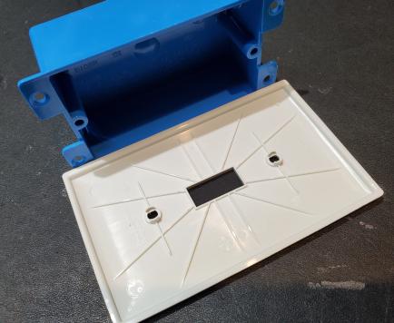

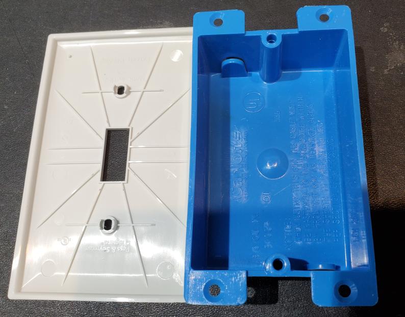

Quazee137
Joined: 07/08/2016
Posts: 603
Posted: 11:54am 02 Mar 2020
https://grabcad.com/library/light-switch-plate-1
May have to make an account. I did awhile back look at enclosures for projects.
in 3D you have a measure tool.
I packed up my measuring tools and don't know which box.    There are so many.
Later I'll take a pic and drag it in to a few programs with on screen measuring tools.
Been a busy time getting Dr appointments and lab test done before the move.
All new medical to setup once I'm moved in.

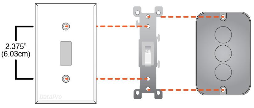

CircuitGizmos
Joined: 08/09/2011
Posts: 1427
Posted: 05:18pm 02 Mar 2020

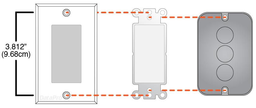

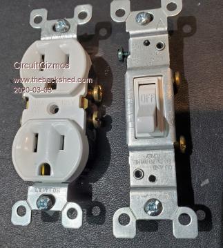

  Quazee137 said
This plate covers the box and the edge of the wall around it, so the board itself would have to be smaller than just the plate. That is a toggle switch plate (as opposed to an outlet plate) and the screws pictured attach the plate to the switch NOT the box. Without the switch there, the screws would touch nothing.
The better plate to design for would be the blank wall plate. Those screws go into the box.
The U.S. setup suffers from the momentum of history. A standard wall box and plate with either a switch or outlet sandwiched between does its job for mains uses, but isn't pretty to design a circuit card for.
Note the switch plate is larger than the box. The holes on the plate would line up with the switch, not the box.
More to note: The blue box is a shallow box. Regular boxes are deeper.
The tabs that you see on this blue box are not standard. There are all sorts of variations.
Outlet and switch. The screws that you see captive in each are a standard didstance apart. The plates attach to the outlet and switch in different ways/places.
From left to right: Toggle switch plate, outlet, blank, and "Decora". The blank plate is the only one where the holes line up with the box as it is used to cover empty boxes.
There are also plates with RJ type phone jacks, coax, etc.
Edited 2020-03-03 03:30 by CircuitGizmos

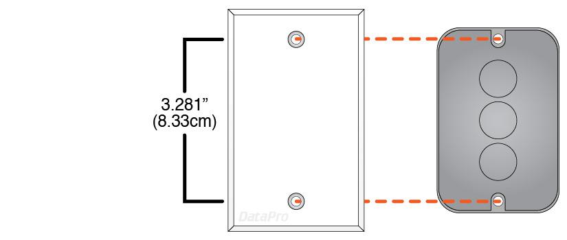

Posts: 10056
Posted: 12:24am 03 Mar 2020
What's the distance between the holes on the American BLANK wall-plate?
The PDL blank plate here has its holes 84mm apart for the machine screws, but there are two other holes for screwing the plate directly onto a wall to cover a hole etc, and they are 100mm apart.
I don't expect I would be that lucky, that either of those dimensions would agree with the American blank wall-plate would I?
Quazee137
Joined: 07/08/2016
Posts: 603
Posted: 03:30am 03 Mar 2020
Here We go
I think that covers it.
Posts: 10056
Posted: 04:56am 03 Mar 2020
Wow!
0.7mm difference between the American and Australian/New Zealand plates' machine screw holes!  That would probably mean that the PDL plate would mount on the American flush-box and vise-versa!  Perhaps not a PERFECT fit, but it would fit with perhaps a little coaxing.

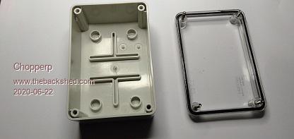

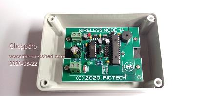

Posted: 08:03am 22 Jun 2020
FYI

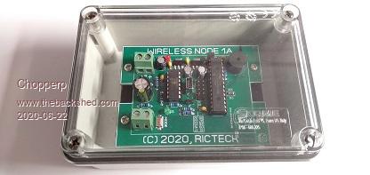

Grogs managed to get my order away the other week. Took over 2 weeks to get here though. Just over the ditch
I went looking for some blanking plates today but couldn't find the specified ones. All to narrow.
Still got to check out Bunnings who one electrical place said should have them.

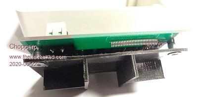

I did manage to spot a reasonable looking case with a clear top & bought one.
It had some interesting looking 8mm deep x 2mm wide slots in the bottom for mounting so I assumed so I made up a 3D printed board thingy to fit it.
That worked after a couple of much smaller test runs. Fitted nice & snugly.
I then thought about how to actually mount the module. My standoffs were buried somewhere then I thought that maybe I could use 3mm rivnuts (nutserts) fitted up the other way.
I tried that idea & it worked. I did split the plastic on the first hole I did. Too much pressure. Rest OK.
Some piccies below.
BTW, the module itself is nice piece of kit. Maybe just needs dab of hot glue on the end of the antenna.
Yet to use it in anger.
Brian
