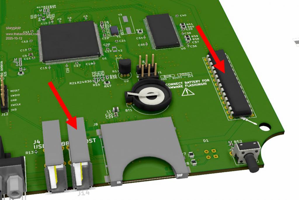

Posted: 12:40pm 12 Oct 2020
I added mouse port, on PCB there will be DIP socket. Anyone who needs a mouse can buy the DIP-28 chip from Hoppy Electronic and install it.
3d i2c is used (PB7 - SDA3, PH11 - SCL3)
Posts: 11913
Posted: 12:49pm 12 Oct 2020
You need to add the supporting circuitry - xtal etc
