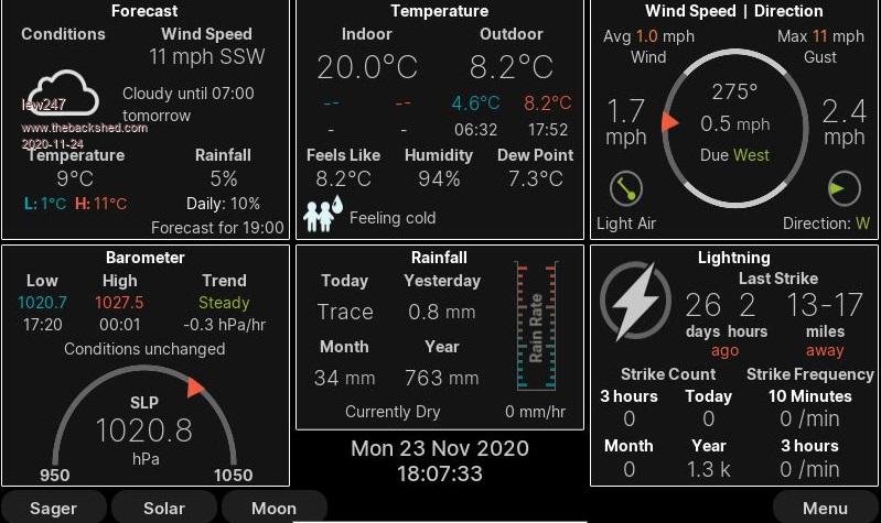

This is the main program
and it's for this
I'm trying to extract some of the values to send to a Micromite to drive a stepper motor based gauge on the wall to display physically some of the elements like outdoor and indoor temp and so on
I added the SI7021.py module myself and the python code to get it working as I don't have a second Weatherflow air sensor to use for the indoor temperatures
I cannot use circuitpython because python is already installed and used by the main program

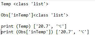

I think I found the issue
I used class to find out what class and both Temp and Obs['inTemp'] are lists
If I print them I get the following
Now to try and figure out how to convert lists to bytes

if I try this
  print(Temp)
  Temp = Temp[0].encode()
  print(Temp)
I get
Edited 2020-11-24 06:38 by lew247

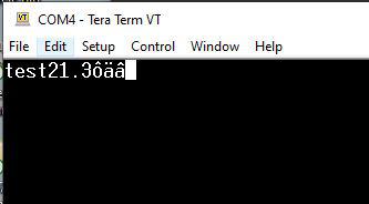

It sends the word test via the serial port but I then get
2020-11-24 10:11:20+0000 [-]     ser.write(strInTemp.encode('ASCII'))
2020-11-24 10:11:20+0000 [-] UnicodeEncodeError: 'ascii' codec can't encode character '\u2103' in position 4: ordinal not in range(128)
If I use ser.write(strInTemp.encode()) instead of ser.write(strInTemp.encode('ASCII'))
it works
but sends this
and if I add a comma to seperate the values I still get the garbage instead of item 2
strInTemp = Obs['inTemp'][0] + "," + Obs['inTemp'][1]
returns
The issue is character U+2103 the degree symbol
Is there a way to strip the symbol out so it's not sent?
