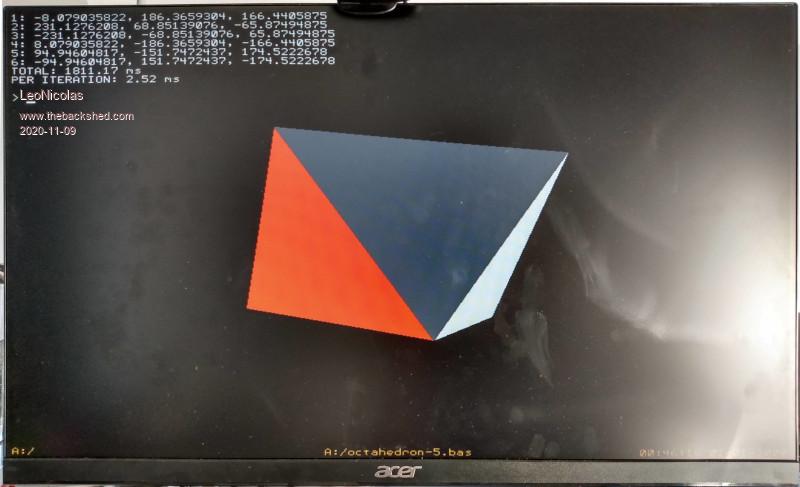

Posted: 11:38pm 08 Nov 2020
My last optimized code is running in 1811.17 ms without page copy.
With page copy is running in 5358.88 ms.
My octahedron end position, after 720 iterations, is not the same as the initial position. I'm using rotation matrices with the given angles. They are being applied in the correct order (X,Y,Z).
I'm starting the timer in the first line of the program, before all initialization phase.
I'm still optimizing the code. Let's try to gain some ms
Peter M., how will we share the code with you?
Video of the code without page copy:
https://youtu.be/vgUnrGQTpMg
Video of the code with page copy: https://youtu.be/gVie6pOZOFo

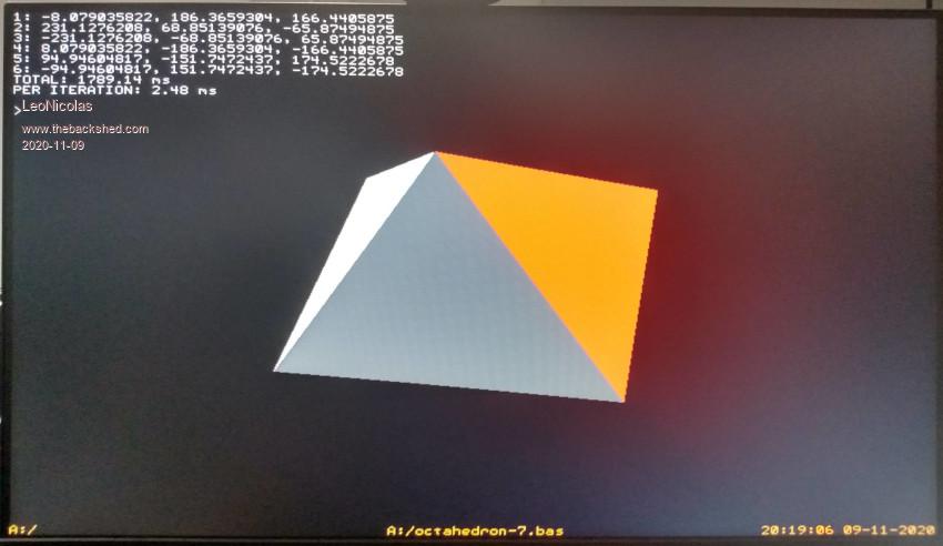

Posted: 04:41am 09 Nov 2020
After my last optimization, I reached 1789ms
I'm doing my best but @Pete your time is awesome.
Probably I can improve the 2D projection code, maybe I can gain some ms.
Edited 2020-11-09 15:05 by LeoNicolas
