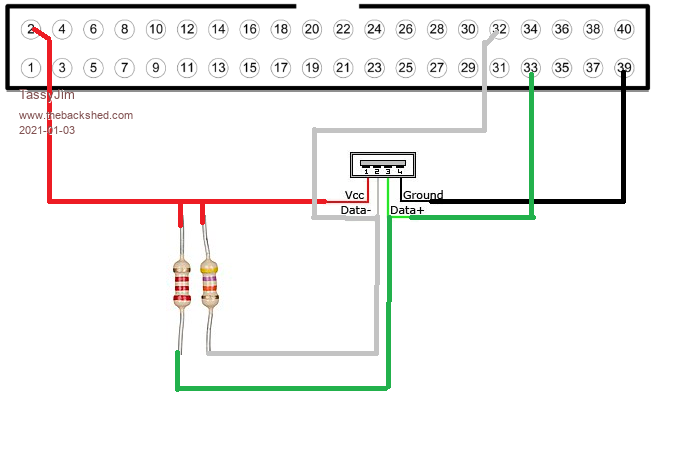

  TassyJim said  If you are using a USB mouse, there is no need for the adapter.
I was thinking of making a cable with both the USB port and the PS/2 port on it.  Then you could plug in either type that would work.  Would that be doable without me killing my CMM2. I think that would be the best cable to make if it is safe. Could you make a diagram of that kind of cable? I am still gun-shy about connecting anything to the GPIO. Thanks Jim.

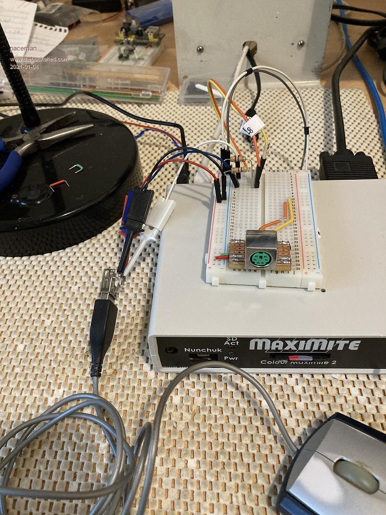

paceman
Joined: 07/10/2011
Posts: 1329
Posted: 01:16pm 03 Jan 2021
Just connected my 10 year old Porto optical USB mouse up as per Jim's diagram (no adapter) and it worked first go - I'm amazed how clever I am!    Peter's test program came up with my mouse as a Type 3, whatever that means, and it's working fine in the file manager and editor.
My only regret is there's not much point now posting a photo of my little PS2 breadboard adapter that took me about a full day to make - it's so neat too.
Thanks Peter and Jim for all this effort.

CircuitGizmos
Joined: 08/09/2011
Posts: 1427
Posted: 04:26pm 03 Jan 2021
  paceman said  My only regret is there's not much point now posting a photo of my little PS2 breadboard adapter that took me about a full day to make - it's so neat too.
I'm formally requesting that you post a photo of your PS2 breadboard adapter because of said "neatness". You made it with pride - post a picture to share!

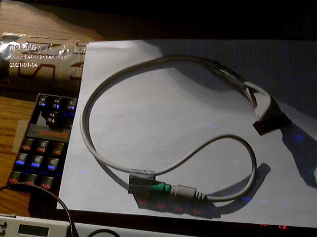

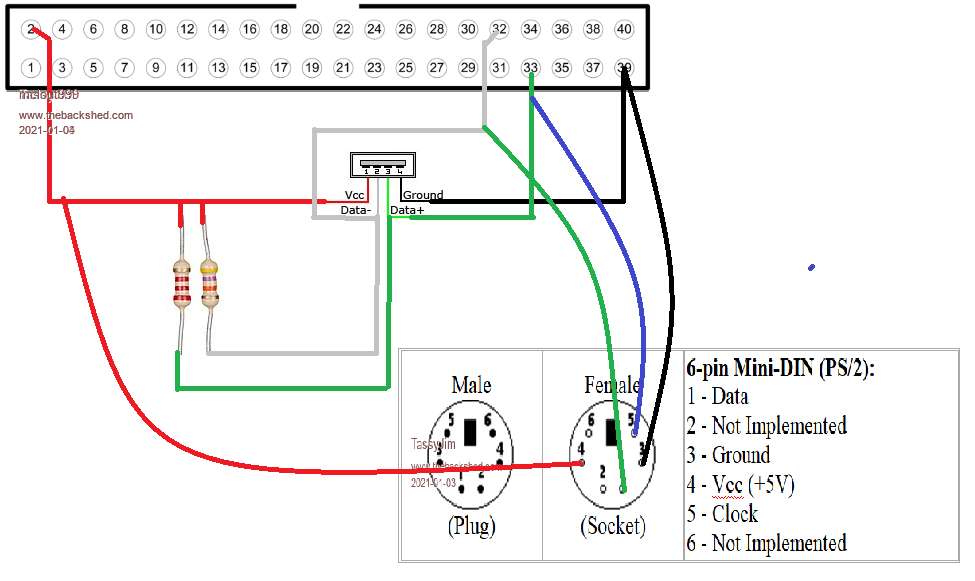

mclout999
Joined: 05/07/2020
Posts: 531
Posted: 05:08pm 03 Jan 2021
Hi.  I am trying to figure out how to make a cable with both connectors here is what I have so far.  Please advise.
Would this work and be a safe interphase.  I like the idea of being able to directly plug in the USB/PS/2 mice OR the strictly PS/2 mice with one cable.  I would appreciate the verification before I make the thing.  Thanks.
Posts: 6638
Posted: 07:53pm 03 Jan 2021
  Quote    I am trying to figure out how to make a cable with both connectors here is what I have so far.  Please advise.
Yes that would work. PS/2 is slow so there shouldn't be any issues with reflections from the open unterminated socket.
I had considered doing the same but decided that one socket and an adapter prevents accidentally plugging both in at the same time.
Edited 2021-01-04 05:53 by TassyJim
mclout999
Joined: 05/07/2020
Posts: 531
Posted: 08:36pm 03 Jan 2021
  Quote  PS/2 is slow so there shouldn't be any issues with reflections from the open unterminated socket.
 Is there anything I can do to fix that issue? I thought about the issue of duel plugins but I think it is worth it to have a universal cable for all my Mice.  Thanks.

toml_12953
Joined: 13/02/2015
Posts: 740
Posted: 02:28am 04 Jan 2021
  mclout999 said
  Quote  If you are using a USB mouse, there is no need for the adapter.
This one kind of confuses me.  If you are using a USB mouse don't you need the HT USB host or am I missing somthing?
Jim, You make the best wiring diagrams but can you give one with the proper connections to the PS/2 female port.  Thanks.
If you have a USB mouse, use the diagram posted in this thread. You don't need the PS/2 port at all. All you need is a USB breakout, two resistors and some wire. That eliminates compatibility problems with some USB mouse - PS/2 adapter combinations.

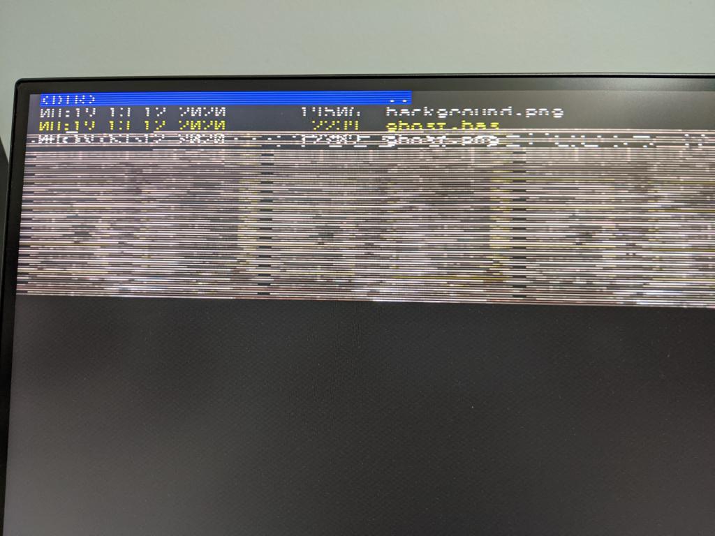

Rado
Joined: 27/11/2020
Location: Croatia
Posts: 59
Posted: 10:23am 04 Jan 2021
Does anyone else have graphical glitches with new beta firmware, or is it my CMM2 playing tricks on me? I have odd artefacts with graphics demos in Welcome tape, and the main menu does not work - I can't select any menu item as neither cursors or numbers do work. The keyboard works Ok in other cases.
https://youtu.be/YUvrn-p9PO8
Posts: 12172
Posted: 10:41am 04 Jan 2021
There is a problem that seems to be related specifically to the way the welcome code works. Let me know if you see the same in any simpler program as that would help locate the issue
Rado
Joined: 27/11/2020
Location: Croatia
Posts: 59
Posted: 10:49am 04 Jan 2021
For the keyboard issue, I have it only with Welcome tape 0.5.1. I'll check some other software later on and report (IIRC, ran some games and they were fine, but let me double check and more thoroughly).

paceman
Joined: 07/10/2011
Posts: 1329
Posted: 11:13am 04 Jan 2021
Thanks CG, here it is, along with the USB connections sans adapter. Now to make them neat!
Greg

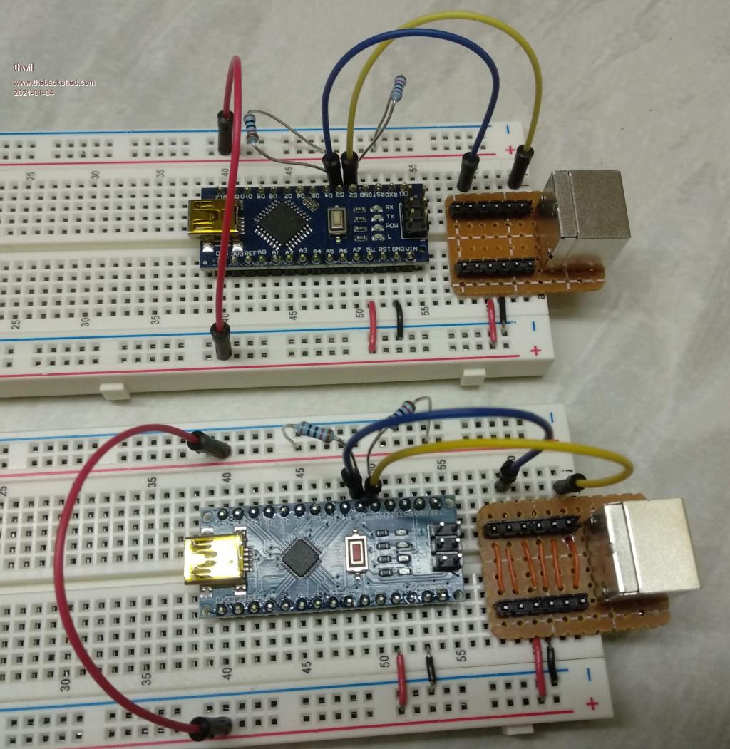

Posts: 4410
Posted: 11:35am 04 Jan 2021
Nice.
I felt much the same pang of regret:
... though looking at the underside magnified to such an extent I'm less pleased with my soldering now.
