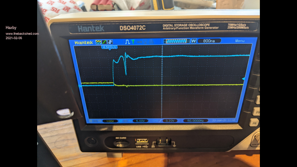

Posted: 07:43pm 05 Feb 2021
"CRO is not fast enough to see clearly the switching edges"
That's your next step right there. You need to see what's going on, otherwise you will be changing MOSFETs forever. Don't give up!
I had some really funky stuff going on where the gate to collector capacitance was causing havoc. Without the scope I would be blind to this. That's the voltage trace on the gate below.
Also while newer MOSFETs and IGBTs are designed to switch on faster, the drawback is that the faster rise and fall times make the (seemingly small) gate to collector capacitance more significant, and in my case, the bounce got the igbt into the conducting region.
Further, with the oscilloscope, I found that one of my gate driver ICs was a bit faulty. The on time was fine, but the off time was taking a long time.
I had tested it on its own, driving a resistor, and it appeared to work, but I subsequently found the problem in-circuit when it was loaded with the capacitance of the gate of the igbt.
All this stuff became very visible with the oscilloscope.
