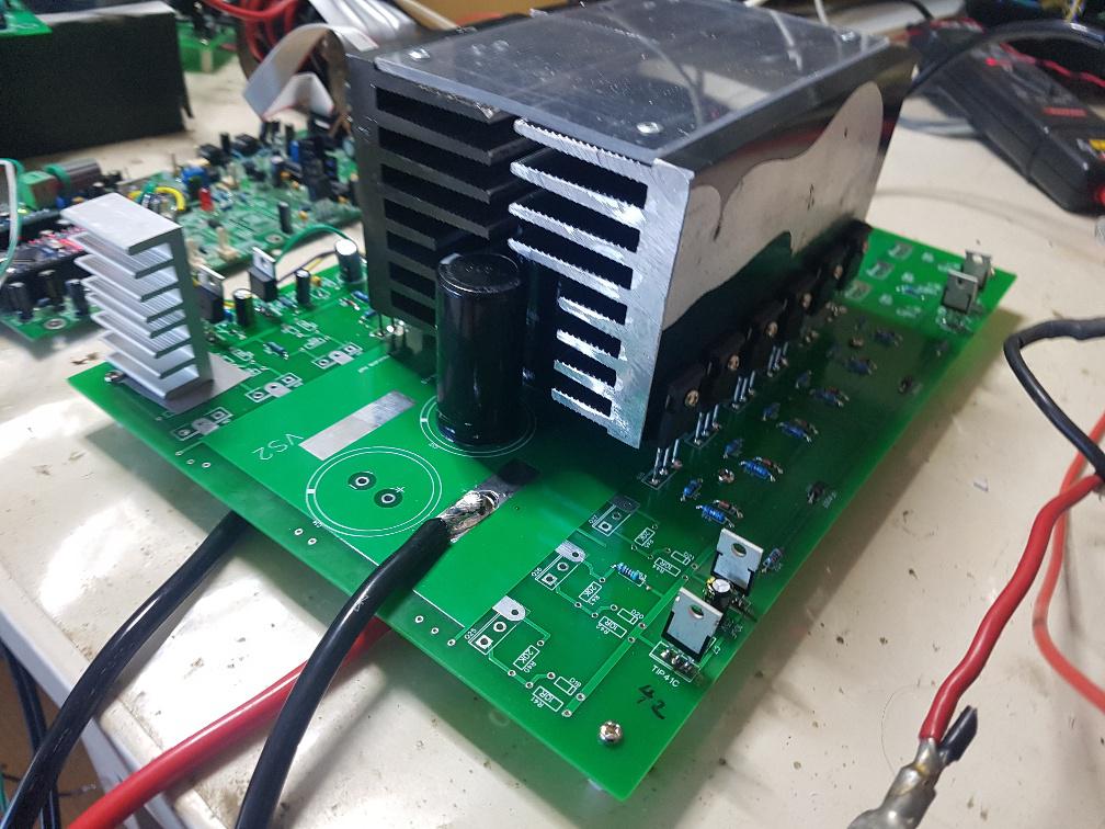

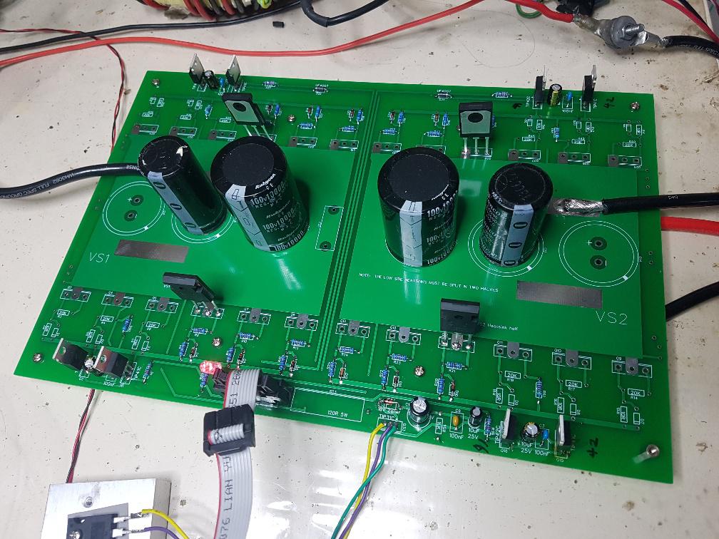

I believe I have achieved lift off.
The power board PCB design is done.
I want to provide a complete home built battery based solar power system for all.
All PCB files will be compatible with EasyEDA.
All firmware runs on Arduino hardware and within it's IDE.
All open source.
Just testing at the moment.

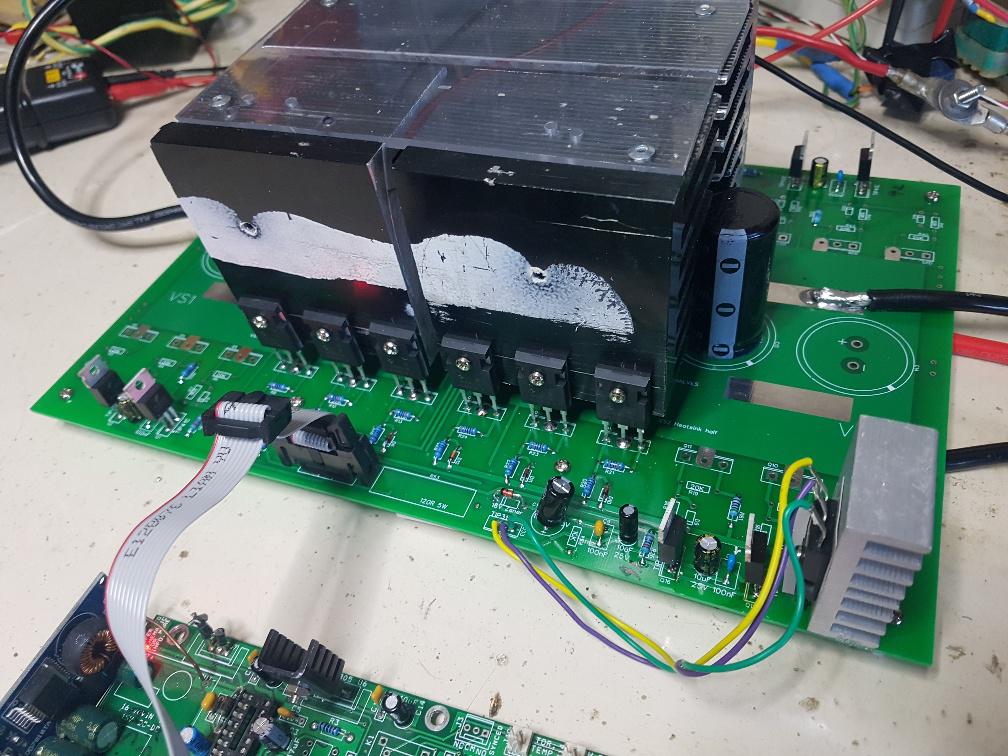

Tomorrow I fit 3 x 4 FETS and heat sinks, the install in the
victim inverter and then start the air compressor.
It will either work or not.

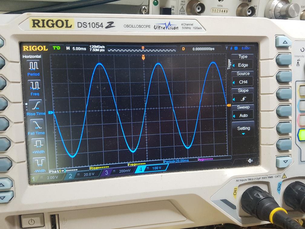

Here is the output voltage with zero load. A nice sine wave.
One error in the PCB tracks and 4 errors in the PCB silk screen.
Not too bad for a first go at a 6kW power board.
I can't complain.

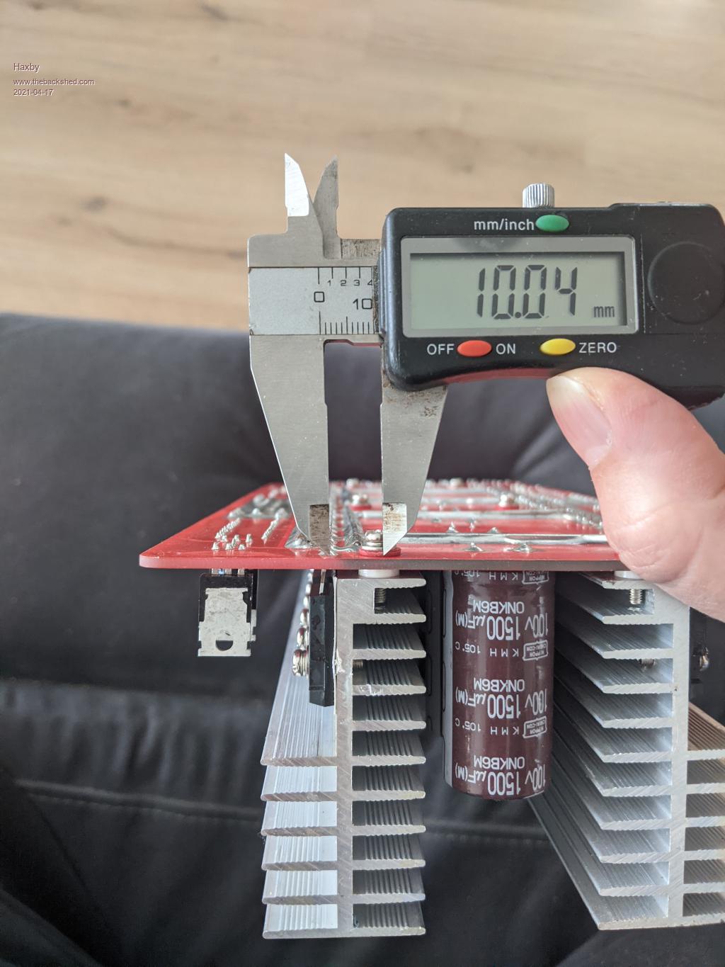

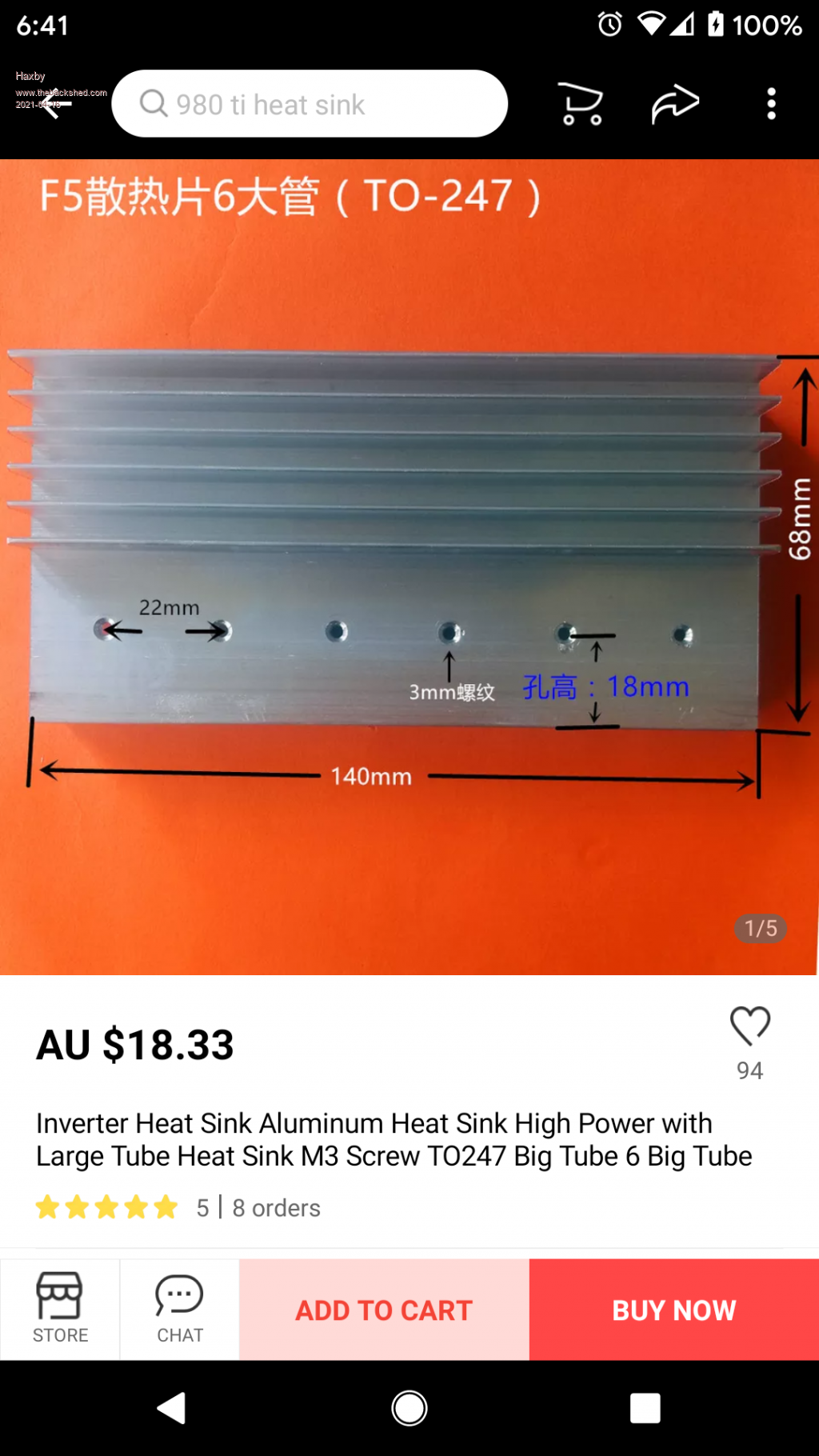

If you are spinning another board, I'd suggest putting holes in the PCB for mounting the heatsinks.
With my warp power board, I made it compatible with this pre-drilled TO247 heatsink from Ali express. The dimensions are all in the product description and it saved a lot of work. Even better when it all lined up nicely. The spacing of each MOSFET on mine is 22mm. But there are others to choose from.

  poida said  the FET spacing is 24.5mm. This is to allow those of us who have used
Madness's boards to reuse the heat sinks.
Ok never mind the MOSFET spacing. Heatsink mounting holes in the PCB are always a good idea though especially if you are still in the first version of the board. If you put some conveniently spaced 3.3mm holes 10mm north of the centre of the MOSFET pads then other builders will be able to have a choice of heatsink mounting options. If you choose the 10mm dimension then it will suit a popular heatsink profile that many Chinese inverters use.

The power board has been tested to start the air compressor.
11kW peak power for 1/4 second.
It passed easily.
3 FETS on the 4 legs of the full bridge.
No RC snubbers fitted yet. (I want to see the difference
they make, if any)
2 x 10,000uF 100V and 2 x 3900uF 80V caps on the DC supply rail.
This is not enough but good enough for me.
Errors fixed on the PCB already so we are ready to go.
I will do further testing then post the PCB files.
And basic build information for the inverter.

Many people on this forum seem to be copying the power board layout from the Chinese with regard to placing the big capacitors *inside* the heat sink where they get nice and hot and might have a shorter life.
A simple solution is to place them on the underside of the PCB which also has the advantage of more heatsink fin area.
I have long ago adopted the 'power capacitors on the other side' approach for my mosfet power boards. I also make these boards as two identical half bridges which has the advantage of smaller, cheaper boards, getting away with 1oz copper PCB's and a more flexible way of mounting the boards on both ends of the heat sink.
I write this as a suggestion for anybody who likes to lay out their own PCB, not as a criticism for your work.
