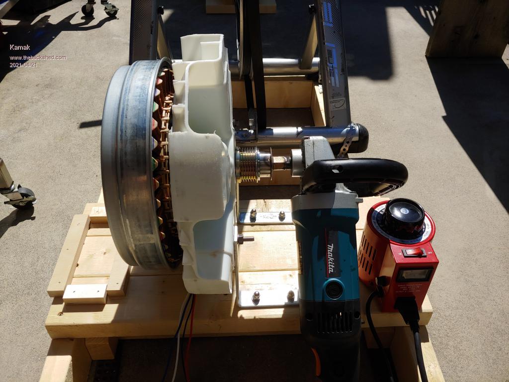

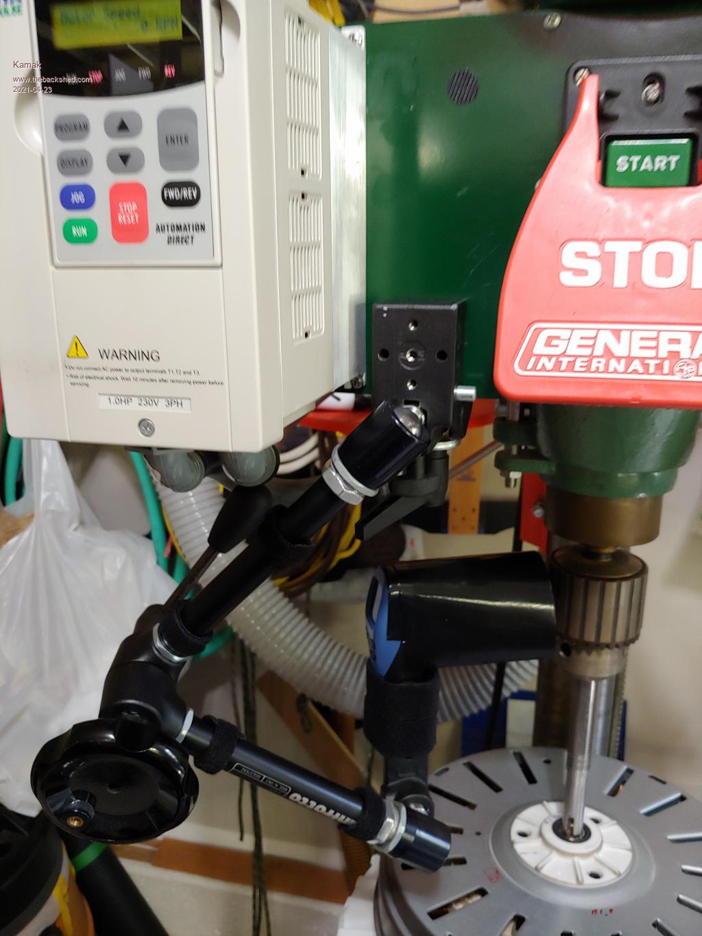

A new method of steady-state measurable RPM.
Kamak
Joined: 13/04/2021
Posts: 150
Posted: 12:32am 21 Apr 2021

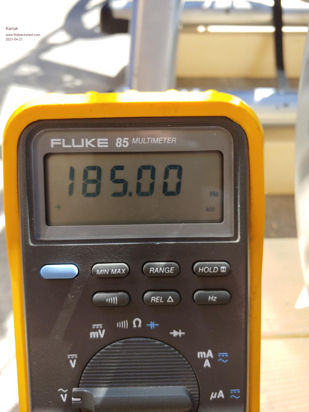

185hz = 462.5 rpm
185/24 pole pairs x 60sec. = 462.5rpm

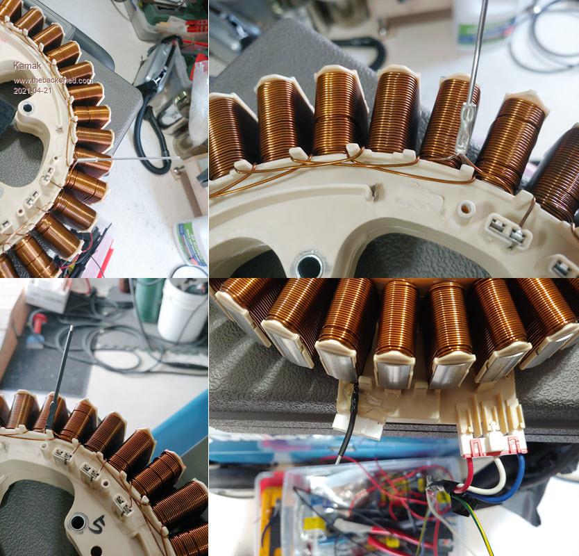

Crimped on a common point connection.

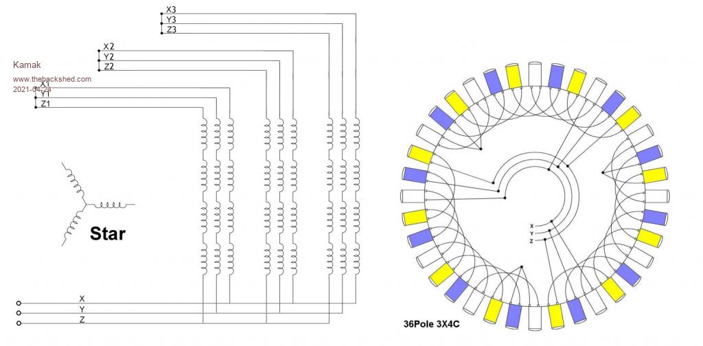

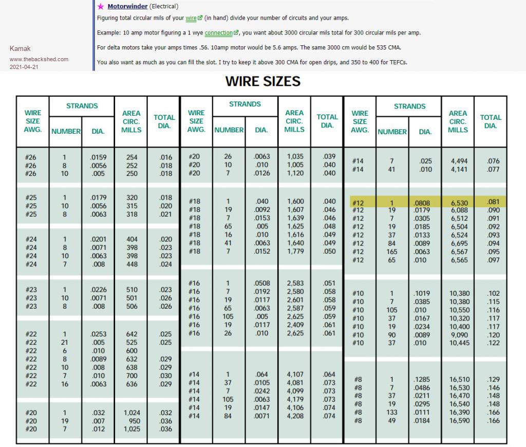

Selecting Wire Size for a 50A Star wound 3PH Generator
Using a good rule of thumb of 300-400 CMA (I'll use 400) per Amp
Approx 16A per single star leg?
16 x 400 = 6400CMA
from the chart, 6400CMA is close to a 12gauge single strand wire with 6500CMA.
Edited 2021-04-22 06:12 by Kamak

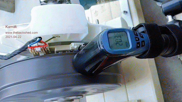

Posted: 08:38pm 21 Apr 2021

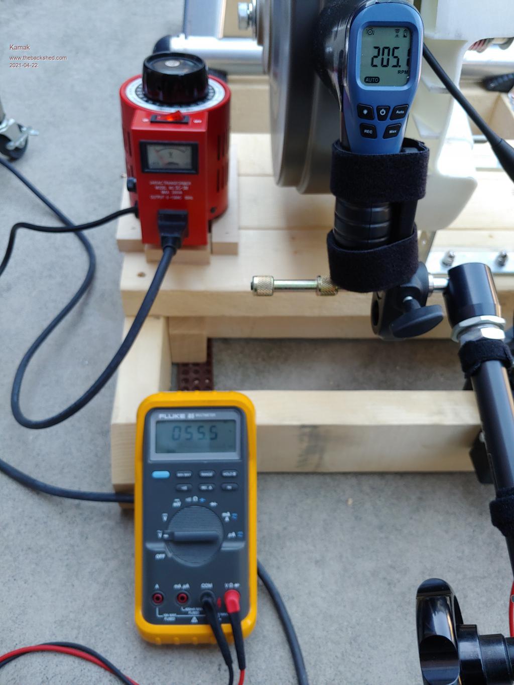

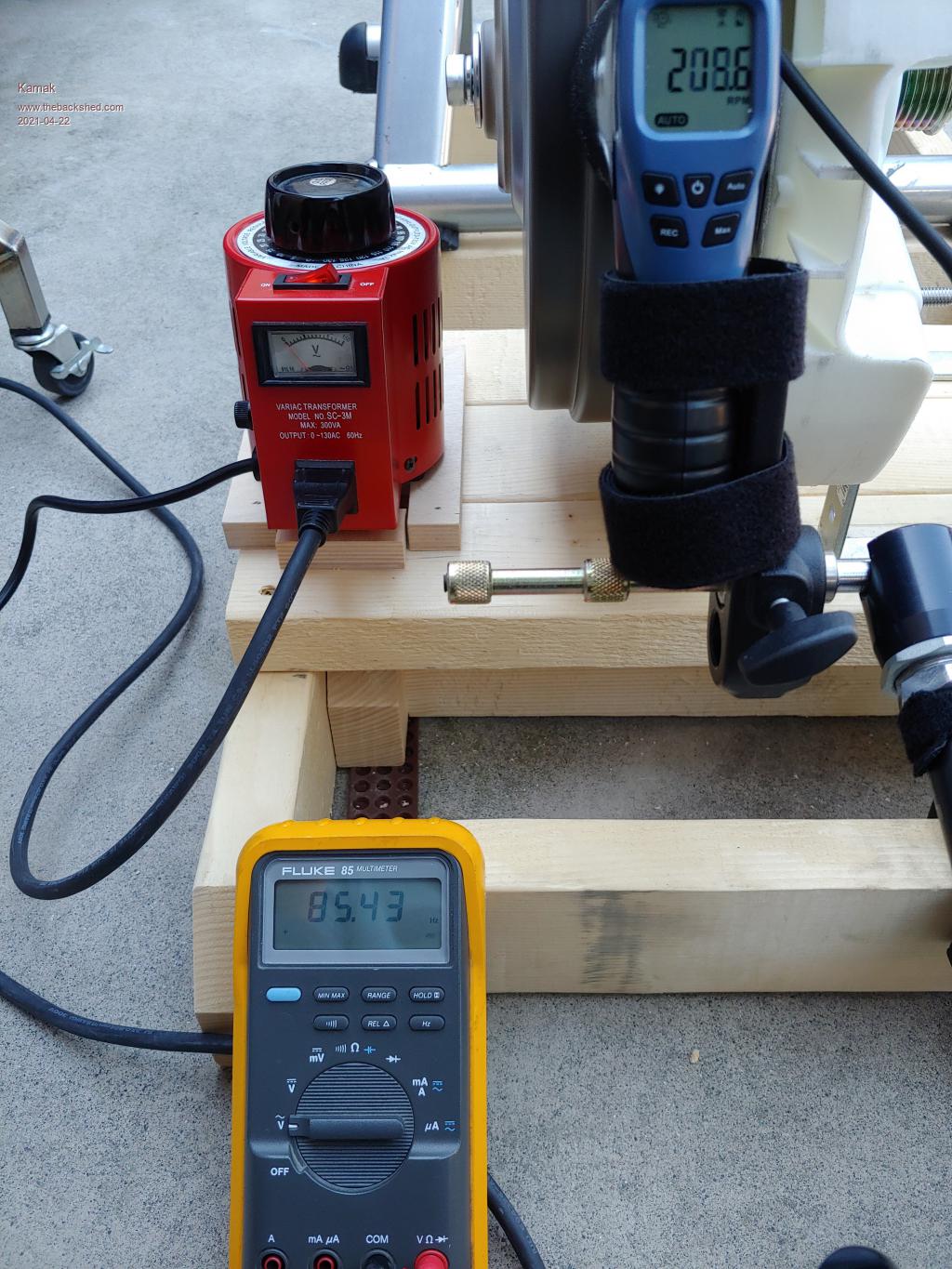

confirmation of RPM through two methods of measurement. Digital tachometer and electrical AC frequency.
Approximations due to fluctuating loads.
Tachometer reading of 205/209.6 RPM
A voltage reading of 55.5V DC
A frequency reading of 85.4Hz
85.4 Hz(cps)/24 N|Spc x 60 spm = 213.5 rpm
cps(cycles per sec), N|Spc (pole pairs per cycle), spm (sec per minute)

Kamak
Joined: 13/04/2021
Posts: 150
Posted: 07:45pm 22 Apr 2021

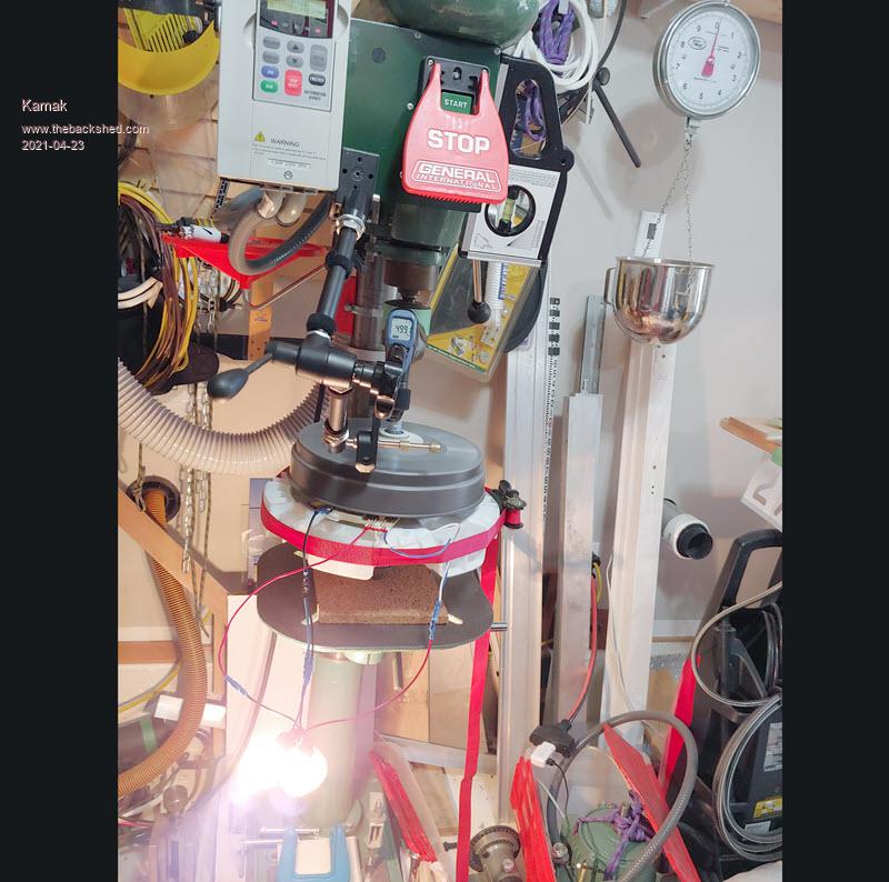

Better Test Bed
Edited 2021-04-23 05:47 by Kamak

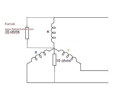

Kamak
Joined: 13/04/2021
Posts: 150
Posted: 01:08am 23 Apr 2021
Stock rotor/stator: (10ohm loads(100W incandescent bulbs), 120V, 0.919A)x2, 500 rpm, 110W(x2),Single phase ea @ 220W total. I could put another bulb on leg 3, I just didn't have one. So 330W @500rpm could be done.
Obviously, I need to increase the magnetic flux density. This needs to be 800W at 200rpm.
I have a 2 ohm, 750W resistor coming, and the 3 phase rectifier. Waiting, waiting, waiting...

Selecting Wire Size for a 50A Star wound 3PH Generator (even if it could achieve this) @ 24V @1200W
Approx 16A per single star leg? 50/3 = 16.66
16.66 x 400 = 6664CMA
from the chart, 6664CMA is close to a 12gauge single strand wire with 6500CMA.
But....
50A Star wound 3PH Generator @1200W (even if it could achieve this) @ 48V @1200W
That would be 25A
For a (3x4C)3, that's 9 parallel legs @ approx. 2.3A per leg.
2.3 x 400 = 920CMA
from the chart, 920CMA is close to 20 gauge (0.03196inch 0.8118mm) single strand wire with 1024CMA.
But if I select for the worst-case scenario, with 1200W @12V that would be 100A
For a (3x4C)3, that's 9 parallel legs @ approx. 11.11A per leg.
11.11 x 400 = 4400CMA
from the chart, 6530CMA is the nearest single strand wire to 4400CMA which is 12gauge (0.08081inch 2.053mm).
That's much higher than 4400CMA, but it's the nearest. standard gauge single strand size "above" the CMA requirement. There would be no worries about voltage drop or heating using it for 12V service.
(3x4C)3 @48V is approx 150 RPM (from the F&P chart)? Unknown for a Samsung BLDC Generator with changed-out magnets and rewired with the proper gauge copper wire.

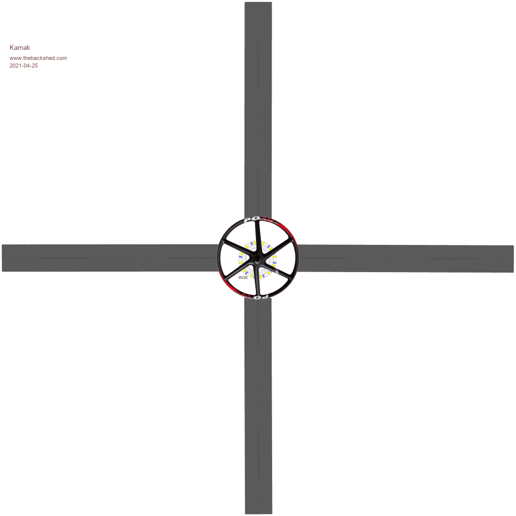

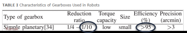

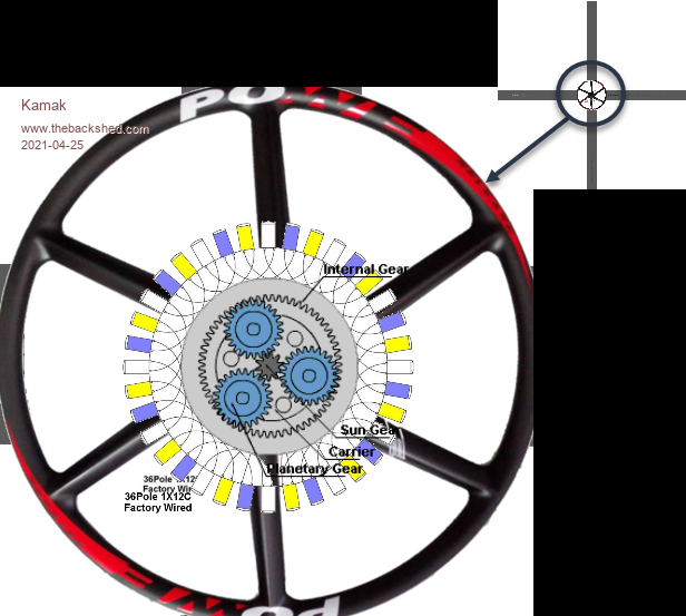

Posted: 07:01pm 24 Apr 2021
Back driving the planetary gearbox using the RING gear is possible, all be it with higher torque requirement, but possible with the right sized turbine blade lengths, combined with the larger diameter Blade-Hub (ie. a 29" bike rim)
10:1 Ratio = 100rpm Blade-hub:1000rpm Rotor
Edited 2021-04-25 05:28 by Kamak
