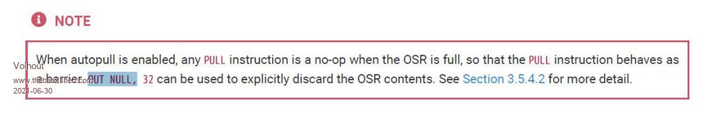

out null,32 won't assemble as there are only 5 data bits.
Posts: 5978
Posted: 06:34am 30 Jun 2021
Hi Mixtel90,
I am impressed, you took up the glove, and are really making the whole compiler !! Great work, and thank you !!!
About out null,32:
So you shift out 32 bits from the OSR, basically clearing the OSR.
P.S. While reading though the sequencer instruction set, I get scared. You can write really confusing code using this set. You can interpret data in the shift registers as instruction, or as direct jump address. So you can write a sequence that reads serial data in the ISR, passes it to the OSR, and executes it..... scary...
I guess next years programming challenge will be to write the most obfuscated program for the PIO sequencer on the picomite....

At the moment I'm simply taking strings from the data statements and converting them into 16-bit words for the RP2040 to process. Unless it's something that I can do that with I'm a bit stuck. That's why I've been thinking of it as an assembler. A compiler would probably be the high level PIO commands that Peter's doing.
I should have seen that - probably got too bog-eyed. lol In this case It's easy enough, I can encode 32 as &b00000 easily enough, but I can't (at the moment) handle stuff like .wrap as that's a directive that does something that isn't a command as such (it's a backward jump, but you can't assemble it as that because it's much faster). I've no directives at the moment and no idea how to implement them. I couldn't activate autopull if it had a big on-off switch on it. :)
Yep - this thing is seriously scary. :)  Even the concept of 4 state machines independently working from the same 32-byte memory is a little bit scary...
