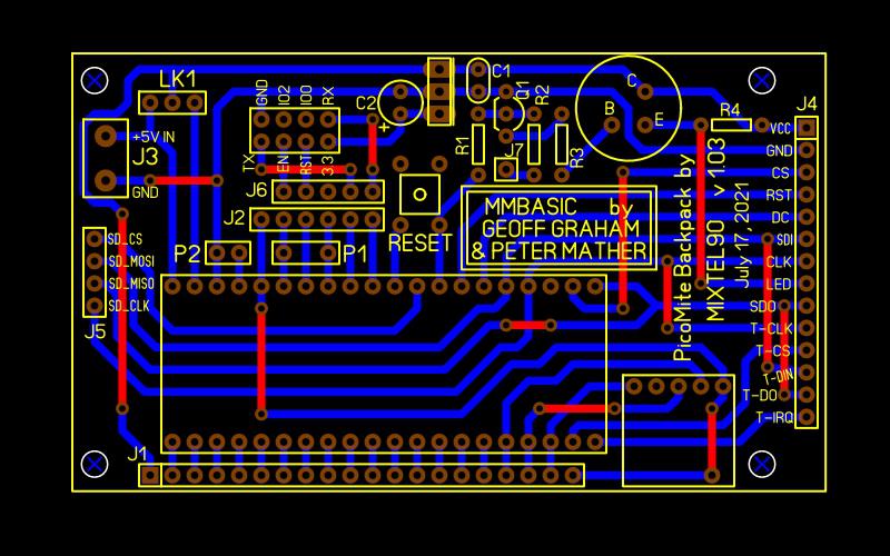

V1.03:
changes:
Capacitors C1 and C2 relabeled,
Speaker redrawn as 12mm
R4 shifted for more space
J7 labeled
Vreg reversed left/right
Pad/drill sizes juggled here and there slightly.
Can you confirm the Pico pin spacing is .700 inch?
Also, where is J7 likely to be connected to? Easy to run traces now...
Posts: 9245
Posted: 05:49pm 17 Jul 2021
The official drawing for the Pico gives 17.78mm. By some curious coincidence that works out at bang on 0.7". :)
I left J7 disconnected as it may not be needed at all and would only be using a pin unnecessarily. Additionally, I'd used all the IO pins on that side of the Pico and single-sided routing from the other side would have been a pain.
For non-square waves it would go to a PWM pin. I *think* it would be on any free IO pin for GUI BEEP but I've never used that. If someone wanted to they could connect an off-board 5V relay with parallel diode to the drain of Q1 and +5 and get a clean contact out instead of using it for sound. :)  I think leaving it free gives maximum flexibility.
If you consider it a good idea to put a pin close to J7 (a 2-pin link might be a good idea) then I think I'd suggest GP11 (PWM5B). It's in a logical position on the circuit diagram and is probably one of the easiest to route on the PCB.
Pin spacing on C1 could be 0.1" or 0.2", but it's not something I generally worry about. It's easier to jam a 0.2" cap into a 0.1" pcb than the other way round. :)

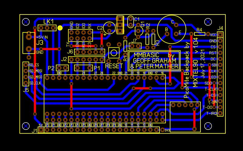

V1.04:
J7 can be jumpered to GP26 - PWM5A,
More labelling,

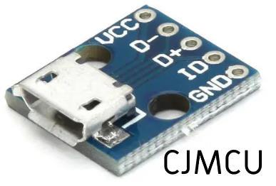

Extra pads around J3 so that a CJMCU USB jack fits.
Posts: 9245
Posted: 08:28pm 17 Jul 2021
That's fine. The mosfet could be wire jumpered to somewhere else if the ADCs are wanted.
I've not used the CJMCU before. Neat option if it will fit. :)

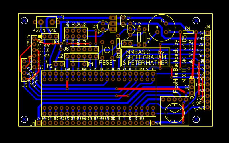

V1.05:
J3 pushed around to top edge to make room for alternate uSD card, as linked previously, (CJMCU USB jack goes underneath now)
Voltage on J1-1 selectable with LK2 (near clock module),
Most traces reduced to 24 mil width, except for main power traces. Board could still be fabbed as single sided with jumper wires, except for "ALT uSD",
Both sides of Pico have spare row of pads for custom butchering, er, customizing,
Pins IO0 and IO2 of ESP8266 access pads added, in case someone needs 'em,
Silly graphic added to real-time clock footprint ;-)

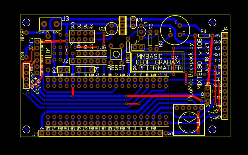

I'm drawing this with Sprint Layout.
Note about board size:
As drawn, the board is 50x86mm, which exactly matches the ILI9341 module on my desk. Stretching the board to 100mm wide with a 'sea of holes' (or maybe just a 'small pond of holes') would still allow 2 boards per 100x100mm cheap PCB offer from various board houses.
V1.06:
I think I understand the change requests:
LNK1 is gone, D1 sort of in its place,
J7 moved to GP28, which is AN2, I think,
A bunch of extra pads beside D1, some 5V, some GND, one 3V3, plus 3 isolated.
Posts: 6198
Posted: 06:15am 19 Jul 2021
Swap C an E at the backlight transistor footprint
Posts: 9245
Posted: 06:58am 19 Jul 2021
Yep, that looks right. I didn't think there was space to get a track from J7 to GP28. Neat job! :)  LK2 could be LK1 now.

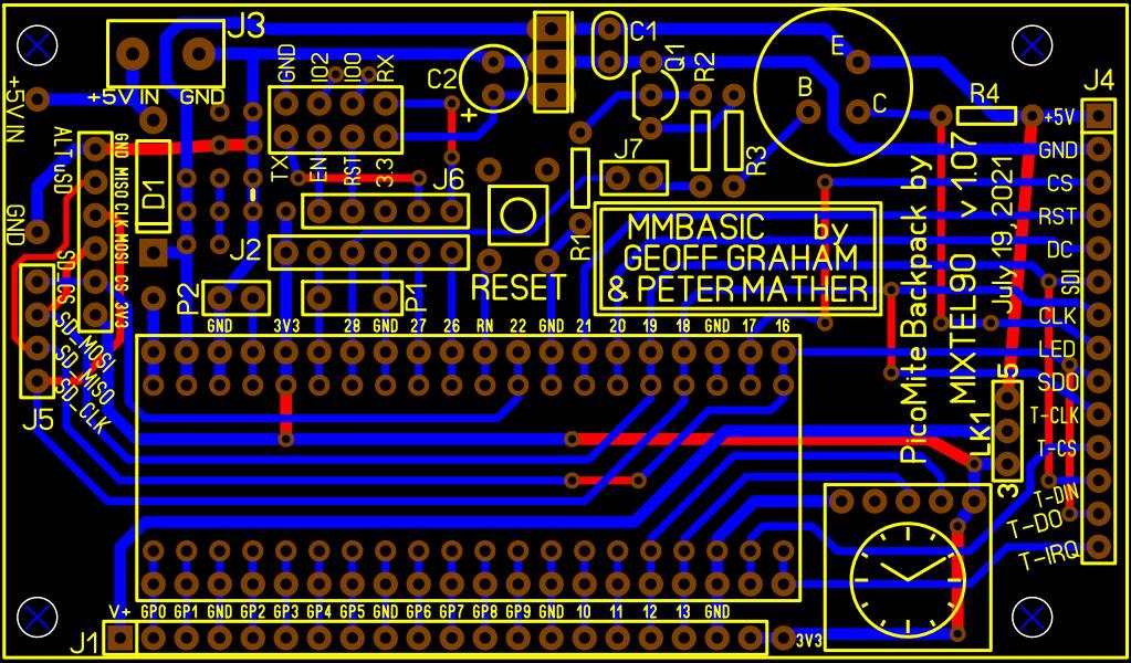

V1.07:
LNK2 renamed to LNK1,
E & C reversed
Bit more trace clearance from J7 to GP28
Fixed trace to T-CLK  (got disconnected)
