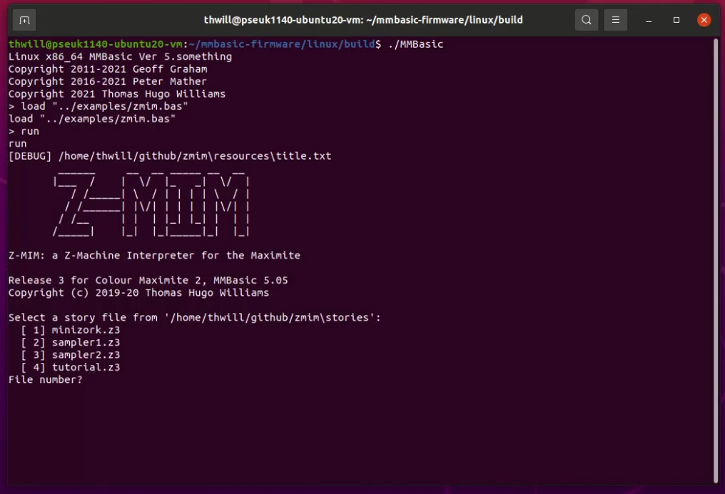

Hi folks,
I've spoken with Geoff and received his blessing, so assuming Peter raises no objections to me cribbing from his code all systems are go; so far it's not even proving all that difficult as in most cases Geoff's DOS/Windows code just needs a little nudge and elsewhere Peter's CMM2 code also basically "just works".
I've already got Z-MIM working and that's relatively demanding of the MMBasic language ... it won't work on the DOS/Windows version for a start.
Video:
   https://www.youtube.com/watch?v=Mfcxq_whYpE
Screenshot:
The observant will note:
1. When I type a command into the MMBasic prompt it is being echoed back, that's because to get something running quickly I'm still using the terminal in "cooked" mode.
2. At the end of the video you can see that the MMBasic timer isn't working properly; it's not really taking 2 seconds per Z-machine instruction.
Tom.

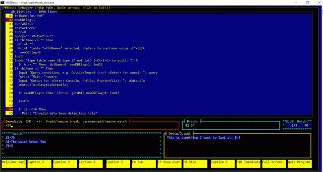

Do you have any interest in an MMBasic debugger? I have working, but incomplete, code for DOS MMBasic which has shifted to a back burner. It takes about 6 lines of code added to Geoff's code for hooks (in addition to the C code for the debugger itself). I'd be happy to give you the code.
It has helped to find some deeply hidden MMBasic bugs in my code. It has single-stepping, breakpoints, and display of variable values (but not thoroughly worked out for variables in subroutines). Next on my list for it was break-on-value. Geoff approved of its development.
The debugger outputs via serial to another PC (or, in theory, to the same PC, though I haven't tested that).
(Then the question would be, how readily can the linux version be transferred back to DOS.) (And bearing in mind the desire not to have forks.)

  lizby said  Do you have any interest in an MMBasic debugger?
Hi @lizby, it's not that I'm disinterested, but my plate is thoroughly overflowing at the moment. Get back to me if/when I have 64 and 32 bit Linux ports of MMBasic "published".
  Quote  (Then the question would be, how readily can the linux version be transferred back to DOS.) (And bearing in mind the desire not to have forks.)
Once I have the Linux version beaten into submission I don't think a back port to "DOS" would be too difficult. However as above, it and any surrounding discussion as to the desirability can definitely wait.
