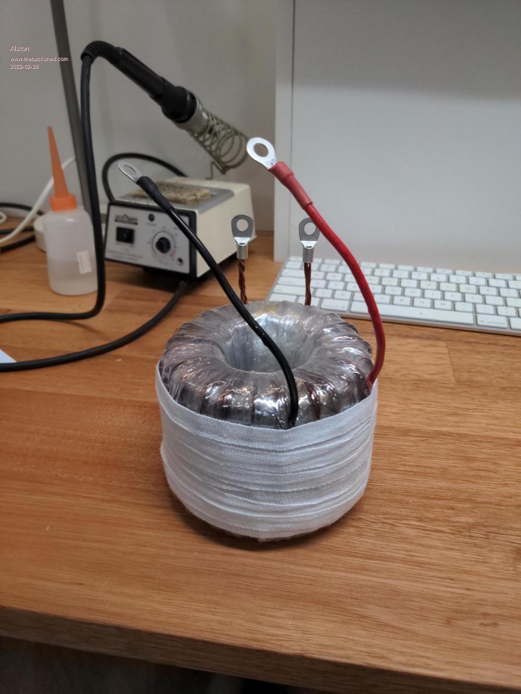

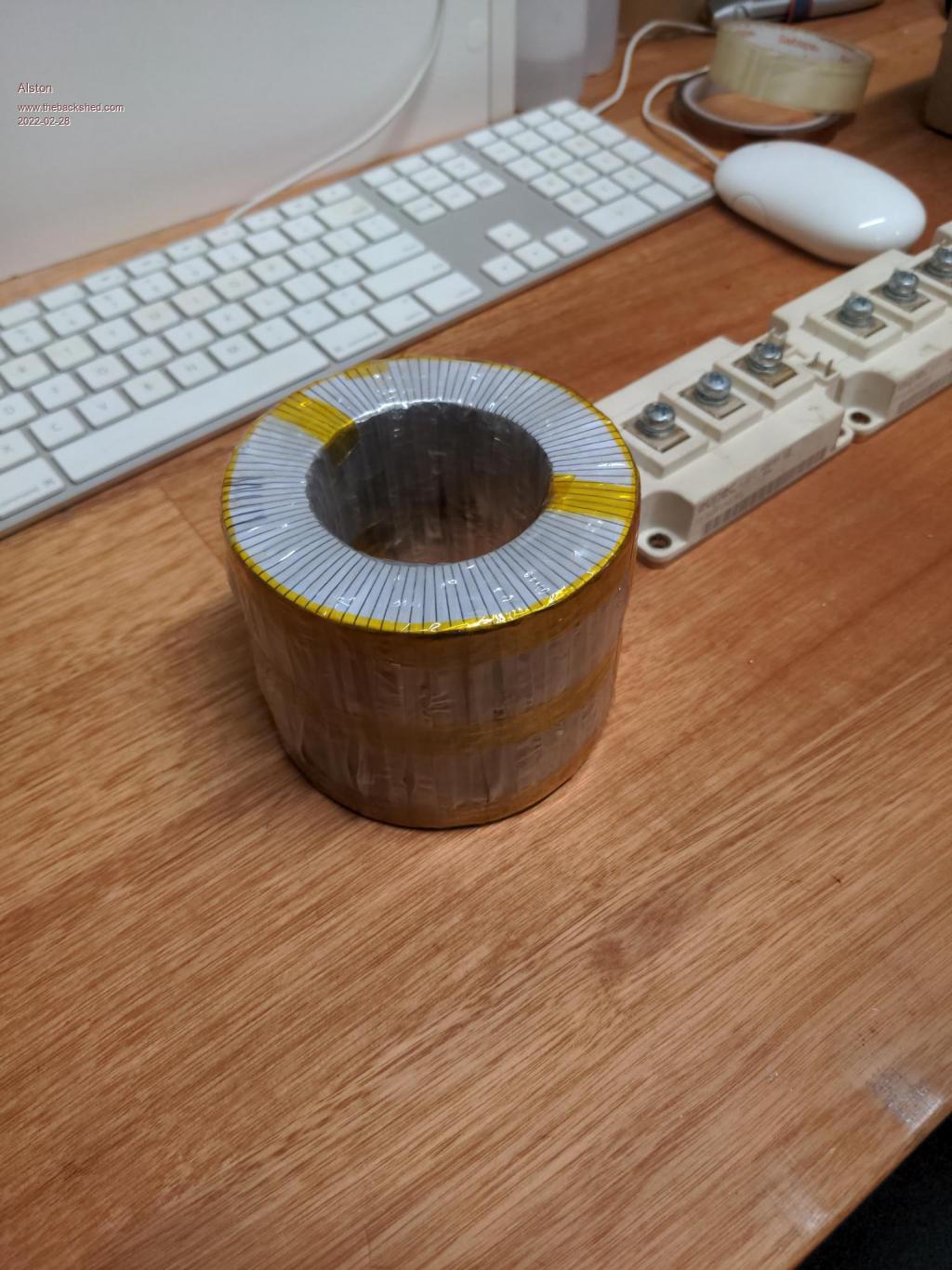

Well after having a paid project come up I am back to winding transformers. I have finished transformer 4 aside from coating the fabric tape on the outside with epoxy. To start with I printed out templates for my primary windings and stuck those on the ends which made life much easier. Although Klaus warned me about the difficulties with using standard high current cable for the secondary I still had to try it myself to see how calculations and the real world don't line up. I was able to use all of the 1.3mm wire that I unwound and twisted it like Klaus to make my secondary which worked nicely.

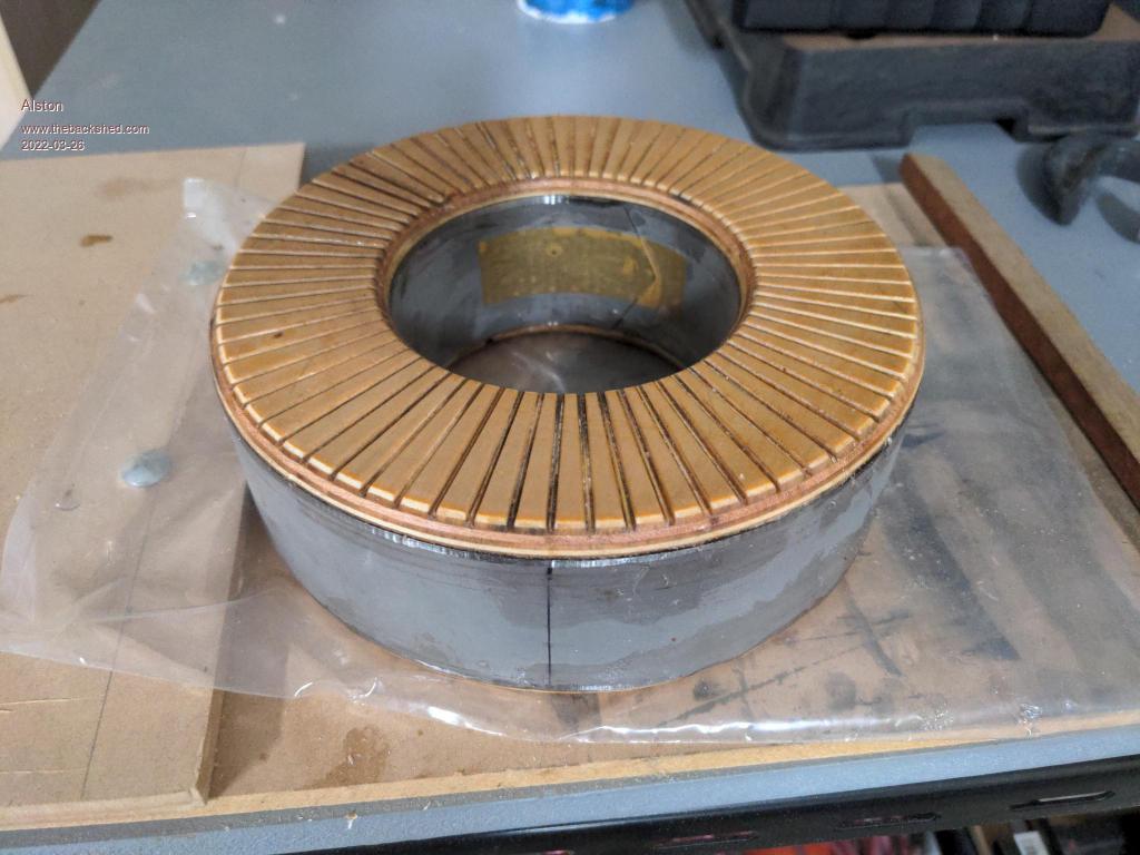

After looking at Roger's recent post with his incredibly wound transformers I was given an idea to use my CNC machine to cut the template onto the plywood endcaps. I have made the end cap for transformer number 2 which I will now start winding. I really need to find out where Klaus got his better quality plywood from as the stuff Bunnings has is junk, it doesn't machine very cleanly.

Hi Alston, looks great.
Plywood comes in better quality at a price. Marine grade ply would probably be better, but it is more expensive.
Other than that using some fibreglass sheet ( used in large electric motor winding and former manufacture) would be even better.
I don't know how hot your transformer core would get, I have thermostats in my inverters that turn on the fan if the transformer outer gets above 40 degrees C.
How hot the core gets is another matter.
Good luck. As far as insulated cable for the primary goes, I would mine with what I had which was some left over 6mm Solar Panel cable. I used 6 cables in parallel for my 24 volt 8010 based inverter and it is working great.

Agreed, that looks awesome. Having the slots cut all the way across is perfect and I'm sure is even better than just grooving the edges like I did  ...  should keep the wire perfectly alighned.
I always worried about on what face to angle across to the next slot  ...  but I don't think it really matters whether it is on one of the ends or on the inside or outside.
Having the first layer well laid out makes such a difference to the following layers and I feel that really is the secret to a neat transformer.
I had wondered about 3D printing the end caps, but was worried about the print melting and perhaps decomposing to some degree. I've seen some horrible gooey messes when various materials start to break down with heat, age and chemicals  ...  so I dropped that idea altogether.
My plywood came from Bunnings too, but because I only filed little grooves into the corners/edges, it wasn't much of a worry. I did end up painting them with the epoxy resin that I used to glue it all together with, so it has some protection  ...  and ended up nicely sealed and smooth.
I assume you are planning on fitting some insulation around the core and inside it too?

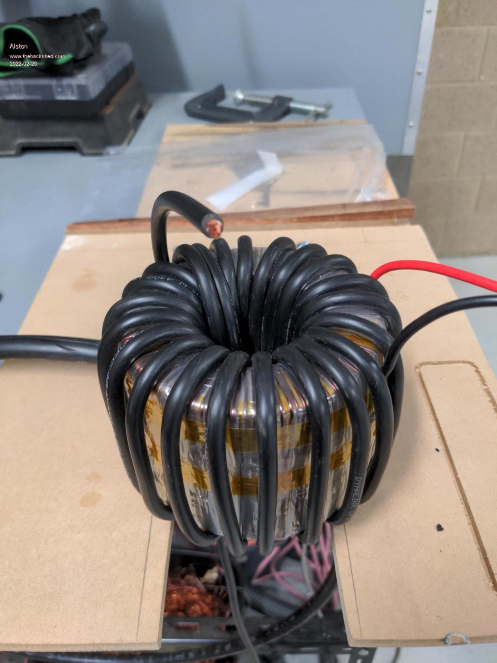

Well I have put the first layer of windings on and the slots definitely help alot. I still don't seem to be able to get it as perfect as yours Roger! I also coated mine in epoxy as per Klaus's instructions. I have fitted insulation on the inside and outside of the core, the photo above was take just after the epoxy dried.
I am building a 48v 5kw inverter. The IGBTs are Eupec/Infineon ones rated at 400 amps, I got them because they were cheap from a surplus place on eBay.

  Alston said   I also coated mine in epoxy as per Klaus's instructions. I have fitted insulation on the inside and outside of the core, the photo above was take just after the epoxy dried.
That's good, I was wondering what type you might use, or whether you might just use epoxy.
  Quote  I am building a 48v 5kw inverter. The IGBTs are Eupec/Infineon ones rated at 400 amps, I got them because they were cheap from a surplus place on eBay.
Thanks for that. I still haven't worked out what I'm going to use for my big inverter  ...  but expect I'll just use mosfets for the smaller three.
