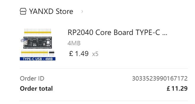

  Quote  dunno what I ordered, it will be a surprise
Spoiler Alert!

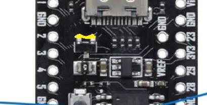

Your photo shows 4M.

the didn't click the right ae button again. is 4m worse than standard rpi pico?
Posts: 9333
Posted: 08:10am 02 Apr 2024
4M is twice what you get on a standard Pico, so no, no worse. :)
And you paid less and might be able to clock them faster. :)

the vbus to supply usb device and 2 diodes stopping see when boards arrive
Posts: 9333
Posted: 07:58pm 02 Apr 2024
Your best bet is to look at the circuit, Stan.
I think it might be a double diode. One feed comes from the USB 5V, one feed comes from VIN and the common cathode goes to VOUT and the input of the 3V3 regulator. Connected like this you can never power the USB supply from the module. I think putting power the other way from a powered hub might work as you are still supplying the 3V3 regulator at the same time as any USB devices, just in the opposite direction.
Posts: 2807
Posted: 03:17pm 03 Apr 2024
Mick, if you blobbed the dual diode input and ran 5V from the usb to ttl I presume would be added for programming from a pc, to Vin which now blobbed to Vbus, so powering rpi2040 3.3V reg and powering usb device which is the way I use standard pico usb but 5V from usb to ttl to Vbus no blobbing.
dunno where the dual diode is.guessing the 3.3v reg is next to pins 2 and 3.
Posts: 9333
Posted: 04:29pm 03 Apr 2024
You can't get 5V out of the YD-RP2040 USB socket. VBUS doesn't come out to a terminal so you can't connect to it. It can only be used as a supply input.
Pin 40 (VOUT) is the same as VSYS (pin 39) on a Pico.
Pin 39 (VIN) is the equivalent of a Schottky diode connected to VSYS on a Pico.
I'm not sure where the diode(s) is so I don't know how difficult it would be to blob it. It would certainly make it a non-standard board though.

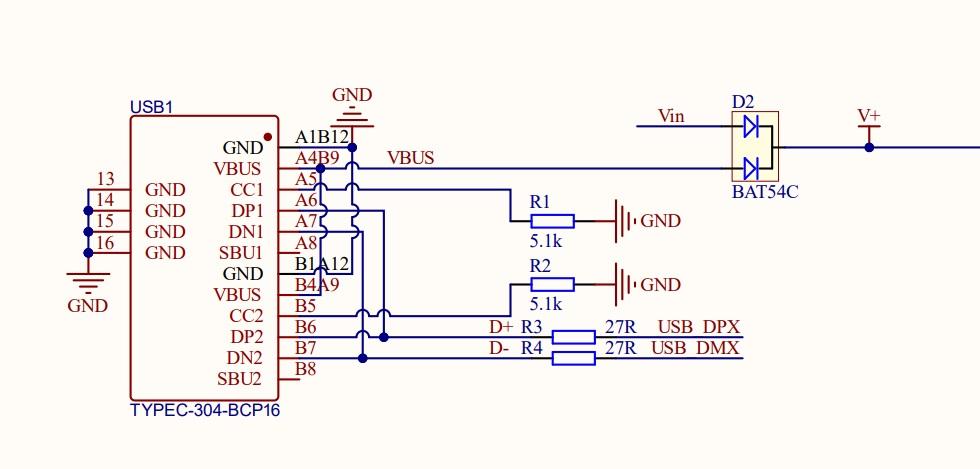

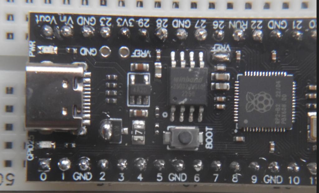

Hi Mick, the relevant bit of circuit/ diodes.
in threads links are mentioned not to say about ili9488 mods all not standard but are now.
Posts: 9333
Posted: 05:38pm 05 Apr 2024
So you see what I meant about VBUS now? you can't get 5V onto it from the 5V rail, but it can provide the 5V rail itself. And I'd remembered correctly, it is a double Schottky diode. V+ is labelled Vout on the board.

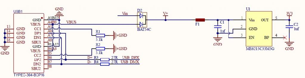

My boards not arrived yet but here's the diodes and if blobbed you can power via vin and that will supply usb kb .
the danger is connecting vin to 5v and connecting usb to pc.. but pico usb you wouldn't, the 5v to vin when blobbed would be for me from the usb to ttl board, the pico usb connects to and powers the usb device connected....or an I mad?

No, that's ok if I understand you correctly.
I don't like to modify modules though. At some point you might want to change it for something else and, unless you've kept a record of any changes you made for that particular job, you might well plug in something that either doesn't work or causes damage. Far better to produce a manual that describes how to use a standard module or, if absolutely necessary, how to modify a standard module so that it works.

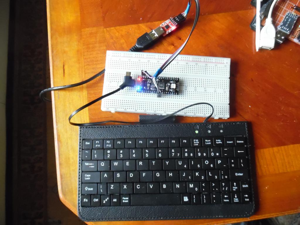

Hi Mick, 5 new picos finally arrived. I blobbed the diodes so vin is connected to usb vbus. It works. post more when I flash usb picomite.
Posts: 2807
Posted: 04:09pm 09 Apr 2024
Flashed usb picomite rc3 and it works as "normal picomite" in usb mode.
I use the usb to ttl as the 5v supply going into vin but that now also powers the usb keyboard. It's fine as long as you remember not to connect to pc usb and stick 5V into vin same time.
so usb is possible...you shall go to the ball cinders

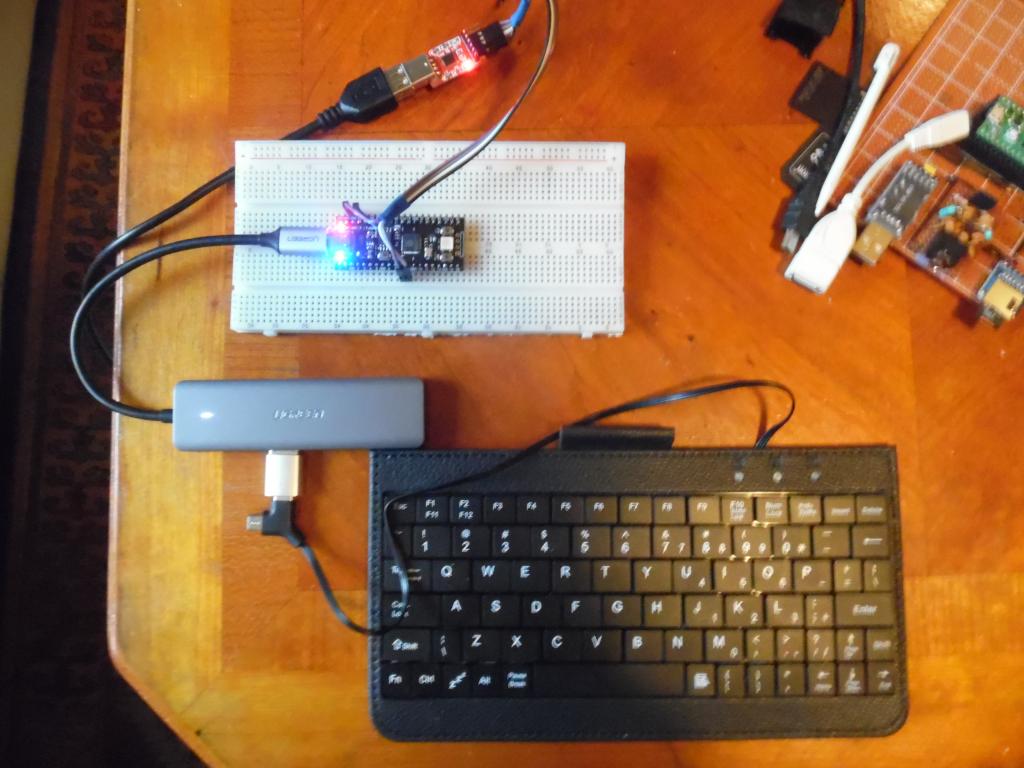

As my drift is this "new" pico in usb mode so plugged a usb hub type c into pico and usb kb into hub and worked.
I will power the hub, micro usb 5v, and see if it powers the pico and kb.. after remove 5v to vin. this will mean blobbing diodes not needed to get this pico working usb
edit Powering usb hub doesn't power pico, so only blobbing diode :(
edit again.. obvious it would not power pico, it would not power a pc usb port. doh
