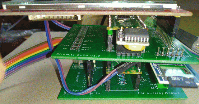

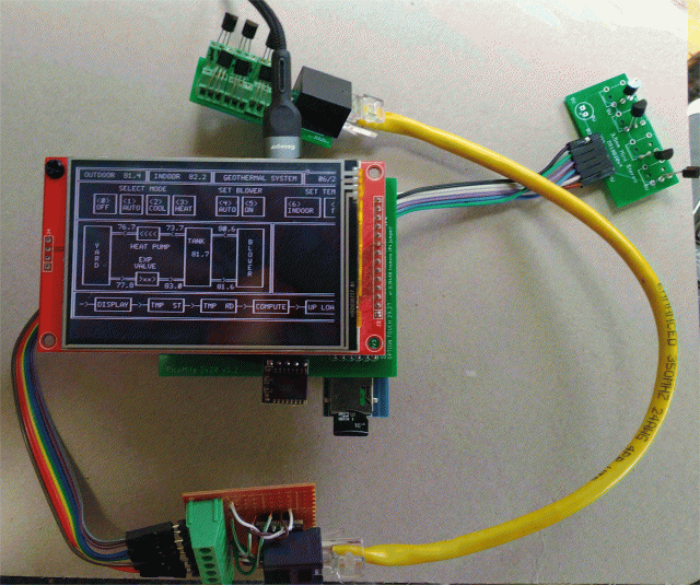

Here's a PicoMite client with a PicoMite server. What I'm calling the client is the same PicoMite with 10 DS18B20s as was previously connected via USB serial to the MMBasic for Windows program.
To connect to a PicoMite (or other 'mite) it had to be set up with OPTION SERIAL CONSOLE 1,2. Otherwise, it has just the MMBasic firmware--no user program.
Here's what the stack looks like:
Aside from the two Dupont wires crossed over connecting the Rx & Tx, I put long pin male headers on the upper Pico on VSys and the upper two and lower two 0V pins (for stability as well as to connect the grounds) to plug into female headers on the lower Pico.
What is displayed is a first pass at Paul_L's geothermal controller display with PC line drawing type graphics. Temperature readings from the 10 DS18B20s change every second.
Obviously the ILI9488 480x320 screen is not wide enough to display the full screen. (Didn't someone produce an SSD1963 PCB for the PicoMite?)
The code is attached. It should run unchanged on MMB4W (with serial properly wired), since I tried to discriminate between mm.device$="PicoMite" and mm.device$="MMBasic for Windows", but I haven't gone back and tried that yet.

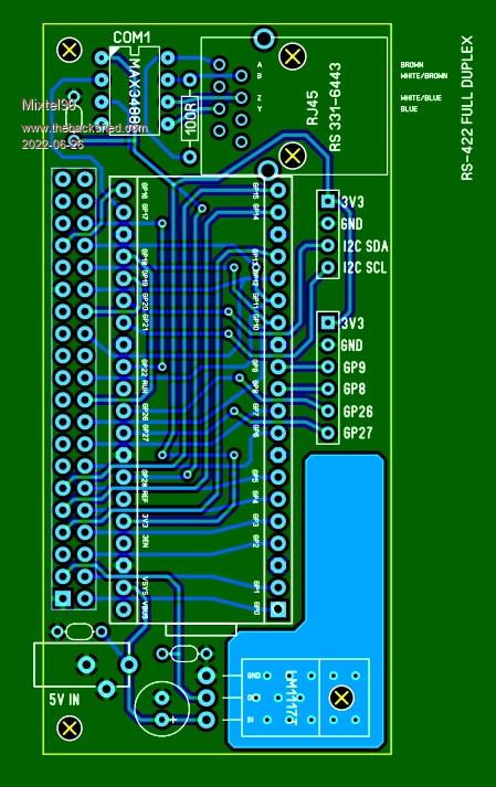

Posts: 9288
Posted: 12:52pm 26 Jun 2022
My original designs for the SSD1963 boards got lost when a USB stick got corrupted, unfortunately. However, I had a thought last night about doing a pretty minimalist design, but intended strictly as a control system front-end. It uses the 5" 40-pin display because that's what I happen to have. :) The idea is to use it with the extended graphics, so no keyboard socket.
This one has full duplex RS-422 on a RJ45 socket (not using the ethernet wires) and an I2C port brought out to a header with GND and 3V3. The remaining 4 I/O are on a second header.
The advantage of full duplex is that you treat it as a straightforward COM port and MMBasic handles buffering etc. It also works nicely over CAT5.
Just not sure about using some of the cores for power. It might not be a good idea if someone was to plug ethernet stuff into it. Probably better to just power locally at  the other end. I've since added a link block to put 3V3 and GND on a pair.
The PicoMite uses it's SMPS to get the 3V3 for most of the stuff, but the SSD1963 has a linear regulator. The backlight is a pretty heavy load for the PicoMite.
Posts: 12110
Posted: 01:01pm 26 Jun 2022
  Quote  The PicoMite uses it's SMPS to get the 3V3 for most of the stuff, but the SSD1963 has a linear regulator. The backlight is a pretty heavy load for the PicoMite.
My experience was that the 4.3" SSD1963 would work off the PicoMite 3.3 supply
The 5" definitely won't work and needs a separate 3.3V supply
The 7" backlight is powered with 5V so as long as your PicoMite incoming supply is good then no additional 3.3V supply is needed
Posts: 9288
Posted: 01:10pm 26 Jun 2022
Thanks, Peter. My horrible little USB meter didn't seem to be able to make its mind up, but it seemed to settle on about 250mA with the backlight full on, although at one point it was over 400mA. There was no PicoMite on the board so it wasn't that using the current. Mind you, I left all the caps off so the poor reg might have been oscillating. :).
I had the display working once, that's all. (One of the old design boards, not this one). It's a proof of concept though. :) Now to find the problem...

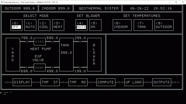

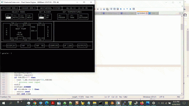

Posts: 3886
Posted: 12:05am 27 Jun 2022
Not sure if this is the right tread for this, but I won't be stepping on anybody's toes but my own, so here goes.
Paul_L's screen display with the PC drawing characters is working well with font 4, mode 1:
But Paul would like everything to be bigger. I set up all the TEXT commands to use a scale of 2, and that works with mode 16 (1920x1080, even though my laptop screen is actually only 1600x900:
There's one problem that I've found so far: if I write to TEXT 0,0,"SOMETHING",,,2 then the window banner overwrites the first lines of the text. For the image displayed above, I've fixed that by writing the first line at pixel row 6*mm.fontheight*scale.
As can be seen, this works ok (except that a bit of the top of the first line is still cut off), but is the need for this offset when TEXT is scaled something which should be looked at?
