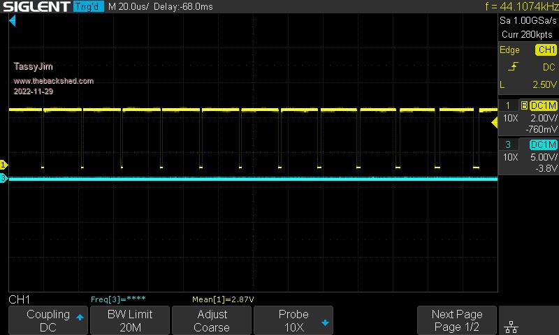

I have the worlds worst DSO (the wife downvoted investing in a good one until my 50th birthday) and with OPTION AUDIO GP0,GP1 configured and no sound being played I am seeing a square(ish) wave at ~11.2 KHz and a Vavr of 1.45V on GP0 & GP1.
What you are seeing is the pico setting the no-signal level to VCC/2 to avoid the clicks when audio starts/stops.
44.1kHz with the duty cycle changing to give the audio.
I think you do need to filter it to minimise the 44.1 kHz.

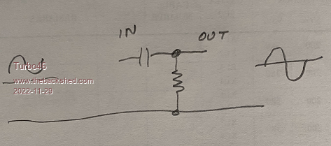

Posted: 04:58am 29 Nov 2022
Tom, If Volhout's circuit is working then I would stick with that. The transistor is used to increase the drive capacity of the output pin. It is just switching 0's and 1's to the 'speaker', the speaker is effectively filtering out the high frequencies that it can't reproduce.
Using filter circuits and series capacitors won't work because using them you are feeding a switching transistor circuit with an analogue signal. The transistor is not used as an audio amplifier, its a switch and analogue signals below about 0.6 volts won't turn it on.
To use the filtered output, you need a more sophisticated audio amplifier circuit.
The series capacitor mentioned in the manual would be something like:
That would be used to remove the DC offset in the audio for an external audio amplifier that does not have series capacitor in it's input circuit. If the amplifier was DC coupled through to the speaker then it would have DC through the speaker and they would release the magic smoke.

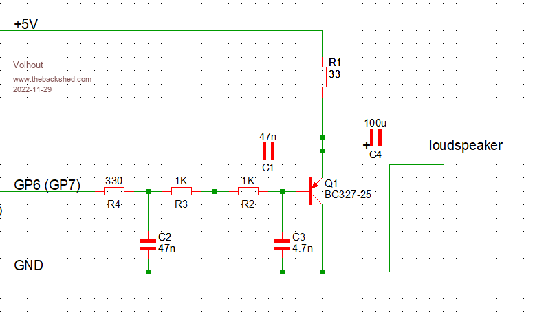

Posts: 6304
Posted: 11:38am 29 Nov 2022
No inductors, try this ....
If you want to go cheap, remove C4, and connect the loudspeaker in stead of R1. But this may not be good for the speaker.
Check: C3 is 4.7nf, C2 and C1 are 47nf (10x larger value).
This will give you good audio up to 8 kHz (enough for game sounds). It is not as good as the inductor filter, but avoids the inductor.
And (not a hot topic here, but it is in my profession) it can be fully SMT. So cheap to get assembled by JLCPCB or who-ever.
Of coarse, if you want stereo, you need 2 of these. (as also with the previous design).
If you avoid any filter, it will generally upset cats and other animals the hear 44kHz. The 44kHz sound level is really high. If you connect to a HIFI amplifier, I would most certainly add the filter. In your hand held gaming toy, you may be able to do without a filter. The gameboy sounds of the 80's and 90's also got away with minimal filtering to the small toy speakers.

Posts: 6304
Posted: 11:58am 29 Nov 2022
BC327-25 / BC327
The "-25" indicates it is a part with a typical current gain (called "hfe") of 250x. Without the suffix you can get values from 100 to 400. Any will work in this application, but 250 is best.
No difference, it is just a symbol from my electronics simulation package.
You can use any PNP like BC327 BC328 2N2907 2N3904.
Maybe even BC557 BC558 BC559 (these are not really as good as the BC327/BC328 in this application on harmonic distortion, tested them before, but they will work).
You could even try BD136 / BD138 / BD140 (medium power transistors). Whatever PNP is in your toolbox. But for best performance the BC327...
