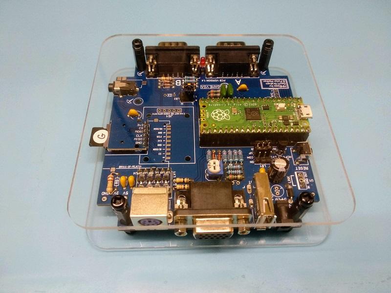

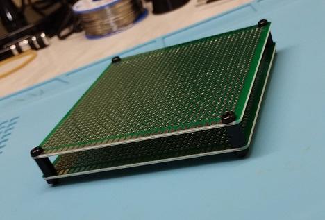

A sandwich of two PCB's, one functional and the other purely structural held together with nylon screws and spacers makes for a cheap, rigid, if porous enclosure - which can have important setup instructions silk-screened onto it as part of the process.
The next price bracket above that would be an attractive acrylic sandwich like my PicoGAME VGA enclosure:

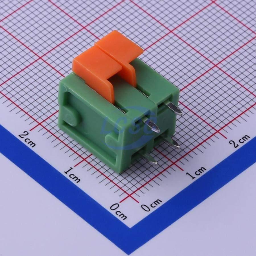

That sort of approach is certainly more feasible. For me the most critical aspect is that all components are soldered to the PCB and so can be mass-produced without significant labour.
Spring loaded connectors like this
allow bare wire connections and can be used repeatedly.

No idea about cost of such connectors, but (at the moment) nothing beats pin headers and cheap (female) dubro connector wires. When they get unreliable, throw them away.
The dubro wires are not bad, but most users use the male version in combination with the (horrible contacts) breadboards. But the female ones, in combination with pin headers provide relatively good connection at an unbeatable price.

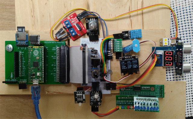

For a picomite experimenter board, there's always this, including a small I2C display:
PicoExperimenter PCB (Link with link to youtube video)
Includes I2C, SPI, rotary encoder, SSD1306 I2C LCD, 3-color LED, LED flashing, Buzzer, I2C MCP23017 flashing 16 LEDs, Servo slewing from full clockwise to full counter-clockwise and back, PWMing of 5V LED using MOSFET module, Dimming/brightening of 5V LED using MOSFET module using potentiometer, ultrasonic distance measuring module.
An ILI9341 or ILI9488 could be mounted, but that would take away pins.
This "hat" PCB could be mounted on the 2x20 header on on Mick's new VGA PCB (not yet with Gerbers). The GPIO pins are different, but that would just be a software change. Some pins would not be available if VGA is used.

Kiddos use banana plugs in much of the kit designed for schools -- plus they are likely to have the leads with the male versions on.
Those spring loaded terminal types are also fine to connect bare wires.   What they cant be doing with (no fine motor skills) are those terminal blocks with screws in --- they can never ever get the wire in and screw it back down.
Much of the Microbit kit gets round all this with extra large plated holes on the PCB onto which crocodile clips can be attached to make a connection.

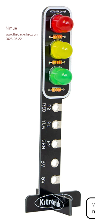

One of the biggest supplier of this kind of kit to education is Kitronik and one the more "robust" manufacturers is "Monks Makes"  (as in Mr Monks makes....)
Have a look here:  Example kit
This for example shows the through hole plated connectors that are common for use in class....  which is a perfect segue into the "ecosystem" we could build  --- not thinking commerically here  -- more like make the designs available and build some should schools want to go that way....
Edit:  The more I look at what school's pay for -- the more it makes me want to make alternatives -- (this one is not actually badly priced) -- but they intend it to be physically bolted to the microbit -- so impractical to designed a functional 4 - junction --- you'd need 4 microbits (so total price circa £120)  -- achievable with one EduMite and 4 sets of traffic lights.

I think Peter is sensibly pushing a design which JLPCB could basically manufacture in its entirety out of PCB and Chinesium and "you" would only be left with a bit of basic mechanical assembly to do yourself or farm out. That means every component is soldered to PCB and nothing is bolted/glued/selotaped to any enclosure.
This is the very early stages of the PicoGAME LCD Mk2 prototype, just two PCBs held together with 4 nylon spacers, it's completely rigid and feels suprising substantial.
In my case I will only be sticking the battery and speaker between the PCBs and all the active stuff: LCD, buttons, Pico (under the LCD) and audio "tank farm" will be mounted on the top board and completely unprotected from sticky fingers.
In your case the two boards could be connected by male/female header pairs as well as the spacers (c.f. the red ILI9341 modules can be mounted to a PCB) and all the delicate gubbins mounted in the interior on the bottom PCB. The top PCB could then have any user accessible sockets, buttons, display, etc. mounted to it. If the display needs extra protection then I would consider having the top in two pieces half acrylic (it's just a rounded rectangular piece with some mounting holes) and half PCB and then mounting the display to the bottom PCB under the acrylic.
Of course I recognise I'm just making s**t up based on the only two electronics projects I've ever been involved in .
