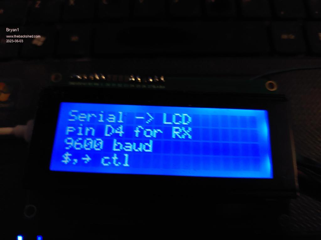

Ah ok I did put D10 on pin 14 and went down from there so do I have it all backwards ???
If so that would be the problem if so I'll reverse the wires in the morning and connect it all up for testing.
It has been well over a decade since I did electronics and the grey matter does need a reality check me thinks but eh thats all the fun aint it.
Cheers Bryan

  Bryan1 said  Ah ok I did put D10 on pin 14 and went down from there so do I have it all backwards ???
Cheers Bryan
If you've connected the digital pins differently to poidas original circuit you can change their assignments in the piggyback lcd program to match instead of resoldering the wires. If that's easier.
But yes if you're getting foreign characters it suggests a communication error between the piggyback nano and the lcd during initial setup.

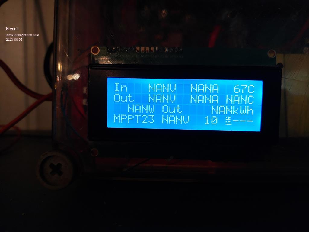

G'Day Guy's,
           Well got the MTTP all setup today and looks like some fault finding to as this is the lcd output
So some help is needed here as why the volts etc isn't showing
Cheers Bryan
poida
Joined: 02/02/2017
Posts: 1510
Posted: 11:20am 05 Jun 2023
I think it's time to calibrate your mppt
connect to the nano via the usb socket with the laptop
It might be 9600 baud (or it could be 115200 baud.) but try 9600 first
use the Arduino program to connect to the serial device.
send ? to it (then ENTER)
you should get a menu
FIRST YOU NEED TO GET THE MENU BEFORE YOU CAN CONTINUE
send Z to set some defaults. do this first.
Once you tell the mppt what voltages are what, and zero the current sensors
and then calibrate the current sensors you will get it working.
how I do it:
get your multimeter, send ? and then measure the input voltage with the DMM
send C to the mppt and it will say "what DC volts IN is this?" tell it what it is
same for the battery or mppt OUT terminals. measure that and then send D to the mppt
which will ask "what volts is this on the output". tell it that.
Now you need to be able to measure current. I use a cheap UNI-T DC clamp meter
but there are other ways to do this.
Disconnect the solar INPUT. We do not want 100V DC when we play with things.
Disconnect the mppt OUTPUT (or battery, same thing)
We do not want 1000 Amps potentially giving us nice surprises.
Get a current source. I use a bench power supply. It gives me 6 Amps even when
connected to a short circuit. You can make one. 12V car battery, 60W headlight globe.
this will be about 5 Amps.
power mppt up with 12 supply. Have nothing connected to input terminals AND nothing
on output terminals.
from the menu, send G to tell the program what zero amps is for the INPUT.
it will think for a bit. And then print the menu again.
Send H to tell it what zero output amps is. Again a think and then the menu again.
Now apply a known current across the input sensor. Positive of the current source goes on the SOLAR + terminal. negative/ground goes to ground.
Send E and tell it what that Amps is.
Now we have input current sensor calibrated.
apply current source to output current sensor. Put the wires on the sensor terminals
for best effect. Again you need to put the current through the sensor in the correct direction. Send F to tell it what this current is.
Now we have both current sensors calibrated AND the two voltages.
Zero the energy total, so send N for that.
Set up the charge voltages as needed. To have no battery tempco, just
make BV tempco = 0.0
Try to avoid leaving anything as NAN
I like a 6 hour absorb time, I set float the same as absorb. I do not bother with equalise
We can finish this once you get a menu and can get a few things calibrated.

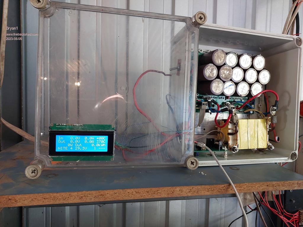

Bryan1
Joined: 22/02/2006
Posts: 2298
Posted: 12:48am 06 Jun 2023
Thanks for that Poida I just went thru and did all the calibration but for some reason it won't come out of nite mode and I have set Y to 0.
The solar is still going thru the board to the batteries so the nite mode should see there is power going thru.
So the sleuthing goes on
Cheers Bryan

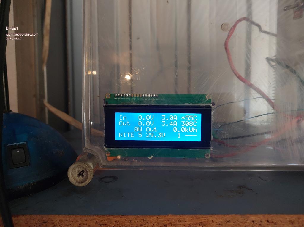

Bryan1
Joined: 22/02/2006
Posts: 2298
Posted: 07:33am 06 Jun 2023
Just got back from town and there was no change so I uploaded the highside_ntc code as the that latest code for the weekly totals kept doing the same thing.
When I use C and then D the output is inf( nan V ) for both and this is with the unit not connected at all.
So don't really know why the code won't accept my input
Cheers Bryan
poida
Joined: 02/02/2017
Posts: 1510
Posted: 07:55am 06 Jun 2023
so you do this without a voltage applied to the terminals?
Do I understand correctly?
I want us to calibrate the voltages first, with some known or measured voltage
on those terminals.
Then remove them to calibrate the current sensors. We do both zero current
and then a known current.
Bryan1
Joined: 22/02/2006
Posts: 2298
Posted: 08:22am 06 Jun 2023
Poida when I first tried all connections were in place and it made no difference so I removed the connections at the external ends as it much easier access and got the same result.
In the morning I will try again but there is one thing I only have one temp probe connected going to the heatsink and the other with no connection and the temps shown are totally off the map. Now the LCD keeps shown overtemp and when I put U to 1 it showed overcurrent yet 0 current was showing on the LCD.
I connected RT2 with the sensor and on the lcd it showed *68C when the heatsink is cool to touch and the other sensor reading was showing over 200C.
Whether this is causing my troubles I don't know but it is alarming to see just how far out there are.

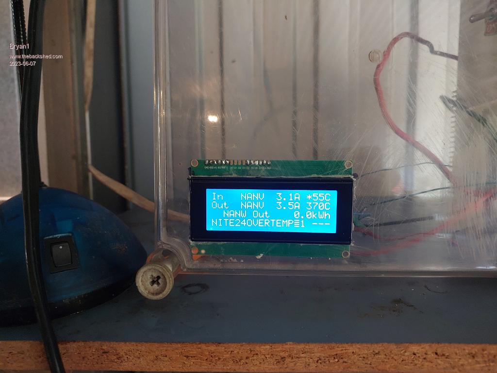

Bryan1
Joined: 22/02/2006
Posts: 2298
Posted: 12:02am 07 Jun 2023
Ok decided to load the latest code and setup the serial connection and typed Z in to get the defaults
Measured the input volts 25.42 so typed C and entered it, measured the output volts 24.9 so typed D and entered it.
So now i'm at a loss why it won't accept my input figures
Cheers Bryan

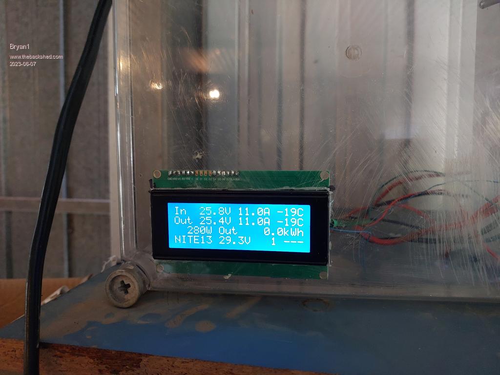

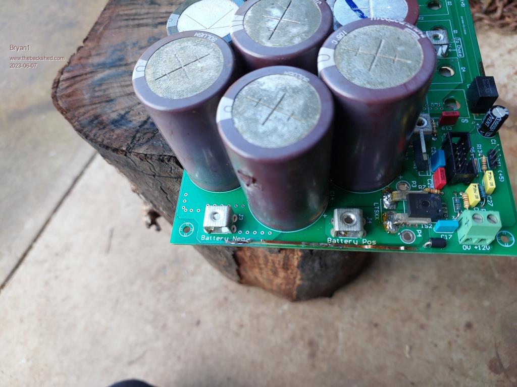

Joined: 22/02/2006
Posts: 2298
Posted: 02:12am 07 Jun 2023
Decided to take the board out of the box so I could test on the shelf and this stuck out like the dogs B's
The only way i reckon could of happened was when I was probing I did hit the choke connection and got a spark
So I'll fix the track on the board and test all the caps to ensure they are OK.
I got a new 9 volt battery for my clamp meter and did see the input amps were 14 amps and the lcd was showing 9 amps so they will need calibrating again.
The fun continues
Cheers Bryan
Bryan1
Joined: 22/02/2006
Posts: 2298
Posted: 04:13am 07 Jun 2023
G'Day Guy's,
           Well fixed that broken track with some single core wire and for peace of mind changed out those dirty caps and replaced the 4 for a total of 870uf.
On checking with my current meter the input and output amps are spot on   aswell as the voltages.
Now these 190 watt panels have an open circuit of just over 40 volts but the battery looks to be clamping the voltage and my plan is to put 2 in series to double the input voltage and it does look like I'll have to to get it out of nite mode.
Cheers Bryan
