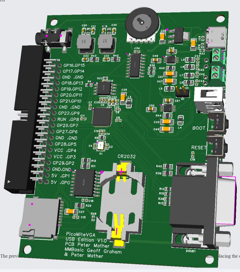

Yes but aren’t these getting assembled by JLC?
They could always solder to the pins of the screw jacks, on the underside.
I thought 2 extra pads wouldn’t hurt but then it isn’t the end of the world the way they are.

A very nice design. Any possible minor improvements?
There is plenty of space on the PCB, so why not use the standard DS3231 RTC chip, which eliminates the need for soldering with SMD for beginners?
The two power amplifiers may draw the most current and if battery use is also desired, it is possible to disconnect the power amplifier power supply with jumpers or a fuse (PTC) in the 5V line if necessary. closure in the power amplifier so that the PCB is still a usable whole?

One last version
75575edc-519c-4385-9617-4183d87ead63.pdf
Link in the power supply to the amp to disable it if required
Extra holes near the speaker connectors
Change to the "large" DS3231 which is in stock
New price including the RTC £15.15 each (5 off)
There isn't board real estate to include a Wii connector or board cut-out but with the rear facing connector exposing all the pins it is trivial to use an external adapter for the Wii or for a NES controller.
At the moment my USB hub has died but in the future I may try and add support for something like the Sony DualShock 3.
NB: I intend that this will be the reference design and will pre-configure the firmware to work with this configuration "out-of-the-box"

Very impressive Peter ... though I'm not entirely certain I can tell what is the "front" and what is the "back" of the board ?
