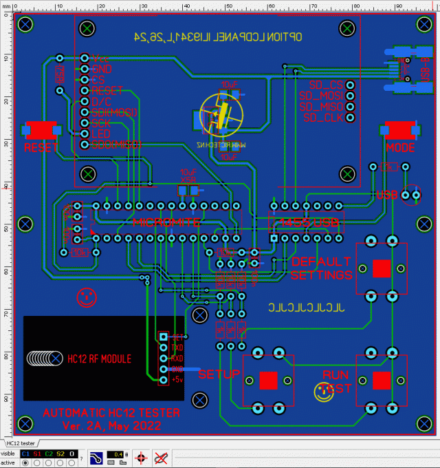

Can you post the full PCB layout for the old working version and the new 'troublesome' one.
Images, not some strange format.

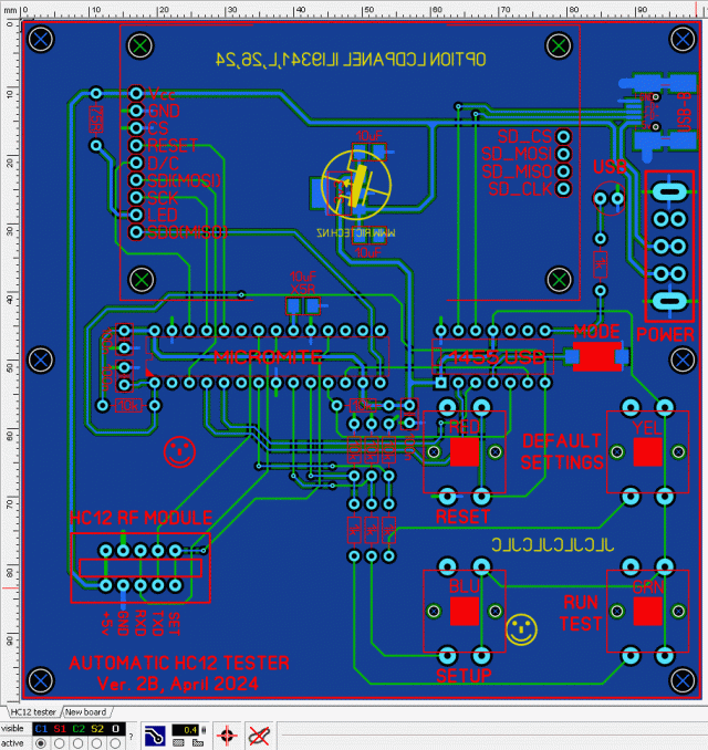

Here are the images in GIF format:
OLD PCB DESIGN:
NEW PCB DESIGN:
Note that there was no change in the layout of the SPI pins to the LCD between the boards, only that I move the RESET tact(and changed it for a button), and added a main power slide-switch on the right of the PCB.
Other then that.....
Here is a ZIP file with the GIF files in it, in case the forums squeeze the image.

@ Jim - You asked me to post the images of the old and new PCB.  Did you see anything obviously wrong on my layouts that you would have changed?
Posts: 6608
Posted: 06:51am 20 Apr 2024
I can't see any difference in the tracks that matter.
Not that I have any experience in board layout.
