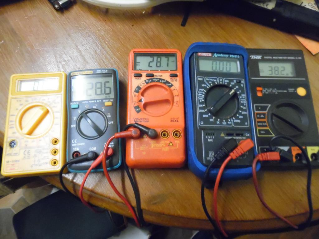

I came across impedance in the '70's building speakers. the dc coil resistance wasn't the impedance value, which it was sold as ie 8ohm or car speakers 4ohm.
the phrase "high impedance" is won't draw much current when measuring...so lowering voltage. most cheap meters are ok in this respect I think but I'm usually wrong

It used to be that cheap meters were pretty bad for loading circuits. Now even a cheap digital meter will hardly load the circuit, particularly on DC volts. I have one of my late dad's meters. it uses a 1mA fsd movement so it's 1000R/V. On a 10V range will have a resistance of only 10K!
Wes, the DC resistance of a 4R or 8R speaker can be very low indeed. Sometimes a fraction of an ohm.
Posts: 2807
Posted: 07:31pm 29 Aug 2024
only the maplin says 0V when nothing connected, the others float. I liked maplin.
Posts: 9205
Posted: 09:21pm 29 Aug 2024
My most trusted meter is a very old Precision Gold WG022 that I got from Maplin. Just recently I've given it the first really good clean of its life and given it some new test leads as the red one was damaged in a couple of places. :)
