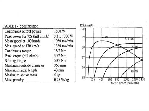

Considering most generators built here are from what we can scrounge for the least amount of cost and a little effort to build it into a working energy source.
98% efficient would be nice but hard to justifier the cost compared to almost free parts and as the wind is free several mills at low cost would have to equate to better efficiency than 1 high cost mill.
If you were paying for the energy source to run the generator than efficiency would weigh into the situation much more.
What sort of return do your generators give for rpm to power and how much energy required to produce that power.
$ cost = ?? watts in return.
If you can post some basic figures then the cost might be better justified.
Pete.

[Quote=JB@Marand]At what price point would you be happy to pay for a 98% efficient device?
98% efficient?!?!?!
Heck, ain't nothin' that effecient except maybe a growing plant! 98% is bordering on God!

If you go to http://www.csiro.au/resources/pf11g.html#design and hit download you will get all the technical details of the motor and the configeration drawings. Attached is an image of the basic specs and efficiency curve.
Jamie

Drawings are dandy, but the proof is in the pudding, as they say. Build it and we'll all shower you with accolades.
I'll hide and watch.
