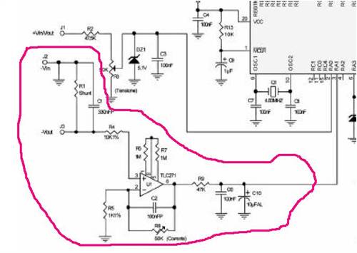

as far i can tell so far using allthread is practical for low Mv shunts..I havent
had much luck trying to calibrate a piece for .1r ...it seems to need to be very long
stainless steel wire wrapped around a former might be more pratical for .1r
i found this measurment/guide on another site
a 1mm by 1mm rod of stainless steel 1 meter long would have a resistance of 0.74 ohms.
i did find this cct which seems to amplify a .01r shunt to match a pic chip
it seems to use a tc271 to match the shunt...dont know if this will work but i went ahead and ordered a few anyway
this is the pdf of the cct (its not overly big)....erm i,ll need to brush up on the Italian though...
2010-06-15_225001_mk3980.pdfEdited by niall1 2010-06-16

niall1
Joined: 20/11/2008
Location: Ireland
Posts: 331
Posted: 12:16pm 16 Jun 2010
thanks for the replys and info ..the shunt is a bit on my brain at the moment...
there seems to be lots of variables and a knowledge of instrumentation electronics would help ...but thats beyond me........
i know it,d be better to buy an off the shelf shunt but i dont even know if the amp will work...
the opamp seems to be the crucial bit....not as much the shunt ?
there seems to be lot off shunt variations and using Bobs idea off keeping away if
possible from the limit seems interesting
maybe it,l be possible to test it out using stainless at low power ..then get the low drift commercial one
i,m using (gratefully) the piclogger as a learning tool...it does push you in that direction off putting a pen to paper and trying to work out wattage loss , voltage drop etc....so for know i,ll stick with a simple shunt...hopefully the lowest resistance thatl work with amplification ,...if it dosent work it,ll only have cost the price of the few opamps i,m using which isnt really that bad.......if i go to buy i might understand what suits my wants a little better then.....
if i can get reasonable performance with as little loss thats reasonable that,l be ok for me ..a little extra line resistance might possible help anyway as at 48v

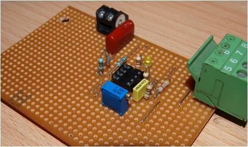

thanks again for all the input...i never thought a humble shunt could be so interesting ...i,m still waiting on the opamps to come so this post dosent contain as much as i,d like
i made up the/A very doubious Mv pre amp board in the meantime....
surprisingly what was actually a lot more interesting was putting a simple piece off stainless shunt on the batts ground and putting the multimeter across it ...never thought i would actually find a use for that Mv setting setting on the meter ....it is a lot off fun
but all the while the windmill seemed to be looking down saying ...do your worst , if i could care less i would...i guess it knows something i dont....
it usually does
