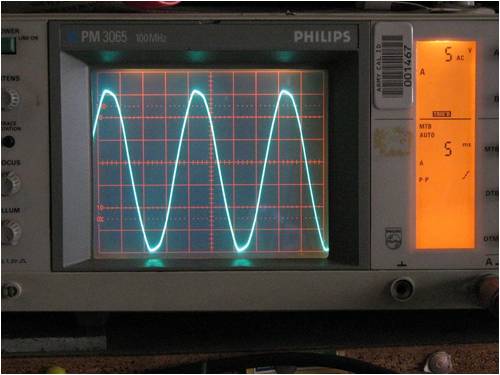

Hi Ready,
You asked about why the voltage was different after you rectified it and then it changed when you added the v reg.
I took some photos of the voltages on the CRO for you to see and help to understand what is going on.
Firstly your meter will not read peak to peak of the wave and will give an average of the voltage.
For the photos i used a 12 volt rated transformer and as you will see the peak to peak voltages are much higher than this.
Each graduation from bottom to top of screen is 5 volts.
This is the straight 12 volt AC out of the transformer.

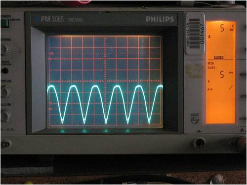

This is with a bridge full wave rectifier added.
Here you can see it is rectified but not a smooth DC output, and is about 17 volts peak to peak.
Remenber you meter can not read to the peaks, so you see and average of this.

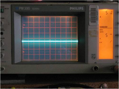

Final photo is with a 3300 uF capacitor added for filtering.
Now we have a nice smooth ripple free DC output of about 17 volts.
Your meter would now read 17 volts.
It should be noted that there was no load on the circuit when the photos was taken and a load would drop the peak voltages back some.
