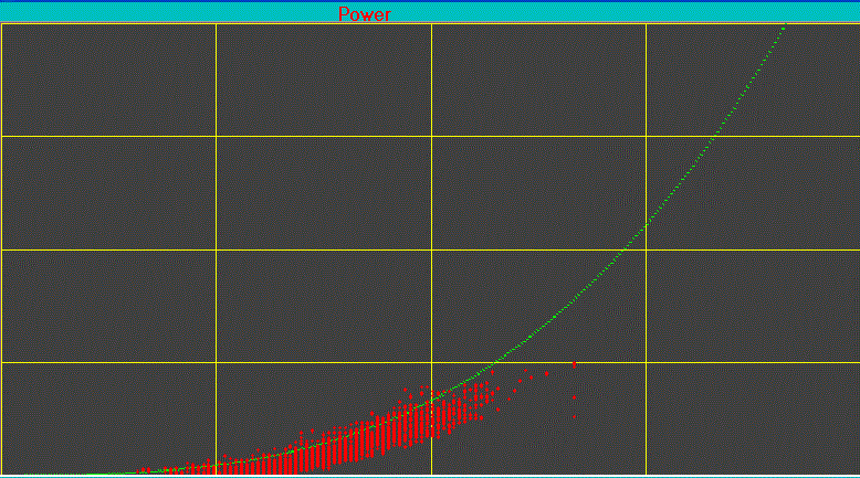

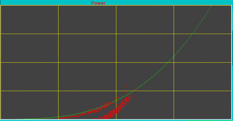

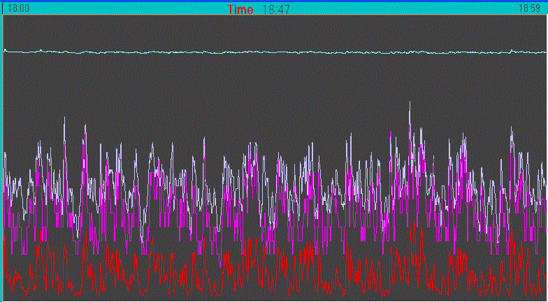

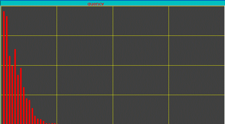

Hi readers,
Derek has asked for some empirical data from our windmills. I have had some typical winds today. [In the 80% part of the 80:20 rule windspeed range]
Here are some graphs of the logged data, and the performance curve and the actual recorded wind energy distribution.
On the first graph, the pink line is the windspeed, the lt blue line is the windmill rpm, the red line is the power. The close to horizontal line is the battery voltage.
The windmill rpm closely follows the windspeed. On the second chart, the green line is the expected output cubic power v windspeed. The red dots are the actual power v windspeed measured data.
The third graph is the actual distribution of the wind energy, and shows the typical negative exponential type relation. I have had this translate into a typical binomial distribution during periods of sustained high winds. On this day was typical winds, and was the negative exponential. Peak power was 200W, peak windspeed was 13knots and peak rpm was 210rpm.
The windmill has only series caps into the 24V battery and no dedicated buck MPPT. The caps are 3300uF 80VDC rated in the typical back to back arrangement.
If I was to change the loading to 48V, I would need a cap doubler, but the results would be similar. I really can't complain about the power tracking achieved for my typical winds. These winds give 0.5-1.5kWh of power per day, from quite moderate
winds.
I know there is a place for a windmill MPPT, but maybe a hybrid of caps and electronics may offer a simpler solution.
Gordon.

Your turbine rpm tracks the wind speed well - can you plot TSR over the same period in the chart (I assume that's about 1 day of logging). If you can, do you find it's fairly constant, and for your site (in general).
The power curve data is also very consistent - does your chart plotter put numbers on the axes?
I know this is beyond the pale, but do you know what difference not having the caps would make?

Hi Derek,
  dereksoftstuff said  Your turbine rpm tracks the wind speed well - can you plot TSR over the same period in the chart (I assume that's about 1 day of logging). If you can, do you find it's fairly constant, and for your site (in general)....
The windmill tested has quite thick airfoil section wooden blades [3 blades]. The TSR tracks at around 5. The TSR is quite constant across the windspeed range. Below cutin, the TSR approximately doubles, as expected [unloaded TSR].
  dereksoftstuff said  The power curve data is also very consistent - does your chart plotter put numbers on the axes?...
The user sets maximum limits in a configuration page, and these are used for the graphing scaling on the plots. The analyzer is designed for change comparisons on an individual windmill. The important aspect is the green line. I have no need for numbered axis.
  dereksoftstuff said  I know this is beyond the pale, but do you know what difference not having the caps would make?
I like looking at real data ...
Not having caps, results in a stalled windmill. There is some power, but a maximum of about 100W or so in a storm.
The display of real time graphed data is very revealing on performance.
The top graph above was for a 1 hour time period, recorded at 1 second intervals, from approx 10000 individual averaged time readings. This chart can be viewed continuously updated.

Hi Derek,
I have just rewired my windmill for 24V operation, and I needed to make a new cap doubler.
Here is a graph showing the effect of the caps. 4700uF back to back in my normal cap doubler way.
The lower dot graph is without caps. The green line is what we are trying to achieve.
The matching of the lower end windmill output to the wind energy has been achieved without complicated electronics.
It will be interesting to see how others do with their windmills once performance monitoring is achieved.
Gordon.

Hi Gordon
It shows that simple is the best, the way it tracks the power available curve says it all, for a direct coupled windmill, high reliability the low tech is defiantly the way to go.
All the best

Gordon - Nice chart data comparison - looking good.
