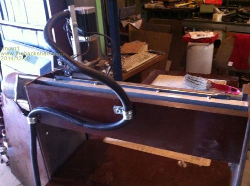

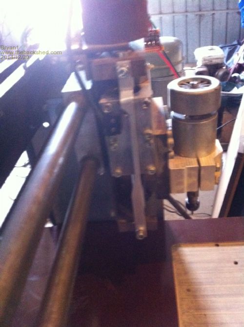

Posted: 11:54pm 29 Dec 2014
G'day Guy's,
Well finally got around to finishing off the limit switch's so now all 3 axis has limits. I decided to go with just using one limit switch and milled up guides for them in my bridgeport mill.
Here is a pic of the Y axis rail where I used some brass angle iron mounted on some thin gauge steel angle.
Same with the Z axis I just some some ali flat bar.

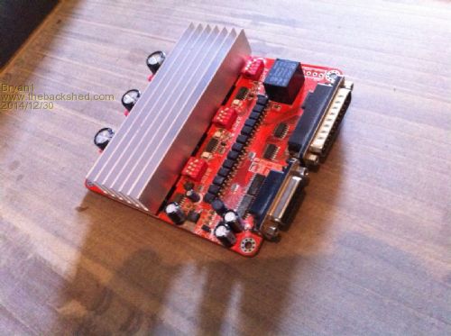

Now with these elcheapo 3 axis controllers there is connector for using joystick and lcd panels etc. That one below the parallel port is the one I mean
I have looked on the net to try and find the pinouts for that connector with no luck so if anyone has the pinout it would be great.

Posted: 01:32am 30 Dec 2014
I think you will find its a DB15 socket so i would think its a standard joy stick plug input, so if you look in the back of a earlier Dick Smith catalogue you will find the pin outs for a joy stick.
Then there is also rather cheap chinese control pads to suit these boards.
It would appear they are a standard pinout to suit many different boards, so is why i suspect it to be a standard DB15 gaming port input config.

you computer locked on sending Gcode ?
how old is it ?
also the controller board you pictured, if cheap means came from china cheap , you may find it has noise issues . ~ locking up , not sending proper continue codes back to PC , losing steps .
Noise as in not enough circuit noise isolation on one or more axis . what you will see is the loss of steps to even controller locking up.
adding filter caps to any DC motors near b and using ferrite chokes at the ends of long leads can help , but some of these boards actually have a 'bug' in their layout design.
the issue is not enough isolation from processing signal to the driver parts.
and this can cause the whole board to pause if bad enough .
see here :
fixing-a-chinese-made-cnc-stepper-motor-driver-board

Thanks for the tip on using the hex inverter chip and I went and had a look at my controller board and found there are 3 of them already on the board. In the pic of the controller those 3 chips infront of the heatsink and beside the red switch's are 74HC14 chips.

+ you may want to see if you can get your hands on some snap on/over ferrite chokes for the parallel cable . especially if it is a longer one between your rig and pc .
I used to sell them when I ran a radio shack. it solved many transient printer issues.
