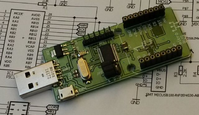

Hi,
The MM28STICK is ready!
Using direct USB communication, the PIC32MX270F256B microcontroller can also be used for MMBasic running. Due to the reduced number of usable pins, it is worth using MikroBUS connector assignment to create a directly plug-in USB board that I named MMSTICK28. Two USB ports are available, one standard and one microUSB connector.
The circuit diagram:
The terminals for the RX and TX terminals of the microBUS connector or the COTX (11) and CORX (12) terminals of the original console or the COM2 port TX (6) and RX (7) can be connected using the JP2 jumper. JP1 connector for updating the microprocessor program.
Here is the production documentation(EAGLE)
2017-06-20_084816_mm28stick.zip
