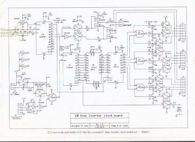

Ok, here is the schematic of the three inverter, 27 step clock board that provides all the required drive signals.
Its all fairly self explanatory except for the mosfet bridge at the top of the circuit. This produces 50 Khz continuous ac power to power all the individual isolated gate drivers through several small 1:1 pulse transformers.
NAND gate U2 generates the drive signals for the zero volt clamps. All data outputs are time coincident coming out of data latch U9, and the 1uS dead time must be provided for in hardware.
Only other thing to note is U4 which is an under voltage sensing chip that holds the main address counter (U7) reset during initial power up and during power down.
Holding U7 reset will turn off all the output devices within the 610nS update period of data output latch U9. When reset is released, the sine wave always starts off from the zero crossing point.
This is to provide orderly safe start up and shut down as the +5v supply voltage initially builds up and finally decays. This aspect is particularly important in any inverter.

From your data I have 2048 address to step through. (I'm assuming 2048 will also work for 4 transformers?)
So I calculated the clock rate needed is 102400 hz.
I selected a 4.096 Mhz crystal and using a 4040 to divide by 40.
I do like how simple the reset is used as a shutdown.
I tend to shy away from pulse transformers since I never really worked them and was intending to use isolated power supplies and opto Fet drivers - I'm guessing my way is more expensive. How much can we get those pulse transformers for? Is there a performance benefit?
I can't read most of the writing on the schematic, any chance you could send me a higher res image.
I really can't thank you enough, I'm really getting into this.

Sorry about the image quality, I had to scan a one year old printed copy and it has not turned out well at all. I will work on that problem.
My crystal is 3.2768 Mhz which is a readily available frequency.
The first counter (U6) divides that down to 102.4 Khz from the Q5 output.
Main counter U7 has ten outputs Q1 to Q11.
Eprom is 27C16 which is 2K x 8 that will need to be 120nS version or faster.
That all provides 50Hz output. to drive three inverters.
The output latch is clocked at 1.638 Mhz sixteen times faster than the data in the Eprom is changed. The reason for that is so a main counter reset turns everything off as fast as possible.
The four inverter version is identical except the two highest data bits are used to drive an extra NAND gate and extra output drivers.
2K of memory gives a very fine 10uS step resolution, which is far more than really required. If you are going to use multiple lookup tables 1K per table would be quite adequate. 2K is the smallest cmos eprom available, so I just decided to use all of it because it was there.
The upper gate drivers for the bridge, and possibly the clamps will each require isolated dc supplies. I used pulse transformers because I already had a lot of them.
Those 1 watt isolated dc/dc power modules would be smaller and cheaper than pulse transformers anyway. I just used up the junk I already had on hand.
Its actually not all that complicated, the only really painful part is calculating the eprom data. Originally I wrote a program in basic to do it all and print it out.
A spread sheet would be another way. A scientific calculator might also work.

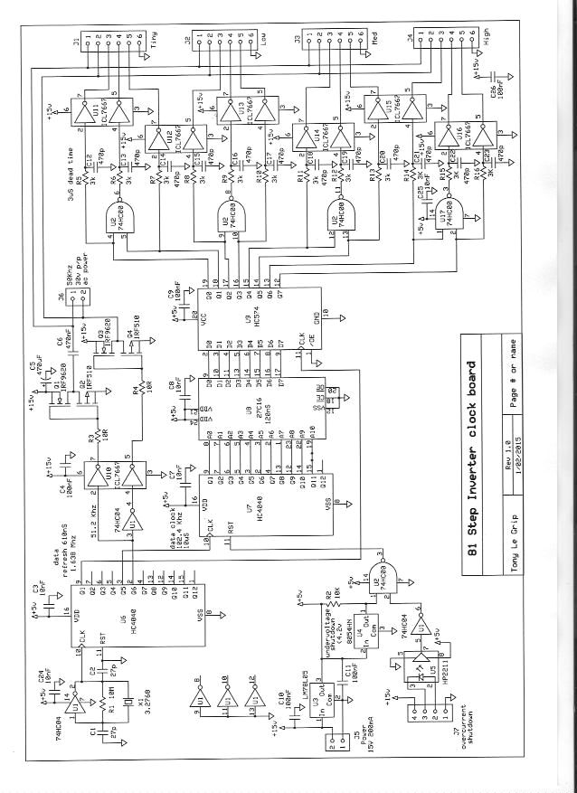

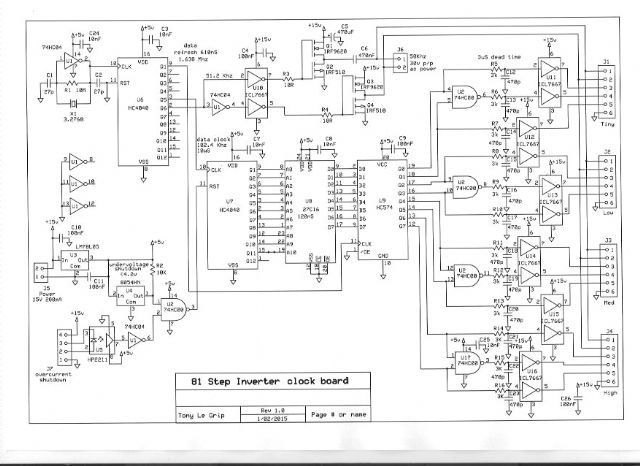

Ok here is the 81 step GT racing version.
Its identical, and the above eprom data will work exactly the same.
Posted: 07:08pm 17 Mar 2017
Lets see if rotating it scrunches it up.
