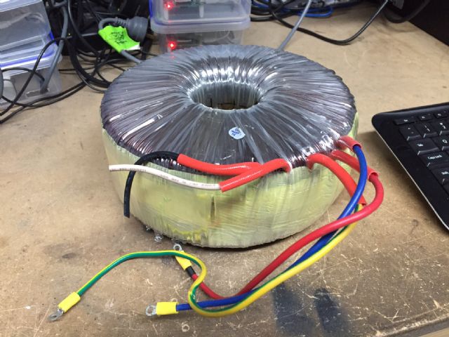

Here is my new spare transformer, ready for the eventual construction of a much more betterer inverter using 35mm2 primary cables, good hardware, better component location, professional looking cabling etc.
oztules
Joined: 26/07/2007
Posts: 1686
Posted: 02:49pm 18 Aug 2017
Well done... you can rewind the tranny, and use the heap of spare 1.6 to wind the primary with.... as per Madness.

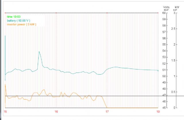

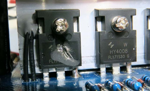

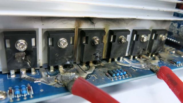

The aliexpress sourced inverter board has blown the mosfets resulting in
little bits of TO-247 packaging here and there.
The system was not under much load at the time of failure.
This shows the inverter input power at about 400W (8 Amps at 50V)
I will examine the board to see if it's still usable.
If so, which mosfets to use?
I need a local equivalent to HY4008 but maybe better in some respects
HY4008 80V 2.9mR 200A Qg 195nC
IRFP2907 75V 4.5mR 209A Qg 410nC

I don't know why, but as Devil's advocate......
As we know, it only needs one mosfet to fail and trigger a total catastrophic failure of the lot, destroying any evidence of the initial cause.
Only two possible causes that I can see, voltage breakdown, or a local temperature melt down from thermal runaway.
Voltage breakdown could either be voltage spikes originating from stray circuit inductance (non ideal physical layout), or random oxide failure from sub standard mosfets that have poor manufacturing quality control.
Temperature meltdown becomes increasingly likely as more mosfets are paralleled and the switching times are not identical or coincident. The first mosfet to turn on, and the last mosfet to turn off in the group can end up having switching losses vastly greater than its parallel neighbours. The more mosfets you parallel up, the greater the potential problem of thermal runaway caused by dynamic unbalance.
The theory suggests that the resistance of a hot running mosfet increases, and so that should cause the current to share more equally. That may be true in a dc circuit. If its a switching loss problem, the hot running mosfet resistance increases which generates even more heat. At some tipping point the hot mosfet goes into thermal runaway and then its all over.
Because we cannot identify the cause, its not really possible to suggest a cure.
If the physical layout looks reasonable, I would first look at the gate drivers and the possibility of using higher voltage rated mosfets of known provenance. That can get rather expensive though, and still may not fix it.
But if your low cost "Dragon Brand" mosfets are failing, nothing you can do to the circuit design or the layout is likely to improve things either.
Probably the first thing to try would be some higher voltage rated mosfets that will unfortunately have a higher on resistance. If that fixes it with no more blow ups at low power, its very likely to be a voltage breakdown related problem.
If that makes it even worse, its more likely to be a dynamic switching problem and the higher on resistance, and greater running temperature makes it even more susceptible to sudden thermal runaway.

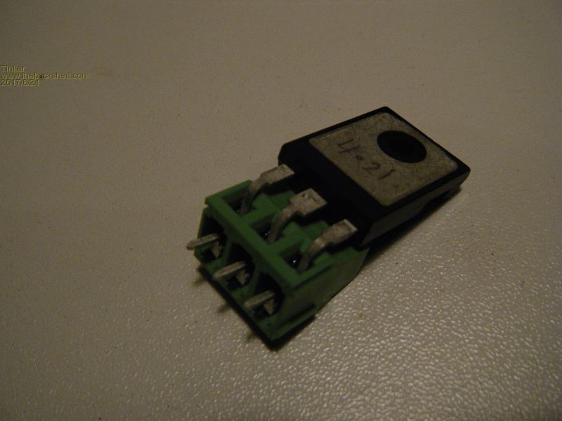

Another key to all this is making a totally indestructible circuit board that enables very fast and easy mosfet replacement without damaging the board by constant resoldering, or blasting tracks off the board. I am working along those lines myself right now.
The basic idea is to use fat busbars bolted to the board (Thank you Klaus!) and also 5mm spaced vertical screw terminal blocks into which TO247 mosfets can be inserted.
I have found some good 3 way screw terminal blocks, Dinkle EK500R series. These are rated at 20 amps but will carry current way beyond the legs that any mosfet will carry.
https://www.dinkle.com/en/terminal/EK500R-XXP
Altronics part number PL2065A and possibly other suppliers that can be found on the internet.
The third very useful item are common flat solder lugs !
These invariably have a big end with a 4mm hole, and the tail with a 1mm hole through which you are supposed to insert and solder a wire.
The trick is to design your circuit board so that the pin on the screw terminal block lines up with the 1mm hole in the solder lug. And the fat end of the solder lug bolts to the busbar with a 3mm or 4mm screw.
You can then lay a solder lug over the copper source and drain tracks, making a neat indestructible current path that greatly increases the current carrying capacity of the circuit board. Its even possible to stack two lugs, or place one on either side of the board. Nothing is going to damage that.
Solder lugs are available in many lengths and profiles, and most are fairly short. The longest ones I could find have 0.6 inch hole centres.
http://www.ebay.com.au/itm/200pcs-60-2814-51-0030-OSTERRATH-Solder-lug-terminal-0-3mm-M4-%C3%83-4-3mm/263011080994?ssPag eName=STRK%3AMEBIDX%3AIT&_trksid=p2060353.m2749.l2649
Something like this should be able to stand up to any catastrophic failure, and replacing a mosfet then becomes as fast and easy as replacing a fuse.

thanks again for your thoughts, Warpspeed. I think failure was due to extended periods of over spec gate voltages (originating from dv/dt), Vds exceeded etc.
The heatsinks never got hotter than about 45 C. Continuous loads were less than 1500VA peak. 95% of the time loads were 500VA or less.
I have pulled the board out and see 9 of 12 mosfets continuous from gate to source (stuffed, Royally). The board looks fine thanks to on-board 105 Amp fusing which has blown.
After this I now get down on my knees and genuflect to the efficacy of fuses. They saved the board.
Tony, the Altronic part you quoted above is only rated at 10 A.
But you don't need a right angle version if you do this:
Part # for a 3 way is PL2035A and is rated at 20A, its cheaper too .
Regarding the solder lug idea, I just held a magnet to my collection of them and, no surprise, quite a few stuck to it. Tinned steel is not particularly conductive so adding those might improve current capacity less than expected. However, the two packs of lugs I got from RS components did not attach to the magnet, meaning they might be tinned brass. Still not as good as tinned copper though.

Hi Klaus, just checked out the Altronics catalogue.
You are quite right, according to them, the vertical P2065A is only ten amps.
But the Dinkle data sheet for that part says 20 amps the same as the horizontal P2045A version, so I think Altronics misprinted the current rating in their catalogue.
They are both pretty much the same thing, the pins on both are pretty massive, and the whole thing looks mighty tough.
The vertical is $1.40 the horizontal $1.30 so not much difference there.
Either type will work, it mainly depends which way you prefer the screws to point.
My PCB is vertical, my screws are vertical, and the mosfets horizontal with straight unbent legs.
Your layout would be perfect for a horizontal board, with both the screws and the mosfets vertical. That is probably the most popular arrangement anyway.
Solder lugs are commonly 0.3mm thick, much thicker than the copper traces on the board, so even if they are steel, the current carrying capacity is still greatly increased.
Its also possible to directly stack two lugs on top of each other to increase the current rating far beyond what would completely blow out the legs on a mosfet.
The big advantage of this is that its cheap and easy, and it looks quite neat when done.
I just checked those extra long 0.6" centre to centre lugs I mentioned earlier, they are non magnetic. If using bolted busbars, the busbars or at least the screw heads will need to clear the fairly wide footprint of the screw terminal block. Most lugs may be a bit short to do that easily.

Ok, after the failure of the aliexpress board after 2 weeks I thought I'd give another board a go. I did not have any HY4008's hanging around. AND I had stuffed up the first board with inexpert desoldering and hacking.
So the new board was installed and it lasted....
(I'm taking bets here...anyone?)
Less than a day. Under the same condition as the previous board which lasted 2 weeks.
Awesome. AND my wife got to experience the wonder which is "magic smoke" too.
Let's enjoy the carnage.

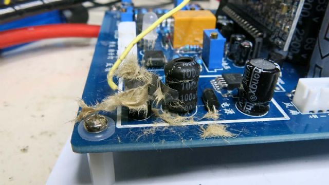

Both high and low side fets all blown to the sh*thouse. Load was 1000W DC input.
This has 3 x HY4008 fets per leg. Good for "5000W" Chinese watts.
the little 12V buck converter output cap seems to have had a Very Bad Day.
..which I suspect means Uuuuge volts have been fed back into the control section.
Likely the EGS002 board is no longer part of this world. And the comparitor ICs.
Finally here is the answer to "What's inside a HY4008?"

Oh dear, Poida, you seem to have joined the club I'm a long time member of. Yes, been there, done that, blowing up HY4008's, and your last picture is very familiar.
People hoard their precious 4008's for that reason hence no take up of your plea for some.
Mine blew on my own designs though... I suspect these mosfets require a *massive* heat extraction area and, being that close to the edge of the heat sink does not help. Neither does having to place them on insulating washers.
With regard to the power jack, my 8KW version has been powering my house for about 2 years with no problems.
I bought just the power & control module, wound my own toroid & choke as per the early building your own inverter threads here. I think PJ no longer sells the modules separately - but could be wrong.
It might be wise to read through these early PJ threads to avoid more disappointments.
