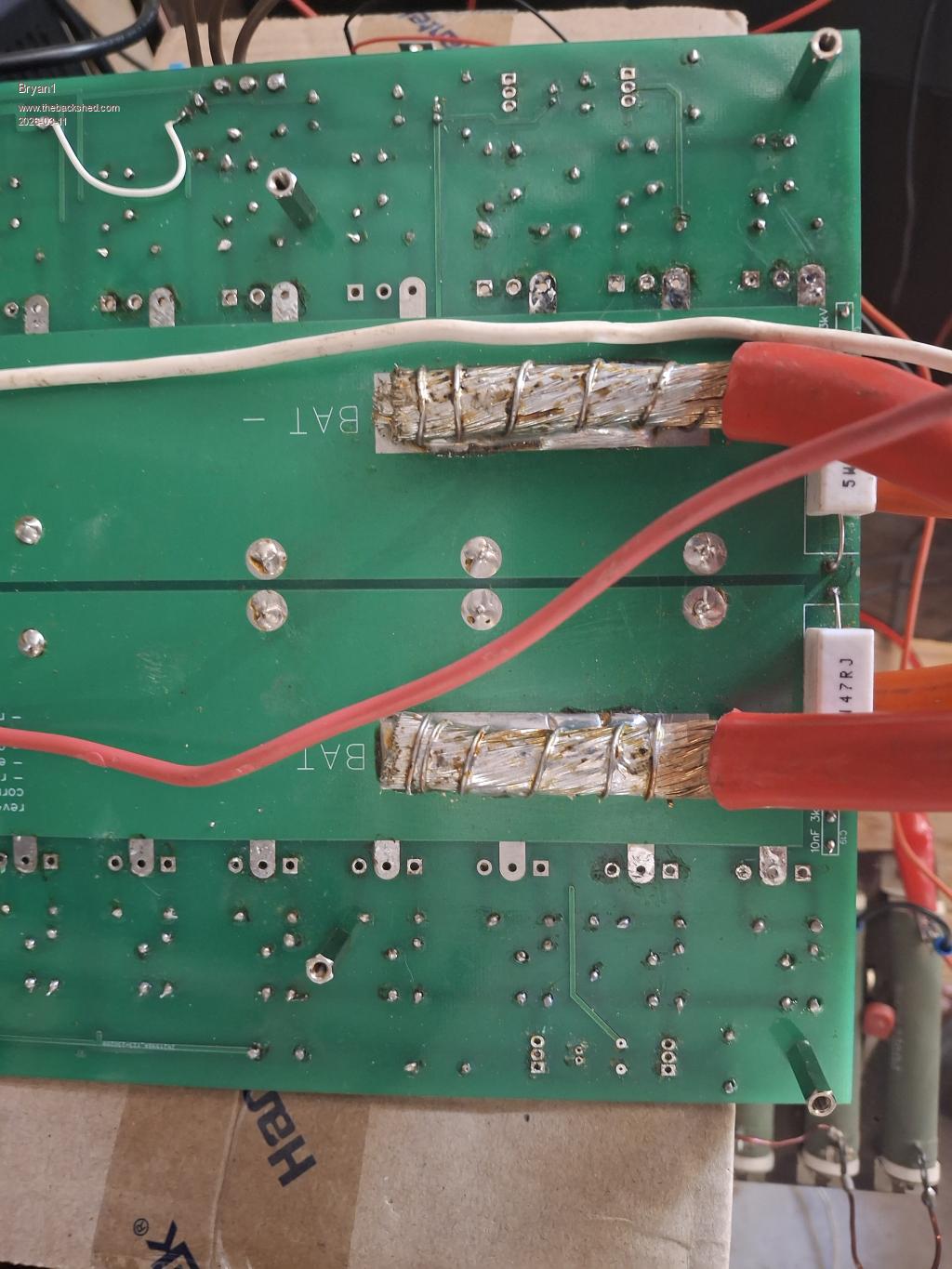

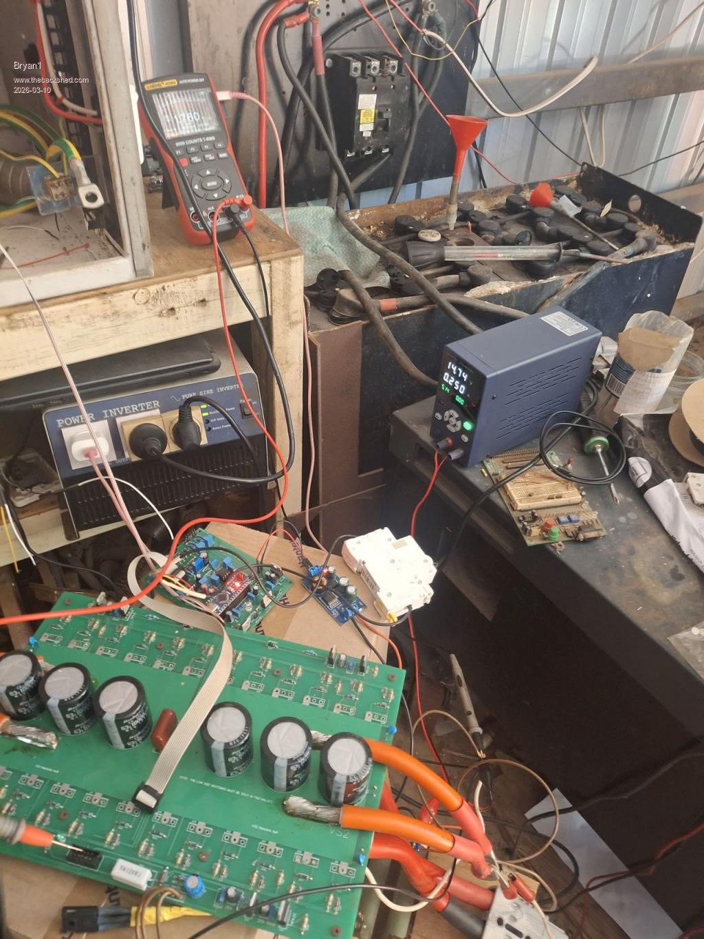

Ok with step 2. VS1 and VS2 tied to ground ribbon cable removed 24 volts and 320mA input turned on voltage on psu dropped to 20.34 volts and current draw 340mA.
TIP31 1.5 1.9 900mA
Measured the Vbat pins on the 10 pin connector 1.7 volts.
So there is something blown me thinks
Edit:
Tried again lowering the current to 250mA and the pictures shows the result
Edited 2026-03-10 09:07 by Bryan1

Ok removed the VS1 and VS2 to gnd wires and the current dropped to 51mA connect Gnd to VS2 and the short happens. Remove short the led comes on and....
TIP31 17.93  VBat  17.5
D25 17.41
D26 17.44  17.72
18V zener 17.93
Edit: that was interesting powered it up and decided to measure the voltage on pin 1 of the TIP 41 and TIP 42 chips.
On VS1 and VS high side 17 volts
On VS1 and VS2 low side no voltage.
Edited 2026-03-10 09:39 by Bryan1

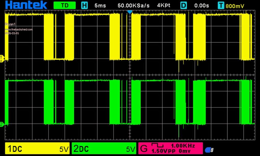

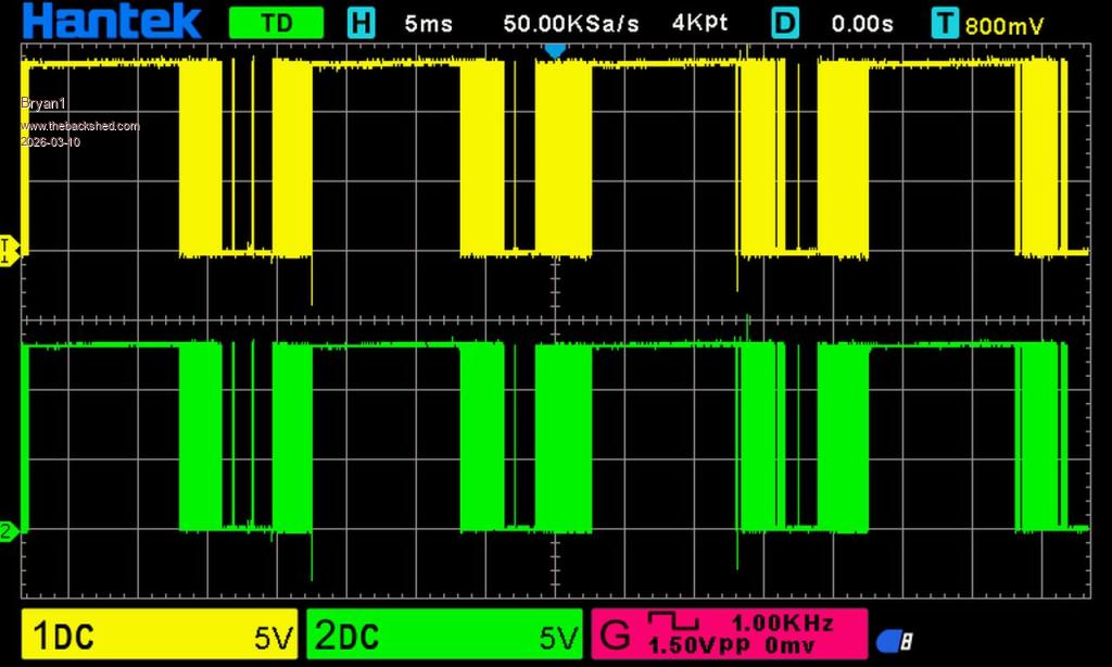

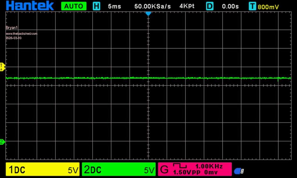

Posted: 12:14am 10 Mar 2026
Ok the following scope pic's are WITHOUT VS1 and VS2 tied to ground
6. CH1 to R1
  CH2 to D1
7. CH1 to R26
  CH2 to D7
8. and 9.
CH1 R27
CH2 D18
so no action from the high side
tinyt
Joined: 12/11/2017
Posts: 564
Posted: 12:30am 10 Mar 2026
Looks like picoverter H01 and H02  signals are missing. So in the picoverter board, replace the two IR2184 chips and do steps 8 and 9 again.
Edit: I think the TIPs high side are shorted. are they newly replaced? If not replace them first before replacing the IR2184 as the shorted TIPs can blow the IR2184s.
Edited 2026-03-10 10:39 by tinyt

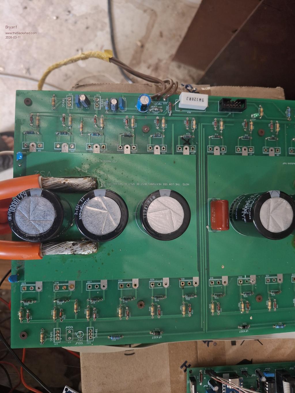

Bryan1
Joined: 22/02/2006
Posts: 2297
Posted: 01:39am 11 Mar 2026
Ok got the linux box going now here are the pic's of VS2 on the board.
Top Side
Bottom Side
tinyt
Joined: 12/11/2017
Posts: 564
Posted: 01:55am 11 Mar 2026
Board is almost bare, and still we have a problem.
Still with no power compare resistance readings across the pads of C8 and C5.
Bryan1
Joined: 22/02/2006
Posts: 2297
Posted: 02:00am 11 Mar 2026
C5 measured no measurement where C8 is a dead short, measured the 10K resistor which did prove to be 10K so left it in.
No probing using VBat - with one probe does NOT make contact around the C8 area with the other probe.
Checked VS with the VBat connections underneath and no contact so no shorts there.
Edited 2026-03-11 12:14 by Bryan1

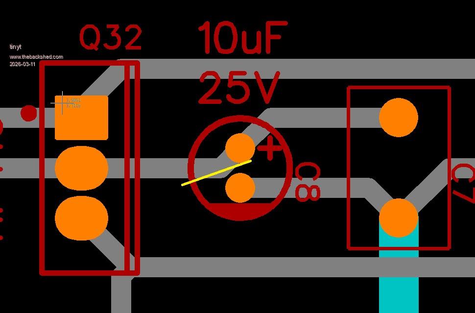

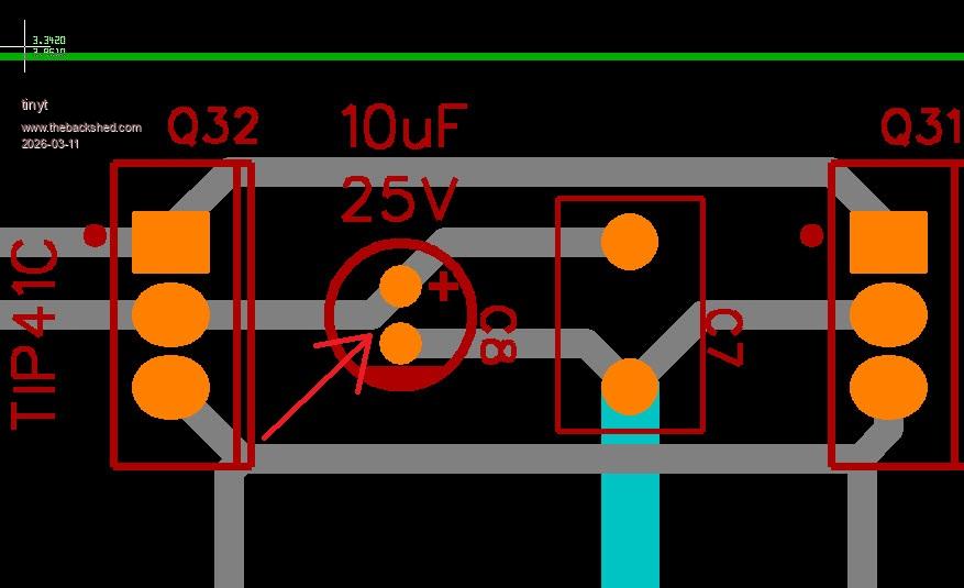

tinyt
Joined: 12/11/2017
Posts: 564
Posted: 02:04am 11 Mar 2026
Use a magnifier and check for copper trace short between the pads of C8.
See red Arrow
Edited 2026-03-11 12:09 by tinyt
Bryan1
Joined: 22/02/2006
Posts: 2297
Posted: 02:22am 11 Mar 2026
Ok got a sharp knife and ran between the track and pad and the exposed copper does show the dead short. I also had a look with my 45X magnifier which does confirm the short.
So I am thinking cut the track from the TIP 41C to the cap and make the connection under the board using the cap legs to make the new circuit path.
Edited 2026-03-11 12:25 by Bryan1
tinyt
Joined: 12/11/2017
Posts: 564
Posted: 02:33am 11 Mar 2026
  Bryan1 said  Ok got a sharp knife and ran between the track and pad and the exposed copper does show the dead short. I also had a look with my 45X magnifier which does confirm the short.
I would just cut a little bit of the shorting copper.
See yellow below, You can paint the exposed copper with a little bit of nail polish or something similar.
Edited 2026-03-11 12:36 by tinyt
