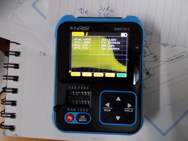

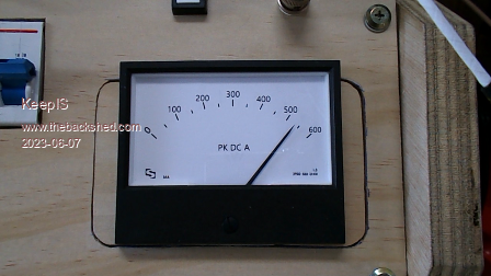

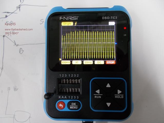

For anyone considering one of the small DSO units I linked to, I carried out a series of tests with various loads, it has no problem capturing the waveform startup and showing the correct values and the captured screen has very good detail.
This has the Display of the Dust Extractor.
BTW This DE is mounted in a 3m high external enclosure.
The value display is toggled off to show the screen display clearly.
Below:
The Meter showing the Compressor startup of 560A -  Pretty darn close.
Note the startup current can vary from around 560A to 587A with temperature, load pressure and other factors.
Edited 2023-06-07 11:30 by KeepIS

KeepIS
Joined: 13/10/2014
Posts: 2289
Posted: 04:50am 07 Jun 2023
Thanks Pete for the info, up until now I've been using mine mainly for the auto identification of components, just stick a FET or Transistor in holder any which way and have it tell me what it basically is, and give me the correct Pin out connections.
Saved me so much time going through boxes of old components.

Posted: 09:16am 07 Jun 2023
Hi Klaus,
Most of these things turn out to be semi-useful but this surprised me, and running on a battery with good life is also a plus.
The only thing to be careful with is this:
The input range on lower sensitivity, like 20mv, 40mv, 100mv per division can catch you out when using DC coupling and moving the vertical display position cursor to the bottom of the screen, which is what I do when reading from a sensor that has only positive displacement output from zero.
The input appears to be designed for typical sinewave input shown as +- around center, cursor at center of the screen. It appears that the input amps overload and peak clip if you try to show a signal that is a full screen positive going waveform starting from the bottom of the screen.
On higher settings like 500mv per division, which should be used for the Sensor I have anyway, the head room is fine if the Cursor is moved to the Base line. No clipping on full screen and the correct voltages are displayed.
Hope that makes sense.

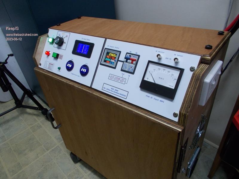

Posted: 09:05am 11 Jun 2023

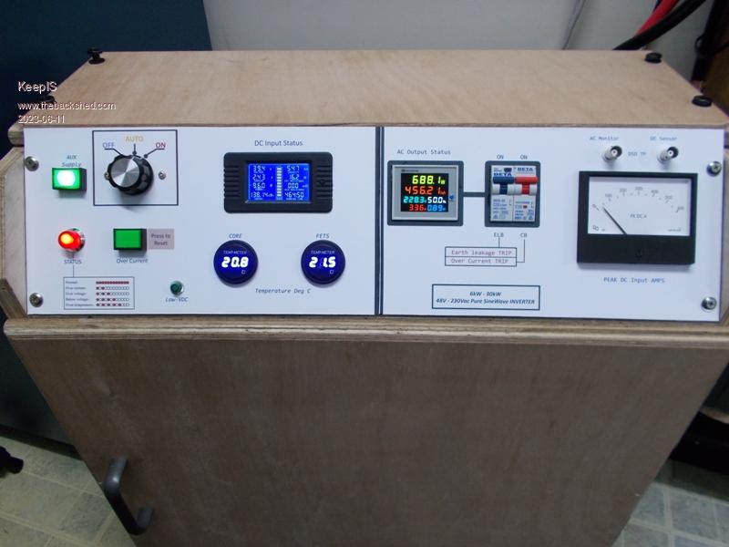

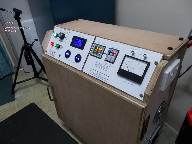

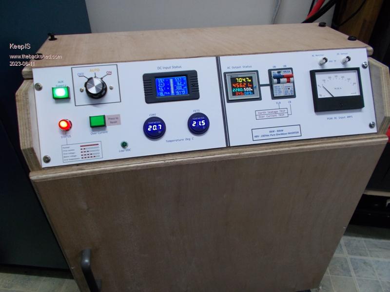

The Beast tarted up
Murphy's friend
Joined: 04/10/2019
Posts: 678
Posted: 02:46pm 11 Jun 2023
Very pretty Mike, what is the display panel made of?
Did you varnish the plywood case or is that not on the list?
KeepIS
Joined: 13/10/2014
Posts: 2289
Posted: 10:45pm 11 Jun 2023

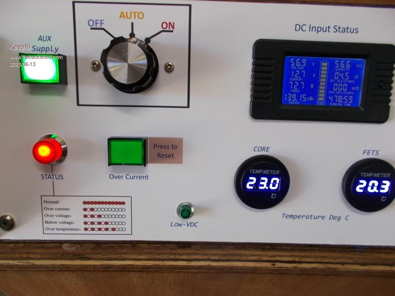

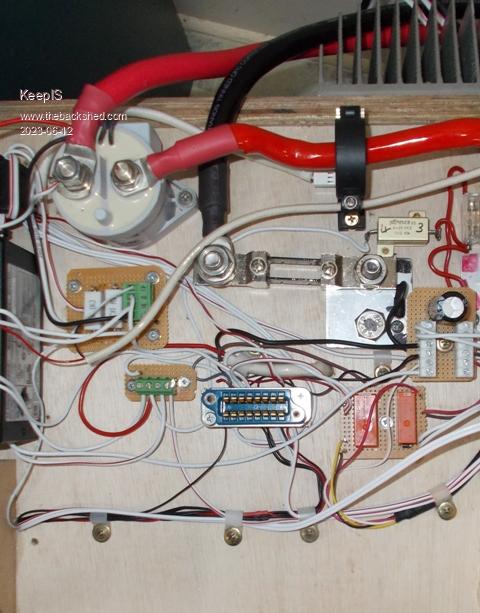

Thanks Klaus,
The case is about to have its varnish or oil, hopefully I'll finish that today.

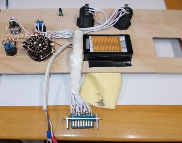

The Display panel finish is Photo paper, I scan the very wide base front panel in two scans, two by A4 sheets wide.
Spend a day in Photo shop and design the front panel, Obviously everything must scale and print exactly, which it does.
The Printout on Photo paper is then given 3 coats of acrylic Clear.
I've been doing this for over 20 years on my projects, still have 3 pieces of gear done like that and they are as good as the day I made them. Turns out to be a pretty tough finish.
Notice the LED status codes on the bottom LH side for the eg8010 codes
BTW:
The front panel is wired up on the workbench, I made it a plug in Unit. Four screws, unplug the front panel, and take over to the workbench for any changes.
Edited 2023-06-12 16:09 by KeepIS

Coat of Danish Oil.

Posted: 10:49am 12 Jun 2023
Now that looks like a proper job Mike,  always nice to see other's ideas when building these things,  was the printing done with colour Laser or Inkjet? I mostly have trouble with Ink fading but its mostly out doors.

Posted: 10:47pm 12 Jun 2023
  Revlac said  was the printing done with colour Laser or Inkjet? I mostly have trouble with Ink fading but its mostly out doors.
Thanks Aaron,
Just a colour Inkjet, the 20 year old units have not faded, but used mostly indoors.
The good quality clear coats seem to be really tough, I follow up the initial 3 coats with another few coats once the Photo sheets are glued to the base front panel.
Thing is they cost me virtually nothing to make, not much ink and the glue I use allow the sheets to be peeled off, So easy to print another and replace it.
