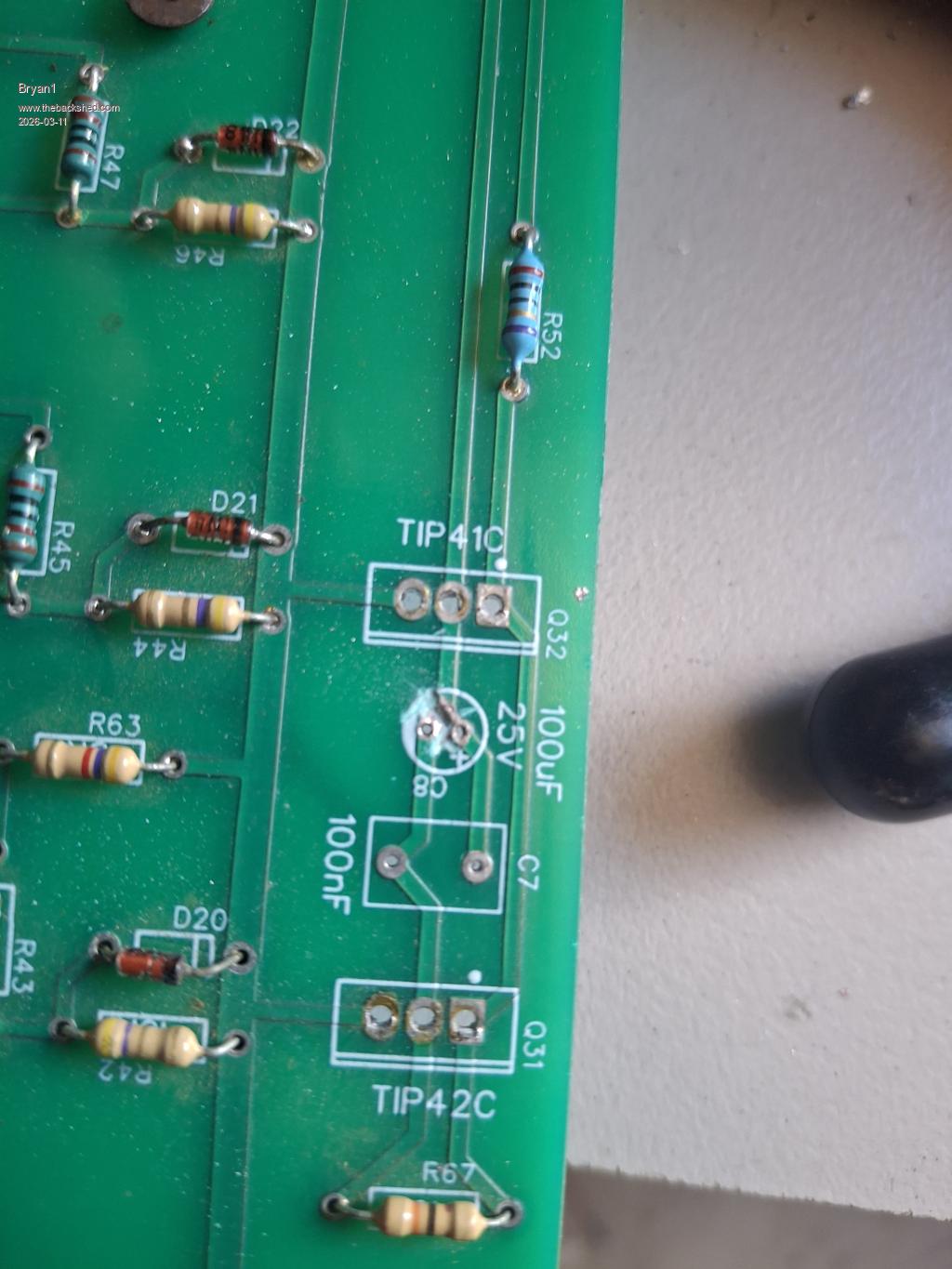

I am not a QC guy but it seems that on most components, solder did not wick the component pins to the top side of the PCB.
I would touch them up with solder again to avoid future problems. Maybe let the tip of the soldering iron heat the joint a little bit longer but just enough so solder will flow better.
Also, to be safe, do the 10 steps in my earlier post.

Ok took your advise Tinyt and soldered in from the top side to ensure every component connected, now I have soldered the caps back in and tied VS1 and VS2 to Gnd turned the unit on and after the caps had charged the idle current was 59mA
So I do think it's safe to say I can now solder in the new TIP41 and TIP42 chips back in so I can do all those tests again.

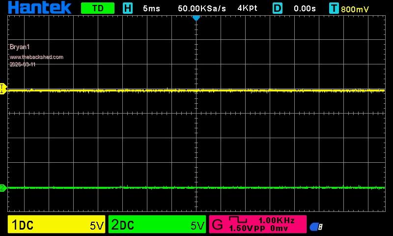

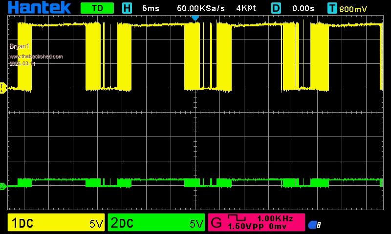

Ok here is the first scope pic
VS1 and VS2 tied to ground
Ch1 to D1 VS1 low
Ch2 to D7 VS2 low
Next scope test
Edited 2026-03-11 15:51 by Bryan1

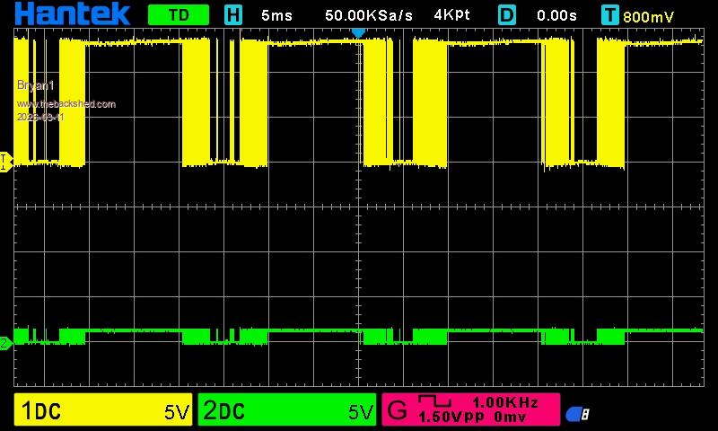

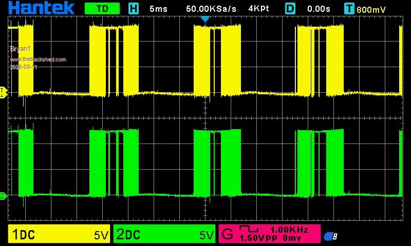

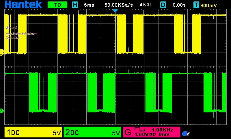

Test 6. CH1 to R1 Ch2 to D1
Test 7. CH1 to R26 CH2 to D7
Test 8. CH1 to R27 CH2 to D18
Test 9. CH1 to R52 CH2 to D19
So still got a problem there somewhere

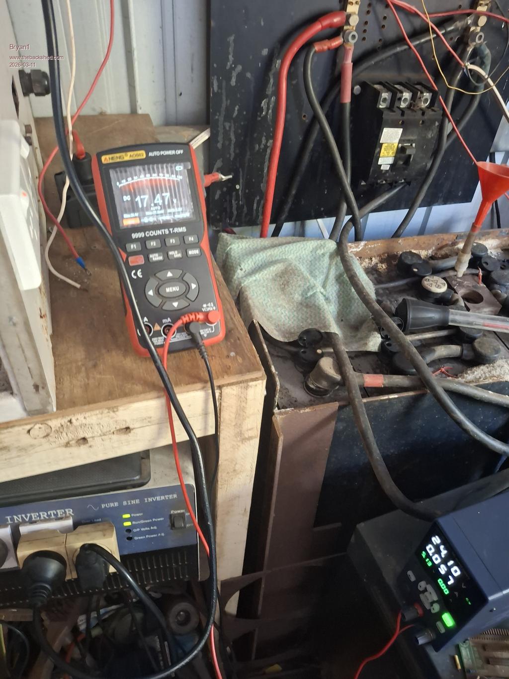

Ok this is plain weird

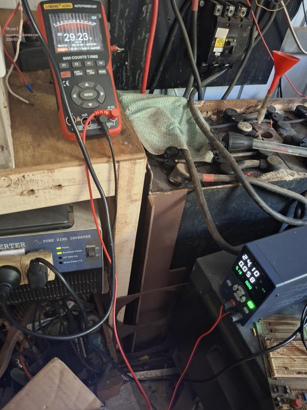

D26 anode voltage measurement
D26 Cathode voltage measurement
They do say a picture says a 1,000 words like If I said D26 anode was 30 volts from a 24 volt supply some question may of been raised.
Posts: 3417
Posted: 07:54am 11 Mar 2026
I don't have the circuit diagram so just guessing.
The high-side MOSFET gates need to be higher than the V+ rail so perhaps D26 is part of a high-side bootstrap circuit that provides the boosted voltage.

  Bryan1 said  Ok here is the first scope pic
Ch1 to D1 VS1 low
Ch2 to D7 VS2 low
Next scope test
Both signals look good.

  Bryan1 said  Test 6. CH1 to R1 Ch2 to D1
Test 6. What happened here? Peak to peak for D1 shows about 1.3 volts while previous post shows peak to peak of 13 volts.
Test 7. What happened here? Peak to peak for D7 shows about 1.3 volts while previous post shows peak to peak of 13 volts.
Any setup changed from the previous post?
Edited 2026-03-11 23:01 by tinyt
tinyt
Joined: 12/11/2017
Posts: 564
Posted: 01:08pm 11 Mar 2026
H01 signal from picoverter missing, hopefully just loose connection in the ribbon cable or mating sockets. With power off, ohm out H01 signal from picoverter to power board R27
Footnote added 2026-03-11 23:14 by tinyt
Do not disconnect ribbon cable, leave it as is until you have ohm'ed out the H01 signal. If you disconnect prior, the problem might disappear.
tinyt
Joined: 12/11/2017
Posts: 564
Posted: 01:11pm 11 Mar 2026
This looks good.

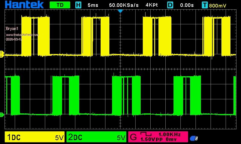

Bryan1
Joined: 22/02/2006
Posts: 2297
Posted: 11:59pm 11 Mar 2026
Morning Guy's well with those scope pic's yesterday got egg on my face   as the earth lead for the scope wasn't connected.
So this morning used the scope and found L01, L02 and H02 all showed the correct waveforms but H01 is still offline.
Now trying to ohm the pin for H02 on the 10 pin connector on the power board to the 20 ohm resistor(R27) is in the kilo ohm range. Now as this pin does have it's track on the top layer I'm sure my soldering isn't going all the way up.
Also checking the IR2184 to R27 was open circuit so changed the chip and found it was in the kilo ohm range not open circuit, now with with L01, L02 and H02 the ohm check was in the low ohm range.
OK I may of found a fix   soldered in a jumper wire from the H01 pin on the 10 pin connector to the base of R27 so it now a solid connection.
Time to test this hack out
Edited 2026-03-12 10:18 by Bryan1
Bryan1
Joined: 22/02/2006
Posts: 2297
Posted: 12:42am 12 Mar 2026

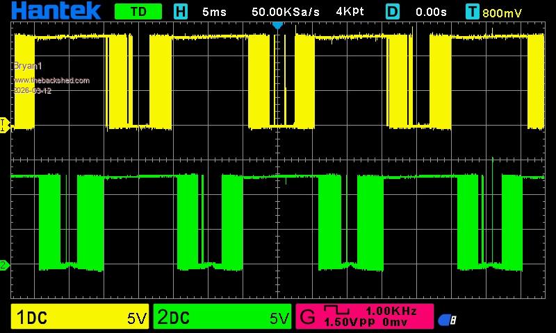

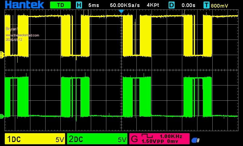

Ok scope pic's
Ch1 L01
CH2 L02
Ch1 L01
Ch2 H01
Ch1 L02
Ch2 H02
Ch1 H01
Ch2 H02
So I do think it's time to add a mosfet to each leg and see if this energy meter works
