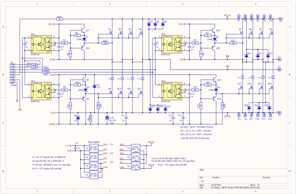

A lot has happened with the inverter, we had a failure staring a big load, however there was no visible damage to anything except for D16, one of the MUR420 Diodes.
Wiseguy designed the Power board for 5kW continuous and peaks of 10kW:
I have peaks starting currents above that and when you have a few workshop induction motors running, and then start another peice of equipment that causes the over current trip just has the new load is spinning up, well I would not like to see the sort of collapsing fields and back EMF that would have been presented to the Toriod from those induction motors spinning down.
As Mike [Wiseguy] pointed out concerning D16 failure:
"The MUR420 diodes were there to save some heating of the FETs internal diodes, at the time the FETs were going to be HY4008, however I am using HY5608s.
The HY5608s essentially run cold but with high currents their increasing forward voltage drop which can be as high as 1.3V @ 180A would then force excess current through the MUR420s which I think is what killed D16.
There is no data I could find about the peak HY5608s forward current but it is stated as 360A continuous, a slight upgrade from the 4A & 110A absolute peak of the MUR420.
The HY5608 FETs forward current is also 360A continuous and ~ 1290A peak, I would expect the peak diode current to be at least ~ 1000A"
The Diode spilled it's guts and blackened 20mm area under and around the Diode, a quick rub with PCB cleaner and the PCB was like new.
The FETs were physically as new, however that diode would be a dead short to the upper FETs and two on the upper and two of the lower FETs on one side were shorted.
It took all of 20 minutes to have it repaired and bench tested:

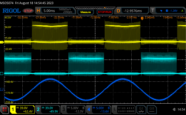

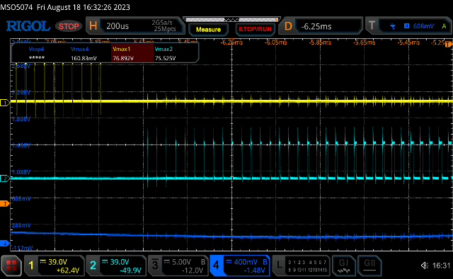

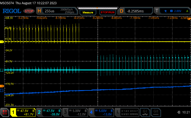

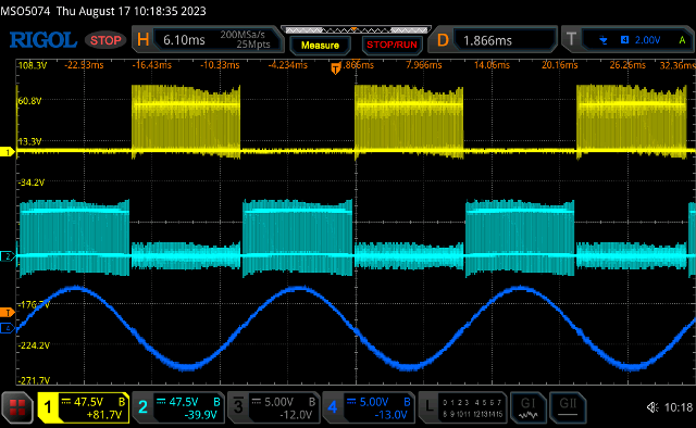

A question I have is regarding the long period of ZERO PWM between the HI and LO side PWM.
Some of the noise is due to DSO Probes connections.
Here is the output from T3 and T4, both referenced to T2 which is 48V B-.
Blue is AC out.
Now here is the PWM zoomed in:
There is around 230uS between the last PWM pulse on the upper side and the start of the first PWM pulse on the lower.

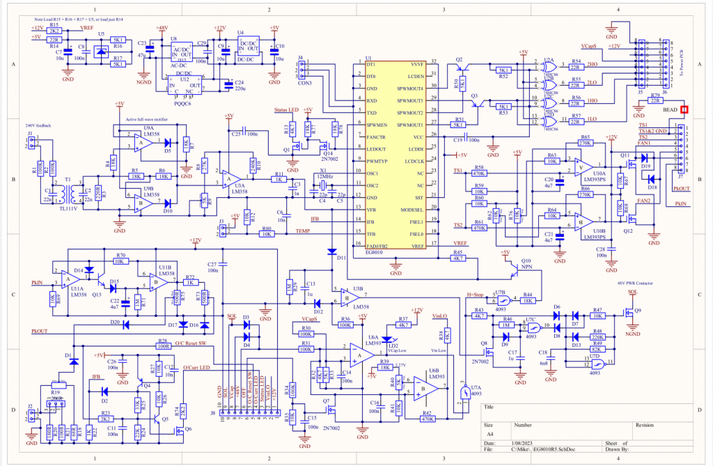

FYI The New Test controller circuit.

In the mean time, I'm also testing out the new controller board and circuit, as Wiseguy is not in a position to build or test the new board and circuit ATM, so I'm having all the fun?
So I'm not really asking for a solution or worrying about the inverter failing again for a different reason. The underrated Diodes have been removed, and if we come up with something that has a higher rating then the diode in the HY5608 then I may fit a few.
The real question I have is around that 230uS long dead zone between HI and LO switching transitions?
I feel something is slightly off but I'm second guessing myself, going back through old recorded DSO and Analogue Storage scope display frames to see if anything obvious  stands out.
In the mean time I'm just posting the DSO frames to see if anyone can shed some light, keeping in mind that this is not a standard 8010 modulation scheme.

wiseguy
Joined: 21/06/2018
Posts: 1338
Posted: 10:32am 17 Aug 2023
  KeepIS said  Thanks for the suggestions,
This may not use the intended 8010 modulation scheme but the HF PWM pulses it outputs are from the same internal source.
It took a while to find but I was sure that TinyT and myself had similar posts about EG8010 waveforms. I found TinyT's post first Here (Jun 2018!! ) and you can see the absence of pulses when finishing one 180 degrees half cycle and beginning the next 180 degrees a pulse absence of a bit more than 200uSecs.  In case the link is flawed it is the top picture on page 10 of the thread.
So it is inherent behaviour and not a fault you are looking for, the energy content at the zero crossings - for a resistive load - is essentially zero so there is a very minor distortion component just near the zero cross of no consequence, the 50Hz sinewave looks fine on the CRO.

KeepIS
Joined: 13/10/2014
Posts: 2289
Posted: 10:44pm 17 Aug 2023
Mike, thank you for that link. I vaguely remember reading that thread, but just so much to go through in between the ongoing Bathroom Reno and cleaning up the mess I'm making, I hate pulling out plaster board and tiles, the mini Skip is nearly full.
I did find an old screen grab from the previous China Inverter and it "appeared" to be there as well.
This is great, it was the last thing I wanted to confirm before diving in and rebuilding the AC filter and then finalizing the Current trip points for AC current and Peak DC inputs, and getting the Toriod Dual Fan trip points set up.

Posted: 10:15am 18 Aug 2023

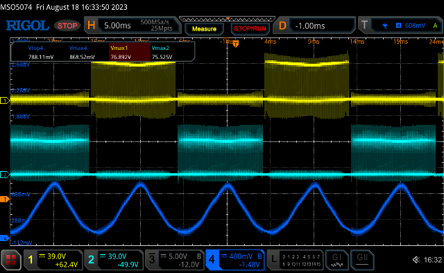

I improved the Probe connections to the Power Board outputs from T3 and T4, as before both are referenced to T2 which is 48V B-.
I also added one more 10,000uF to each CAP board for a total of 40,000uF across the two boards. Adding the extra CAPS made an improvement to Peak DC input current waveforms and PWM ringing.
Blue is AC out.
Blue is Peak DC input Current of 100A and AC load of 2.2kW
220us HI / LO switching point.
It may not be apparent from these DSO captures but the overall waveform noise and ringing is noticeably improved, especially the duration of leading and trailing  ringing under varying load conditions. So I'll keep it at this CAP value for now.

Did the controller over-current protection trip when the MUR420 diode died?
After repair with the diodes removed, did you try the same loads again?
It's a bit surprising that 2.2kW would cause that much distortion in the AC output waveform.  Was the load purely resistive?

  analog8484 said  Did the controller over-current protection trip when the MUR420 diode died?
I don't know if it current tripped as the DC input Contactor dropped out.
It has started those loads 4 to 5 times a day and almost every day since the Inverter was first built, and Yes, it starts them again now.
If you look at the heading above the Screen Grab - the Blue trace is the DC input Current sensor, Not the AC output as in the Screen grab above it.

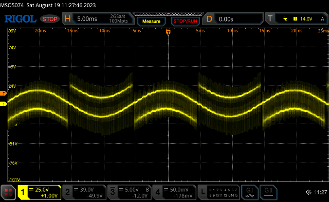

KeepIS
Joined: 13/10/2014
Posts: 2289
Posted: 01:45am 19 Aug 2023
  nickskethisniks said  Since you have a diff probe you can now probe on the most interesting spots. I think you might find it interesting to probe the voltage over the inductors.

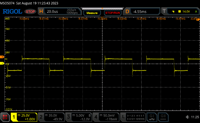

For what it's worth, a quick look across each Choke, the waveforms are identical across both chokes so I'll only show one, 2nd zoomed in.
25V per division, apology for incorrect LH scale offset.
Edit: It's a bit hard to see every second division for some reason, but there are 8 vertical divisions.
Edited 2023-08-19 13:12 by KeepIS

Using a HIOKI 3197 Power Quality Analyzer, I found the THD was less with just the RF filter, this consists of two FT140-43 Ferrite toriods with 3 turns of heavy stranded insulated cable on each toriod, a 0.1μF and a 0.001μF across the output and that's it.
Again this is less then with a conventional AC filter, I have quite a few I have tested over the past year or two.
The noise in the RF gear was virtually eliminated. The THD was around 2% running the Household and workshop load. It was 3.8% with the AC filter, I don't think the Toriod likes seeing it there.
I mounted the HF filter in the TOP deck of this inverter where the Inverter AC output connection sits. It's kept a long away form the Toriod and Chokes and Power board wiring.
The bottom Deck houses the Toriod and Chokes, I fitted a single heavy wound commercial AC filter Toriod and removed the 1μF cap from the board that was originally across the Toriod output and replaced it with a 0.01.
I decided that the Inverter didn't need to see anymore capacitance so close to the Toriod transformer. The rest of the filter was removed from the board.
So a very simple setup that had minimum resistive insertions loss, and the results.
THD is the same as the Mains AC @ around 2% with the familiar flat top AC waveform that is a product of Household white goods that are mostly Inverter driven, and a lot of SMPS wall plugs devices.
The Mains AC waveform has exactly the same flattop as shown in many recent Inverter builds.
However the Inverter is down to 1% or LESS on a decent resistive load that helps swamp the other garbage, that is half the Mains 2.2% THD for the same load.
The Inverter by itself is around 1.3% unloaded and 0.8% THD with a resistive 1kW or greater load.
There is virtually nothing left of the PWM on the AC output, even fully magnified, it's basically a clean sinewave.
Very Happy to have got that all cleaned up and finally finished.
