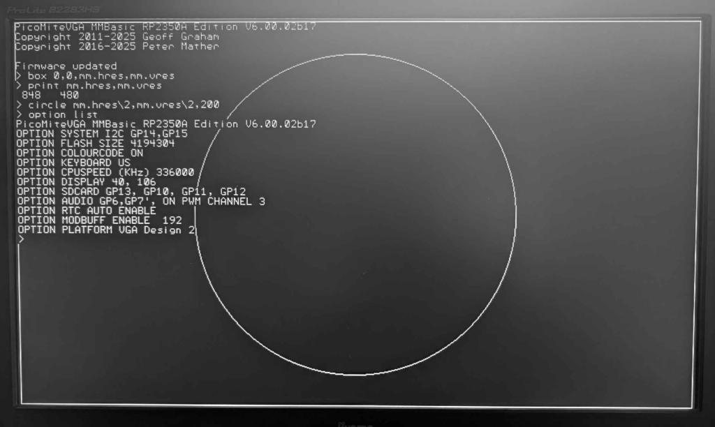

Posts: 12176
Posted: 07:24pm 10 Mar 2025
I've updated the betas for HDMI and RP2350 VGA to b18
These now all support 848x480 widescreen - same as mode 10 on the CMM2
To use the new resolution on HDMI use:
OPTION RESOLUTION 848
Valid modes are:
1: 848 x 480 x 1bit with tiles
2: 424 x 240 x 4-bit with 1 layer buffer
3: 848 x 480 x 4-bit
5: 424 x 240 x 8-bit RGB332
On VGA use:
OPTION WIDESCREEN ON/OFF
Valid modes are:
I assume only a proper widescreen monitor will show these correctly. CPU speed is 336MHz for both VGA and HDMI
Edited 2025-03-11 05:25 by matherp

Regarding the new widescreen modes: Nice feature!
